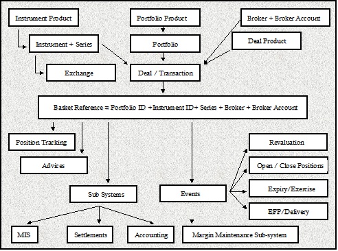

2.4 Illustration of the ETD Workflow
The data diagram given below adequately illustrates the work-flow
of the ETD module:
