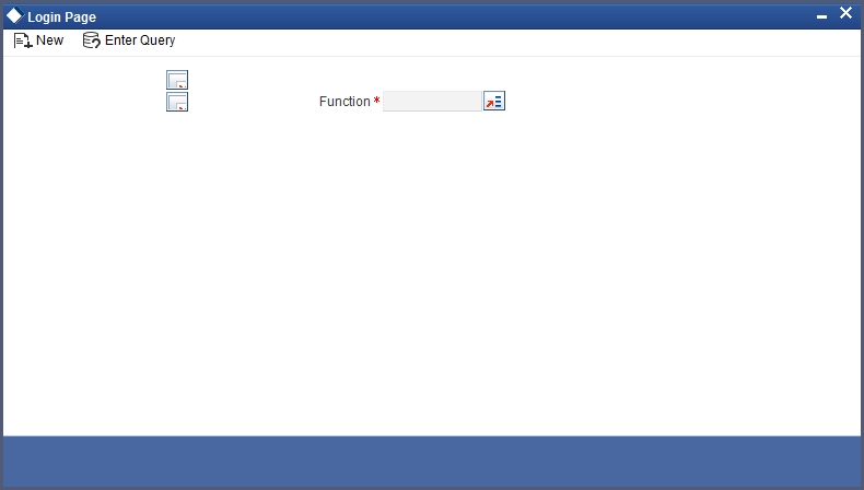

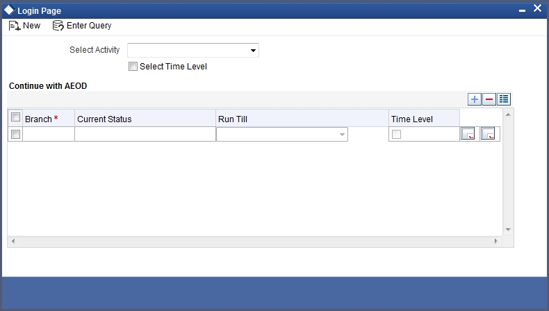

9.1.1 Invoking the End of Day Batch Start Screen
The ETD batch process is a POST-EOTI batch function. The batch can be run anytime, after marking EOTI and before marking EOFI. As part of End of Day (EOD) process for ETD, the system does an automatic deal settlement in the order in which the deals have been booked during the day.
All deals within a basket are processed in the order of Value Date + Time Stamp of deal. Notional Revaluation done during previous EOD will be reversed before processing for the day begins. If there is a back dated deal, all the events in the basket after the back valued timestamp will be reversed during EOD and all deals booked after that back valued timestamp will be processed again.
To run the Batch process, use the ‘End of Day Batch Start’ screen. You can invoke this screen by typing ‘AEDEODST’ in the field at the top right corner of the Application tool bar and clicking on the adjoining arrow button.
Thereafter, click ‘Ok’ button, to start the batch process at the EOD.
To exit the screen without running the batch click ‘Exit’ or ‘Cancel’ button.

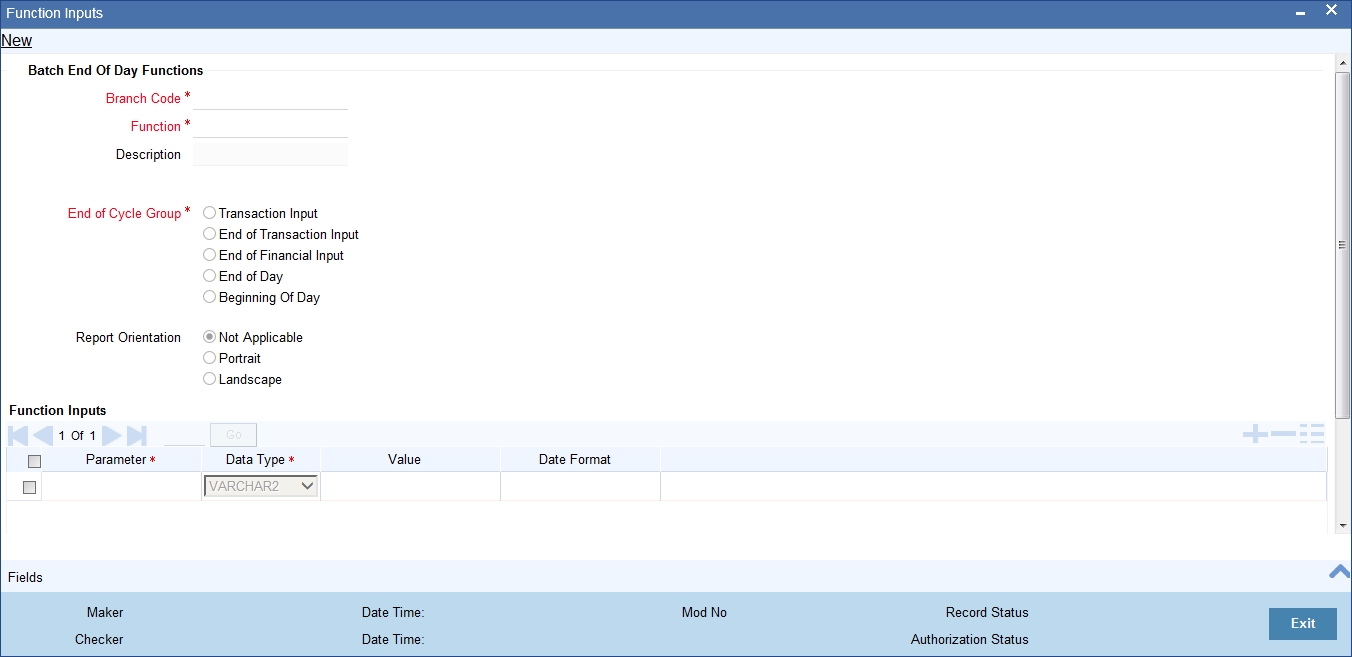

9.3.7.1 Maintaining Function Inputs
Prior to maintaining the mandatory programs, you must first maintain the function inputs for Batch EOD Functions. You can do this using the ‘Batch EOD Function Inputs’ screen. You can invoke this screen by typing ‘BADEODFE’ in the field at the top right corner of the Application tool bar and clicking on the adjoining arrow button.
Here you can maintain the function inputs for Batch EOD Functions by specifying the following details:
After specifying the above details, you can add the functions input for the function in the ‘Function Inputs’ table. You must mandatorily specify the Parameter and Data Type for each function. Now you can proceed with maintaining the Instrument Batch Handoff process as a mandatory program.
