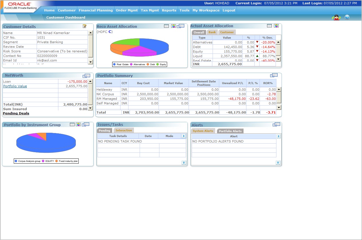

In FCUBS, we can assign Segments to customers. Based on certain factors, the RM in FCUBS decides whether a Retail customer is eligible for a Wealth Segment and if eligible, upgrades the customers to such a segment.
Whenever a customer is upgraded to Wealth set of segments, all his Accounts, Balances, TDs etc would be sent to FCPB as EOD File Handoffs. For Retail Customers who have not been assigned a Segment or Upgraded even once, the system will not send any notifications or EOD File Handoffs to FCPB.
FCUBS sends XML based online notifications for Customer creation/modification, CASA account creation/modification and TD creation/transactions to FCPB for the Segmented Customers only. It does not send any XML notifications for retail customers that are not allotted any Segment in FCUBS.
Whenever a customer is created in FCUBS with customer type as Individual or Corporate and if the Segment is also defined, notifications will be sent by FCUBS via an online notification XML to FCPB.
If Customer Category is defined as 'Broker' with Segment not being mentioned/blank, FCUBS will send an online Customer Creation Notification to FCPB. FCPB would create the details for a Broker in Broker Master Table. If the Segment is not mentioned for the ‘Broker’ created in FCUBS due to any reason, then the system will generate Segmentation Upgrade files at EOD for Broker. Thus resulting in a failure while uploading such Customer Segmentation Upgrade files in FCPB, as this ‘Broker’ as a customer is not created in FCPB.
Mapping of Client IT Type, Segment, Status, Client Classification and Client Category in FCPB:
FCPB has capability to define various types of Client IT Types like Individual, Corporate, NRI etc. These values are to be maintained in FCPB with the same values that are being maintained at FCUBS during Implementation. Similarly Client Category, Client Status are also maintained suitably in REF Tables of both FCPB and FCUBS systems. These tables are then synched-up via Transaction_Transformation screen, so that FCPB's internal names and values are mapped to FCUBS's names.

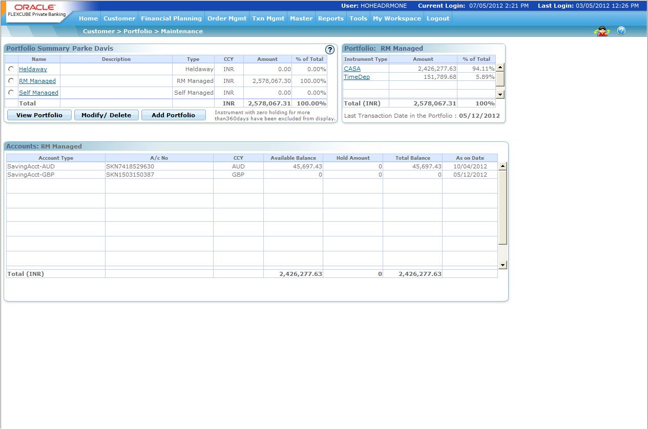

The details of Customer CASA Account Balances Notifications are given below:
The following steps are involved in the process:
| FCPB Column Name | Description | FCUBS Element Name (as per the XML) | |||
| SUB_PORTFOLIO_ID (PMS_PORTFOLIO_HOLDING) | CASA Account no | CUST_AC_NO | |||
| Client_id (PMS_PORTFOLIO_HOLDING) | CIF ID | CUSTNO | |||
| INSTRUMENT_CCY (PMS_PORTFOLIO_HOLDING) | Currency of the CASA Account | CCY | |||
| VALUE_DATE (PMS_PORTFOLIO_HOLDING) | The date of receipt of the balances | Since it is online notification, the XML would be received as and when the balances are updated. So the date of receipt of the XML notification would be populated as value_date | |||
| TOTAL_ACQ_COST (PMS_PORTFOLIO_HOLDING) | Actual Balance including unclear balances | ACBALANCE | |||
| MARKET_VALUE (PMS_PORTFOLIO_HOLDING) | Balance available to be spent | ACAVLBAL | |||
| HOLD_AMOUNT (PMS_PORTFOLIO_HOLDING) | The current balance minus available balance would give the blocked/hold amount | ACBALANCE- ACAVLBAL |

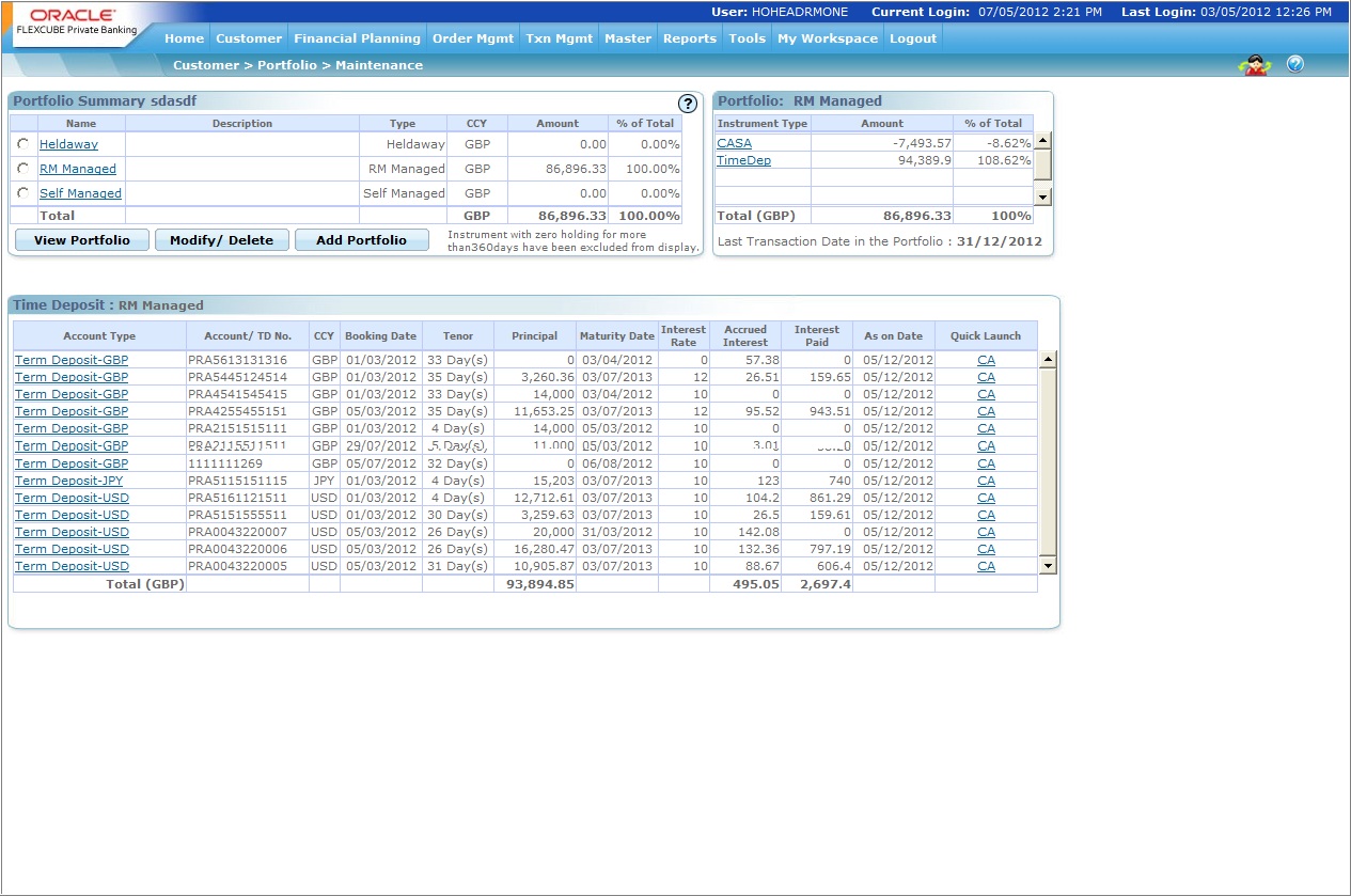

Following types of transactions related to TD are sent by FCUBS.
TD Transaction Types:
Whenever a TD gets booked in FCUBS, it is sent to FCPB by Online Notification.
The details of TD Account Creation Notification interface are given below:
| TRAN_DATE | ACCOPENDT | ||||
| TRAN_TYPE- to be defaulted to ‘NEW’ | Would be populated based on the xsd notification service received from FCUBS | ||||
| AMOUNT | TDAMT | ||||
| AMT_CCY | CCY | ||||
| CLIENT_ID | CUSTNO | ||||
| SUB_PORTFOLIO_ID | ACC | ||||
| SUB_PORTFOLIO_ID(PMS_PORTFOLIO_HOLDING) | ACC | ||||
| CLIENT_ID(PMS_PORTFOLIO_HOLDING) | CUSTNO | ||||
| INSTRUMENT_CCY(PMS_PORTFOLIO_HOLDING) | CCY | ||||
| TOTAL_ACQ_COST (PMS_PORTFOLIO_HOLDING) | The TD deposit amount would be populated | TDAMT | |||
| MARKET_VALUE(PMS_PORTFOLIO_HOLDING) | The TD deposit amount would be populated | TDAMT | |||
| CLIENT_ID(PMS_TD_HOLDINGS_DETAILS) | CUSTNO | ||||
| PROD_ID(it will have values like time deposit, call deposit etc) | ACCLS(the same values to be in sync with those values in FCPB) | ||||
| CURRENCY | CCY | ||||
| MATURITY_DATE | MATDT | ||||
| INT_RATE | INTEREST_RATE under <Tddetails> subnode | ||||
| TENOR | DFTENOR | ||||
| TENOR_DM- to be defaulted to days | Will be defaulted to D(days) since FCUBS would be sending the tenor details in days | ||||
| BOOKING_DATE | ACCOPENDT | ||||
| Spread_Bps | In Account Class for TD Product, define a UDF with FLDNAME as SPREAD (while creating the TD Class) and the FIELD_VALUE for this UDF will contain the Spread | ||||
