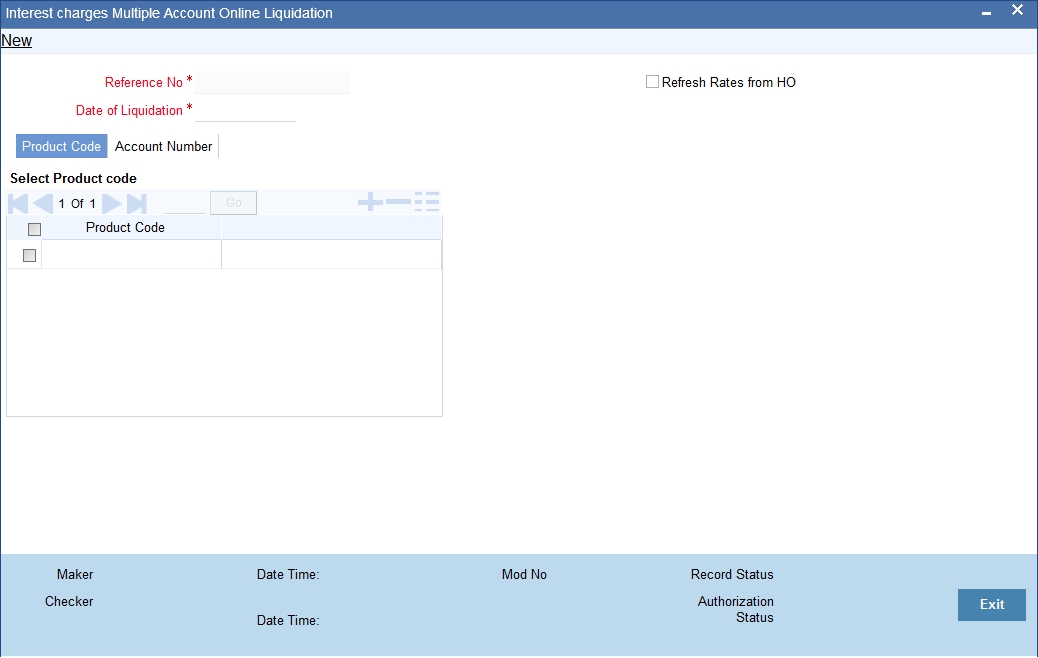

Online Liquidation for multiple accounts can be done via the Interest and Charges Multiple Account Online Liquidation screen. You can invoke this screen by typing ‘ICDOLIQ’ in the field at the top right corner of the Application tool bar and clicking the adjoining arrow button.
Reference Number
Reference number is defaulted here.
Branch Code
Code of the current branch is defaulted here.
Date of Liquidation
Specify the date for which you want to liquidate profit from the adjoining calendar. Profit for the accounts that you specify, will be liquidated from the last liquidation date up to the date that you enter here.
The system defaults to yesterday's date.
Refresh Rates from H.O.
Check this box if you would like to apply the latest profit rates maintained in the Head Office, on an account that you are liquidating.
If you do not check this box, the system will use the profit rates that were last propagated by the head office, to calculate profit for the account being liquidated.
You can choose to liquidate profit for
Check the check boxes adjacent to each option to indicate that you would like to liquidate profit using the option.
Using these options in conjunction with the options in the ‘Accounts To Liquidate’ field, you can liquidate profit for
Depending on your selection criteria in conjunction with the ‘Accounts to Liquidate’ field, a list of products will be displayed.
For example, if you choose to liquidate profit for ‘selected accounts’ and ‘all products’, a list of all authorized products will be displayed. When you choose a product, all the authorized accounts linked to the product will be displayed. Profit for the accounts that you choose will be liquidated.

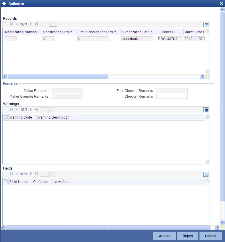

For the transaction to be authorized, click ‘Authorize’ button. The following screen will be displayed:
Note
The IP liquidation will be processed only during authorization.

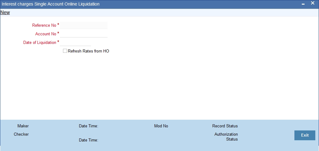

You can process online liquidation for a single account using the Interest and Charges Single Account Online Liquidation screen. You can invoke this screen by typing ‘ICDLIQAC’ in the field at the top right corner of the Application tool bar and clicking the adjoining arrow button.
You can maintain the following parameters here:
Reference Number
Branch Code
Account Number
Specify the account or product from the adjoining option list, if you have chosen to liquidate profit for specific accounts or products.
Date of Liquidation
Specify the date when you want to liquidate profit from the adjoining calendar. Profit for the accounts that you specify, will be liquidated from the last liquidation date up to the date that you enter here.
Check this box if you would like to apply the latest profit rates maintained in the Head Office on an account that you are liquidating.
If you do not check this box, the system will use the profit rates that were last propagated by the head office to calculate profit for the account being liquidated.
While defining the rule,
Remember that when you run the ad hoc liquidation function, inconsistencies in maintenance data, if there are any, will be reported by the IP Consistency Check. Rectify the inconsistencies before you run the ad hoc liquidation function.
Note

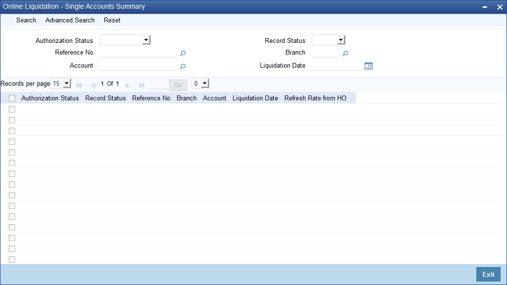

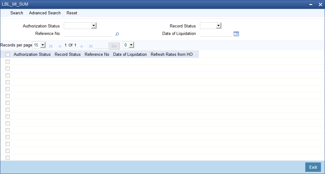

You can view the summary of profit and charges for single account in the Interest and Charges Single Account Online Liquidation Summary screen. To invoke this screen, type ‘ICSLIQAC’ in the field at the top right corner of the Application tool bar and click on the adjoining arrow button.
You can query for records based on any one or all of the following criteria:
Click ‘Search’ button. The system identifies all records satisfying the specified criteria and displays the following details for each one of them:

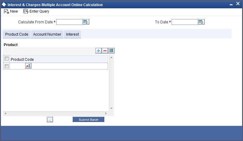

Online Calculation for multiple accounts can be processed via the Interest and Charges Multiple Account Online Calculation screen. You can invoke this screen by typing ‘ICDOCALC’ in the field at the top right corner of the Application tool bar and clicking the adjoining arrow button.
Calculation From Date
Specify the date from when you want to calculate the profit applicable for an account, from the adjoining calendar.
To Date
Specify the date till when you want to calculate the profit applicable for an account, from the adjoining calendar.
You can choose a product for which you want the profit applicable, in the following manner:
Click against the category you wish to choose.

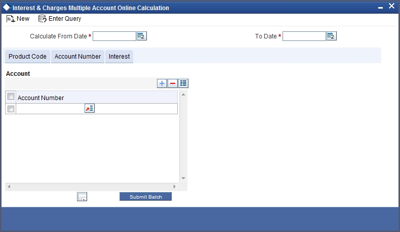

Click on ‘Account Number’ tab in the Interest and Charges Multiple Account Online Calculation screen to get below given screen.
You can choose an account for which you want the profit applicable, in the following manner:
Intraday Sequence Number
This is the reference number for each transaction using which the batch is processed. This number is generated at back end based on a sequence.
Submit Batch
The user can submit the batch using the displayed Intraday Sequence Number. When you click ‘Submit’ button, system displays the message as “Online calculation successfully completed.” to confirm that the process has been submitted for batch processing.
Once the process is submitted, the batch is processed independently at the back end without disturbing other activities at the front end.

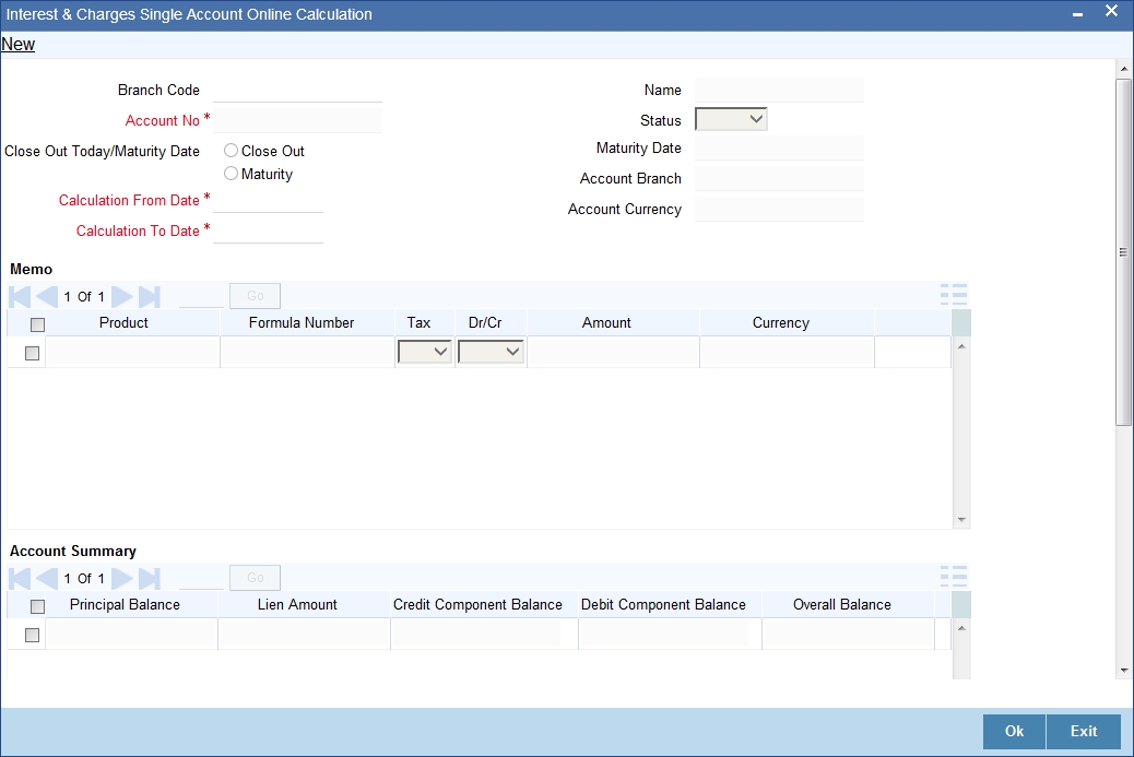

Online calculation for a single account can be processed via the Interest and Charges Single Account Online Calculation screen. You can invoke this screen by typing ‘ICDCALAC’ in the field at the top right corner of the Application tool bar and clicking the adjoining arrow button.
You can calculate profit for a specific account for a given date range.
Account Number
Specify the account number for which you need to calculate the profit. Choose the appropriate account number from the option list.
Close Out Today / Maturity Date
Choose the date type. The following options are available:
The the account start date is defaulted as soon as you select the account number from option list.
Calculation To Date
For TD accounts, if you have selected ‘Close Out’ as the date type, then ‘Calculate to Date’ will be defaulted to the current application date.
If you have selected ‘Maturity’ as the date type, then ‘Calculate to Date’ will be defaulted to the maturity date of the TD account.
Name
Customer name is defaulted here.
Status
Status of the account is defaulted here. The possible values are:
Maturity Date
TD account maturity date is defaulted here.
Account Branch
Branch in which the account is maintained is defaulted here.
Account Currency
Currency of the account is defaulted here.
The system displays the following details of the account:
Memo
Account Summary
