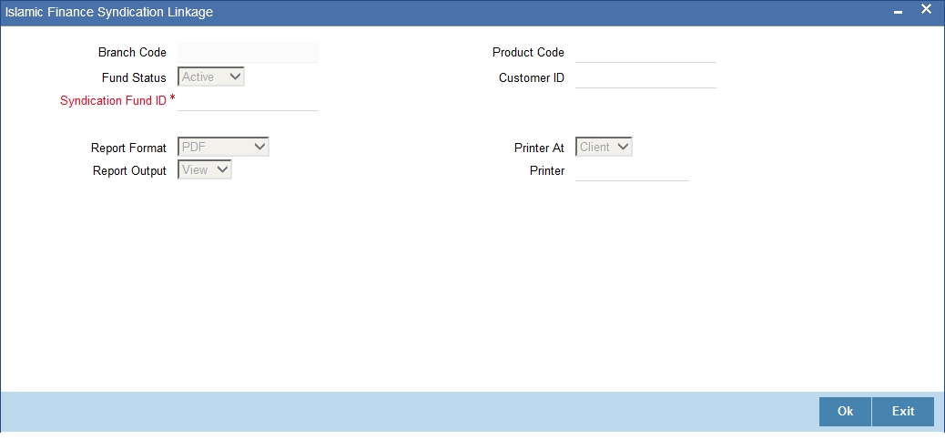

This provides details on fund utilization. This report also lists the contract level details in which the fund has been utilized. You can invoke Islamic Financial Syndication Linkage Report’ screen by typing ‘IARILSLK’ in the field at the top right corner of the Application tool bar and clicking on the adjoining arrow button.
You can maintain the following parameters to generate ‘Islamic Financial Syndication Linkage Report’:
Branch Code
The system defaults the code of the current branch here.
Product Code
Specify code of the product you need to generate a report for. The adjoining option list displays all valid financial product codes maintained for financial syndication. You can select the appropriate one.
Fund Status
Select status of the fund you need to generate the report for from the adjoining drop-down list. This list displays the following values:
Customer ID
Specify ID of the customer you need to generate a report for. The adjoining option list displays all valid customer IDs maintained for financial syndication. You can select the appropriate one.
Syndication Fund ID
Specify ID of the syndication fund you need to generate a report for. The adjoining option list displays all valid fund IDs maintained for financial syndication. You can select the appropriate one.
Report Format
Select the format in which you need to generate the report from the adjoining drop-down list. This list displays the following values:
Report Output
Select the output in which you need to generate the report from the adjoining drop-down list. This list displays the following values:
Printer At
Select location where you wish to print the report from the adjoining drop-down list. This list displays the following values:
Printer
Select printer using which you wish to print the report from the adjoining option list.
