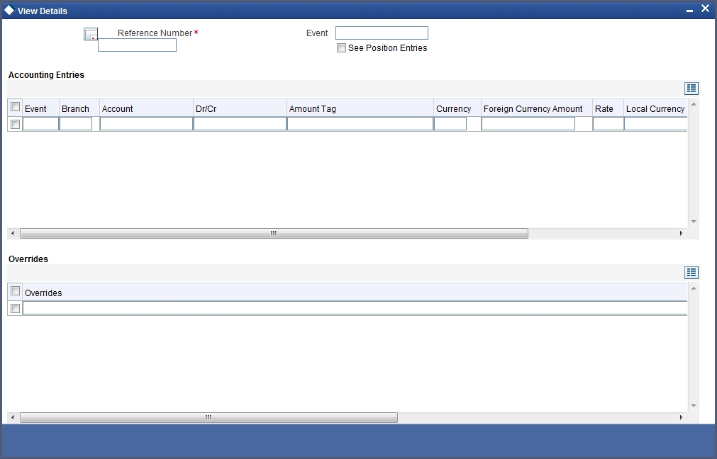

The event details screen of contract processing will show the details of the accounting entries generated for an LC. Click ‘Events’ in the LC Contract Detailed View screen to go to the LC Contract View Events screen.
The details of events that have already taken place on the contract will be displayed, along with the date on which the event took place.
Click ‘Accounting Entries’ to view the accounting entries for the event that is highlighted. Click ‘Message’ to view the messages applicable to the event. Click on ‘Exit’ or ‘Cancel’ to go back to the LC Contract Detailed View screen.
From ‘LC Contract - View Events’ screen, click ‘Accounting Entries’ to view the Accounting Entries for the event. The accounting entries that are passed depend on the type of LC that you are processing.
The following information is provided for each event:
Click ‘Exit’ or ‘Cancel’ to go back to the screen from where you invoked the Accounting Entries screen.

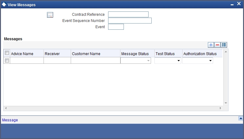

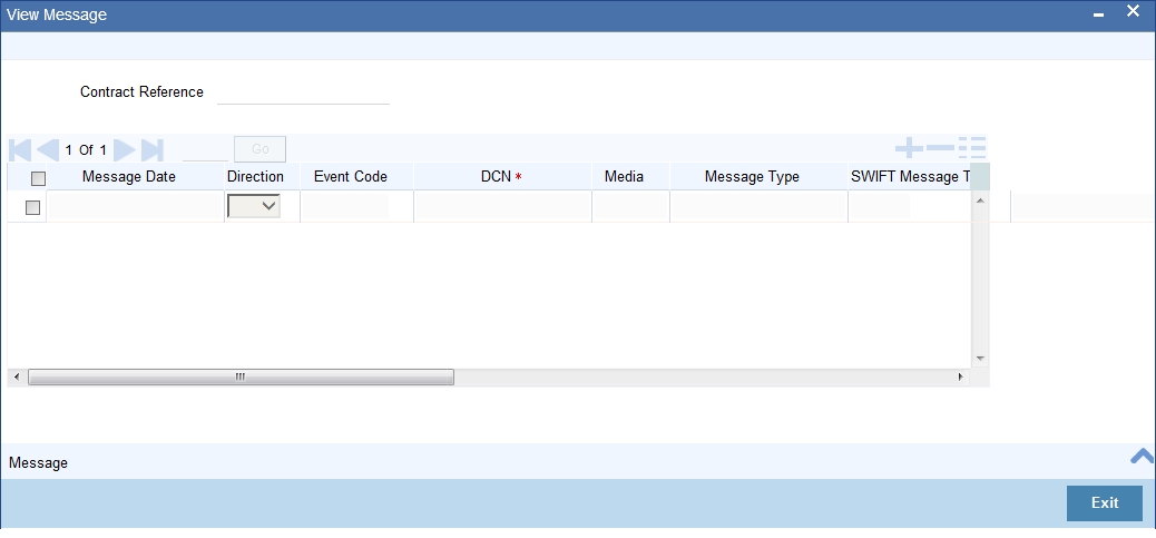

Click ‘Message’ from the View Events screen to view the list of advices applicable to a particular event in the lifecycle of the LC.
The following details of a message are displayed:
To view the text of a message, highlight the message and click on the ‘Message’ button. Click ‘Exit’ or ‘Cancel’ to exit the screen.

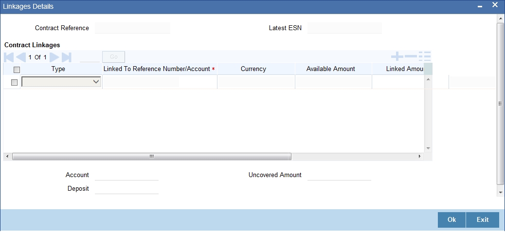

You can link an LC contract to deposits and accounts.
Type of linkage |
Description |
Linking a deposit |
The entire LC amount, or
a portion of it, can be linked to a deposit. The outstanding amount in
the deposit should always be greater than or equal to the LC amount.
Linking an account |
You can link the entire contract amount or a portion of it, to a savings or current account that is maintained with you. The available balance in the account should always be equal to or greater than the contract amount that is outstanding. You can link any number of contracts to an account provided a balance greater than or equal to the total outstanding contract amount(s) is available in the account. |
The entire contract amount or a portion of it can be linked to any number of deposits or account or to both. From the LC Contract Details screen, you can invoke the ‘Linkages Details’ screen by clicking ‘Linkage Details’ button.
In this screen, you can specify any account/deposit with you, and indicate the funds that you would like to block.
Specify the following details.
Type
In the Contract Details screen, you can specify the type of linkage. The LC can be linked to a:
If you select the EL type, then LC reference number will be available in Linked to Reference Number option list. Only Export type of LC is displayed in option list. You can link Export type of LC, only for bill availing under reimbursement type of LC.
Linked To Reference Number/Account
If the LC is linked to a deposit, you should enter the Reference Number of the deposit. The deposit should be a valid contract in Oracle FLEXCUBE, with a Value Date that is earlier than or the same as the Value Date of the LC contract. The Maturity Date should be the same as, or later than that of the contract.
If the linkage is with an account, enter the account number to which you are linking the LC. The account you specify has to be a customer account (a Current account or a Savings Bank account).
If the linkage is with LC, linked reference number will be the reference number that you entered in the main page.
Currency
The currency of the linkage type to which the LC is linked is displayed once the linkage details are specified.
Available Amount
The system displays the amount available against the linked contract or account.
Exchange Rate
If the currency of the LC is different from the currency of the deposit or account to which it is being linked, the mid-rate for the day will be picked from the Exchange Rate table and displayed in the screen.
Converted Linked Amount
The system displays the converted linked amount.
Linked Amount
Indicate the contract amount that has to be linked to the deposit or account. This amount can be the entire amount of the LC or a portion of it. The amount available for linkage, in the specified deposit or account, is arrived at, by taking into account other linkages and the uncollected and unauthorised balance (in the case of an account).
Once the linked amount is specified, the system displays the following values.
Account/Deposit
The system displays the amount linked to each contract or account.
Uncovered Amount
The system displays the contract amount that has not been linked, in the case of a partial linkage.

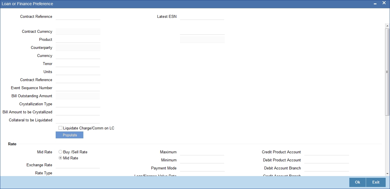

Product
The loan product is displayed here. However, you can change the loan product if required. Specify the loan product that should be used for loan contract creation. The adjoining option list gives a list of loan products maintained in the Consumer Lending module. Choose the appropriate one.
Counterparty
The system displays the customer ID (CIF) of the shipping guarantee.
Currency
Specify the currency in which the loan should be initiated. The adjoining option list gives a list of valid currency codes maintained in the system. Choose the appropriate one.
Tenor
Specify the loan tenor. By default the system displays the LC tenor. However, you can change it.
Units
Specify the units in which the tenor is specified.
Contract Reference Number
The contract reference number is displayed here.
Event Sequence Number
The system displays the event sequence number.
Bill Outstanding Amount
The bill outstanding amount is displayed here.
You can capture the exchange rate details here.
Middle Rate
Select the rate to be applied for conversion. The options available are Middle rate and Buy/Sell Rate.
Exchange Rate
For a customer availing any Relationship Pricing scheme, the customer specific exchange rate derived by adding the original exchange rate and the customer spread maintained for the relationship pricing scheme gets displayed here.
If Relationship Pricing is not applicable, Exchange Rate will be the same as the Original Exchange Rate.
For more details on customer specific exchange rates, refer the section titled ‘Specifying Pricing Benefit Details’ in Relationship Pricing user manual.
Rate type
Specify the rate type used for exchange rate. The adjoining list gives a list of rate types. Choose the appropriate one. The default rate type is Standard.
The base or the actual exchange rate between the contract currency and collateral currency gets displayed here.
Payment Mode
Specify the mode of payment.
Loan Value Date
The system displays the debit value date. However, you can change it.
Maturity Date
The system computes the maturity date based on loan tenor and displays it here. However, you can change it.
Credit Product Account
Specify the credit settlement account of the loan.
Debit Product Account
Specify the debit settlement account of the loan.
Debit Account Branch
Specify the branch where the debit settlement account used for the loan resides.
Credit Account Branch
Specify the branch where the credit settlement account used for the loan resides.
While creating a loan from a shipping guarantee, the system defaults the interest rate and exchange rate specific to the customer. These rates are taken from the section ‘Promotion Maintenance’ of the ‘Customer Maintenance’ screen. In case the default rates are not available, the system defaults the standard mid rate.
The system will calculate the penalty based on the loan creation date. That is, even if the value date is different from the loan creation date, the penalty will be calculated after the expiry of the penal start days counted from the date of creation of the loan. You can manually change the number of penal value days in order to start applying the penalty from a different date.

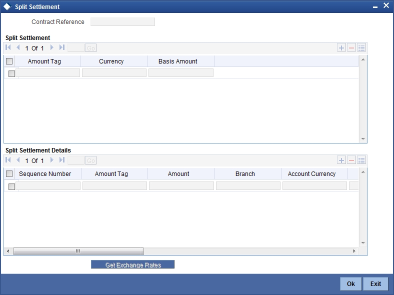

Click ‘Split Settlement’ button to invoke the following screen.
You can specify the details of the settlement split master in the following fields:
Basis Amount Tag
Specify the amount tag involved in the contract. The adjoining option list displays all valid amount tags maintained in the system. You can choose the appropriate one. For example, on booking a new contract, the only tag allowed is PRINCIPAL. This is referred to as the basis amount tag.
Currency
The system displays the currency associated with the amount tag.
Amount
The system displays the basis amount associated with the amount tag. For example, the amount involved in the contract would be displayed against the amount tag ‘PRINCIPAL’. The amount is in terms of the currency associated with the amount tag.
You can use ‘Get Exchange Rate’ button to get the original exchange rates defaulted in the screen.
For each spilt amount tag, you need to specify the following details:
Amount
Specify the amount for the split amount tag. This amount should not be greater than the amount of the corresponding basis amount tag. The split amount is in the currency of the basis amount tag. This is a mandatory field and you will not be allowed to save the details if you do not specify the amount.
Loan Account
Check this box to indicate that the specified account should be the loan account.
Exchange Rate
Specify the exchange rate that should be used for the currency conversion.
Negotiated Cost Rate
Specify the negotiated cost rate that should be used for foreign currency transactions between the treasury and the branch. You need to specify the rate only when the currencies involved in the transaction are different. Otherwise, it will be a normal transaction.
The system will display an override message if the negotiated rate is not within the exchange rate variance maintained at the product.
Negotiated Reference Number
Specify the reference number that should be used for negotiation of cost rate, in foreign currency transaction. If you have specified the negotiated cost rate, then you need to specify the negotiated reference number also.
Note
Oracle FLEXCUBE books then online revaluation entries based on the difference in exchange rate between the negotiated cost rate and transaction rate.

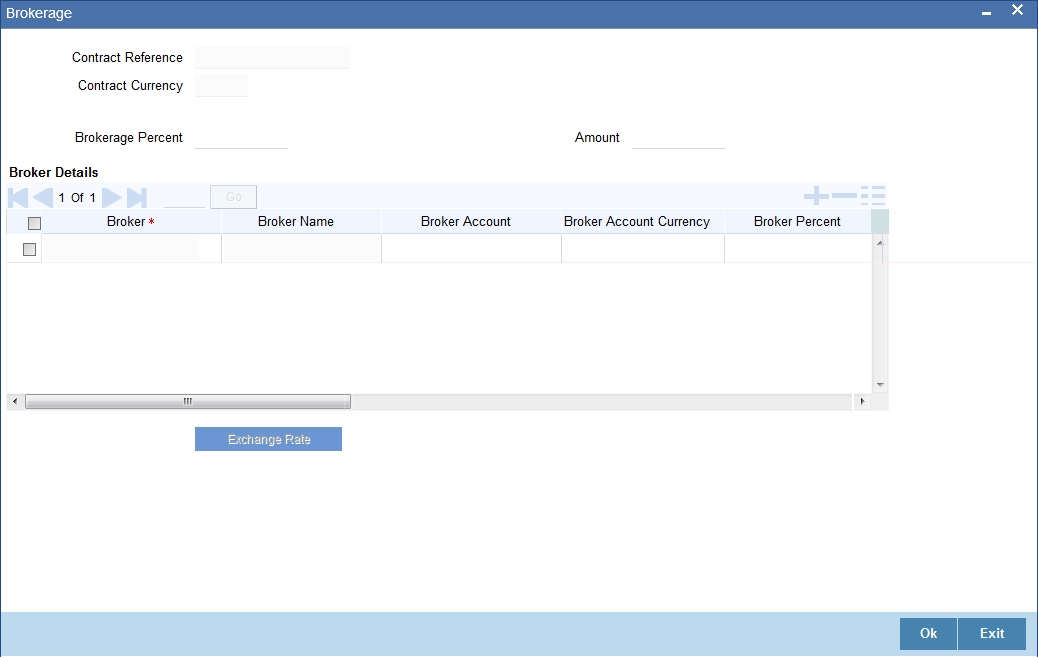

You can capture the brokerage details for an LC contract and set your preferences for sharing the brokerage amount among multiple brokers using ‘Brokerage’ screen. To invoke the screen, click ‘Brokerage’ button on ‘Letters of Credit Contract Details’ screen.
You can capture the following details:
Contract Reference
The system displays the reference number of the contract.
Contract Currency
The system displays the currency of the bills contract. You cannot modify the contract currency.
Brokerage Percentage
Specify the percentage of the contract amount that should be paid as brokerage. Based on the percentage set here, the system calculates the brokerage amount. The brokerage amount calculation takes place at the Bills contract level.
In case of Bills contracts, you may directly enter the brokerage amount. However, if you specify the brokerage percentage as well as the amount, the system ignores the amount and calculates it afresh based on the percentage specified here.
Brokerage Amount
Specify the brokerage amount to be paid. However, if you have entered the brokerage percentage, the system ignores the amount mentioned here and calculates it afresh based on the brokerage percentage.
You can directly enter the contract amount for Bills contracts only. In case of LC contracts, the system displays the amount based on the brokerage percentage and contract amount. You cannot modify the brokerage amount in that case.
You can share the brokerage amount among multiple brokers. Click add button to add more brokers to the list.You can define the percentage of brokerage amount to be paid to each broker selected under this list
Broker
Specify the broker ID. The option list displays all valid broker IDs maintained in the system. Choose the appropriate one.
You can maintain multiple records for the same broker ID.
Broker Name
Based on the broker ID selected, the system displays the name of the broker.
Broker Account
Specify the broker account. The option list displays all valid accounts maintained for the selected broker along with the Nostro accounts and GLs for which posting is allowed. Choose the appropriate one.
Broker Currency
The system displays the currency of the selected broker account.
Percentage
Specify the percentage of total brokerage amount that should be paid to the selected broker. This will make the selected broker eligible for that percentage of the total brokerage amount shown above.
You can allot a specific percentage of the brokerage to each broker selected here. The system will verify whether the percentages allotted for all brokers together equals to 100 or not.
Amount in Account Currency
The system displays the portion of brokerage amount allotted to the selected broker in terms of local currency.
Exchange Rate
The system displays the exchange rate between the local currency and the account currency. This rate is used to convert the brokerage amount into the account currency. You can modify the exchange rate.
Amount in Contract Currency
The system calculates and displays the portion of brokerage amount allotted to the selected broker in terms of contract currency.
The system displays the actual exchange rate. This rate is inclusive of all available customer spreads.
Negotiated Rate
Specify the rate of exchange agreed upon after the negotiations with the broker.
Negotiation Reference Number
Specify the negotiation reference number.
Once you have captured the details, save the contract. The system allows modification of brokerage details until its liquidation.
The system will default the brokerage details to the bill contracts associated with this LC. You may modify the brokerage details at the bills contract level.
You can use ‘Exchange Rate’ button to get the exchange rates between the broker account currency and bill currency for all the brokers listed in the screen.
The system defaults the brokerage details in ‘Spilt Settlements’ screen. Those details are then used in settlements. You can enter the routing details for the messages in case the settlement takes place through Nostro account. If you modify the default brokerage details in ‘Split Settlements’ screen, the system displays an error message.
During liquidation of the brokerage, the system generates credit advices for each of the brokers involved.

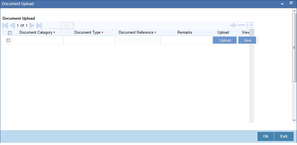

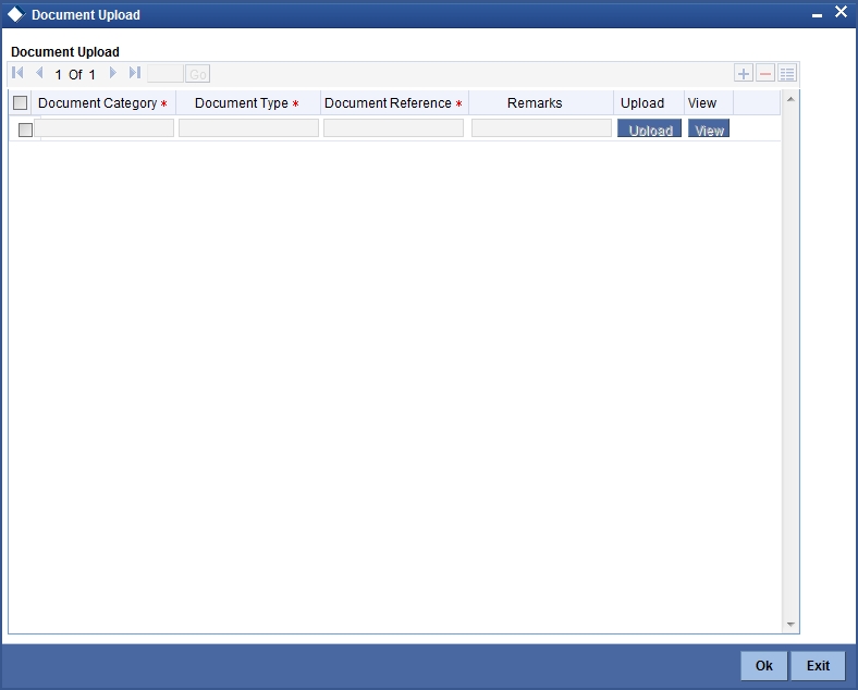

You can capture the customer related documents in central content management repository through the ‘Document Upload’ screen. Click ‘Documents’ button to invoke this screen.
Here, you need to specify the following details:
Document Category
Specify the category of the document to be uploaded.
Document Type
Specify the type of document that is to be uploaded.
Document Reference
The system generates and displays a unique identifier for the document.
Remarks
Specify the additional information, if any.
Upload
Click ‘Upload’ button to open the ‘Document Upload’ sub-screen. The ‘Document Upload’ sub-screen is displayed below:
In the ‘Document Upload’ sub-screen, specify the corresponding document path and click the ‘Submit’ button. Once the document is uploaded through the upload button, the system displays the document reference.
View
Click ‘View’ to view the document uploaded.
Click ‘All Messages’ button to invoke the ‘View Message’ screen. This screen displays all the messages associated to the contract.
The following details are displayed:
Contract reference number – Displays Reference number of the contract, for which messages are generated.
Message Date – Displays the message generation date or received date
Direction – Displays whether the message is an incoming or outgoing message.
DCN – Displays document reference number of a contract.
Media – Displays whether the message is swift message or mail message.
Message Type – Displays the type of message
Swift Message Type – Displays the Swift MT number of the message sent or received.
Receiver/Sender – Displays Receiver or Sender ID.
Name – Displays the name of the Sender or Receiver.
Message Status – Displays current status of message.
Test Status – Displays the test status.
Authorized – System displays whether the status is authorized or unauthorized.
Acknowledgement Status – Displays the Ack/Nack Status of a message
PDE Flag – Displays the PDE flag.
