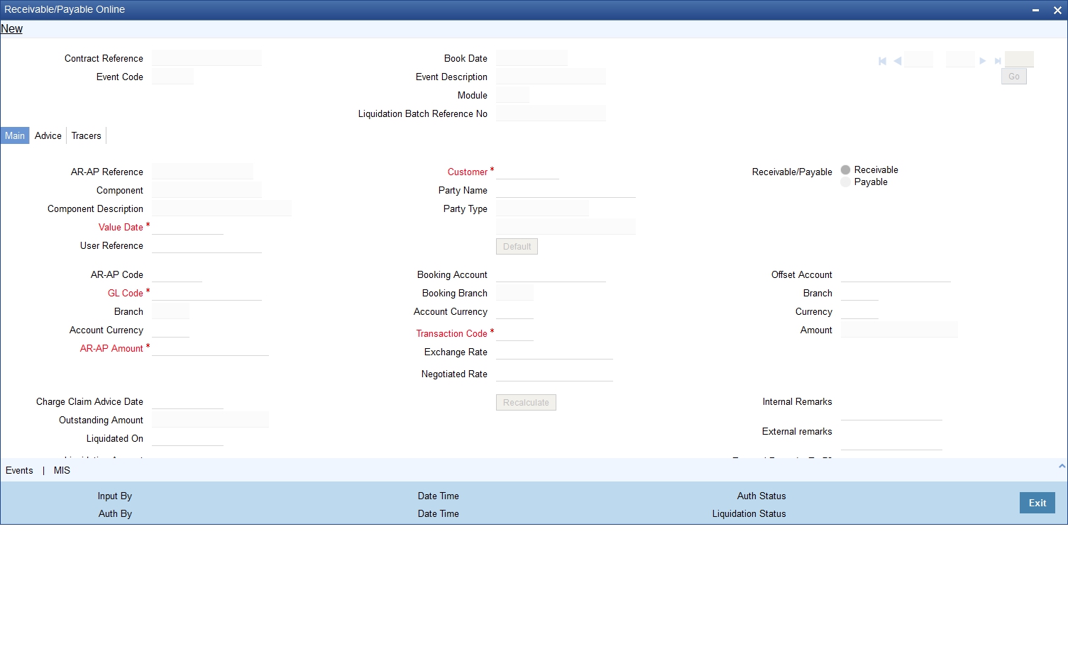

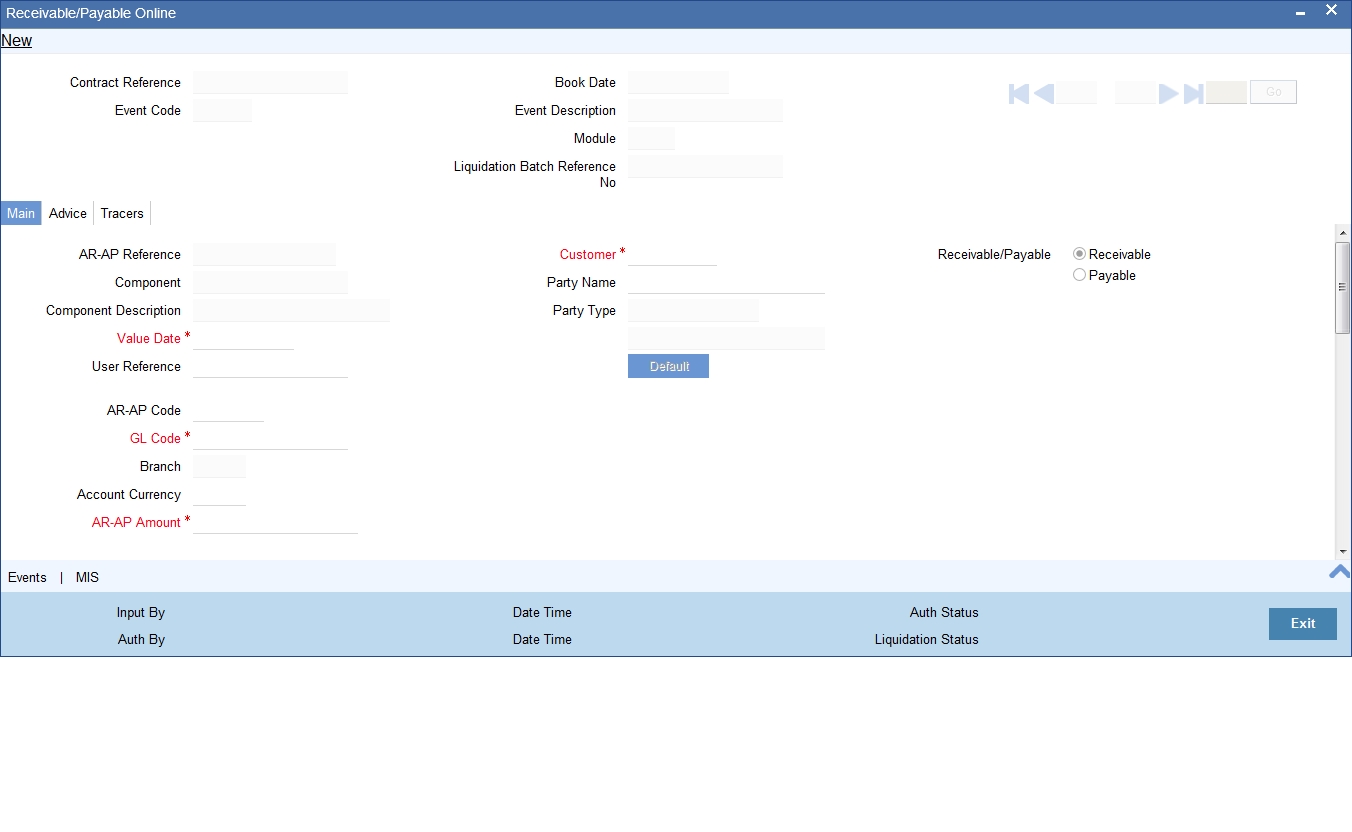

You can pass manual entries into LQ Module to maintain additional entries into AR/AP LQ Module in the ‘Receivable/Payable Online’ screen. You can invoke ‘Receivable/Payable Online’ screen by typing ‘LQDTRONL’ in the field at the top right corner of the Application tool bar and clicking on the adjoining arrow button.

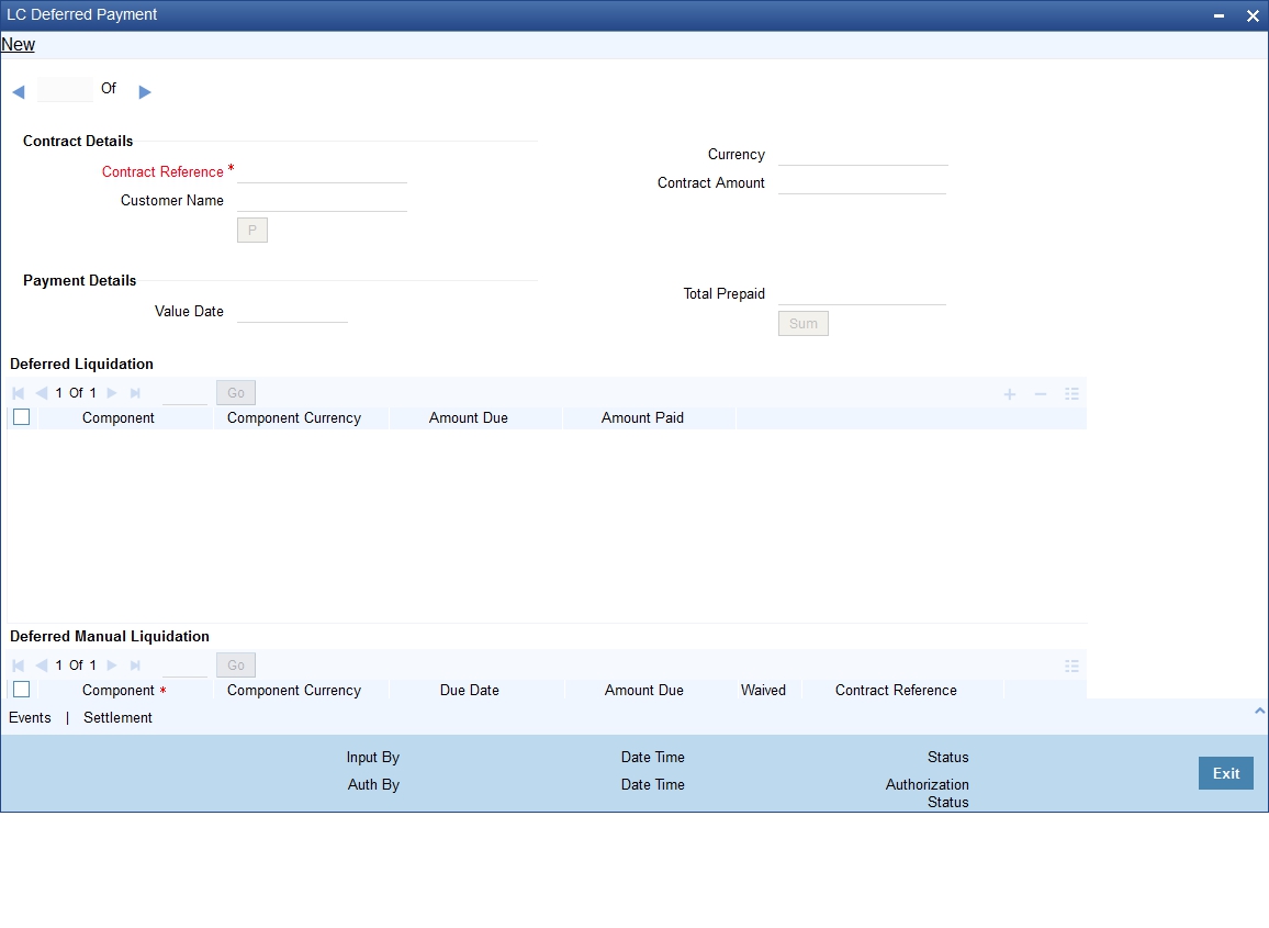

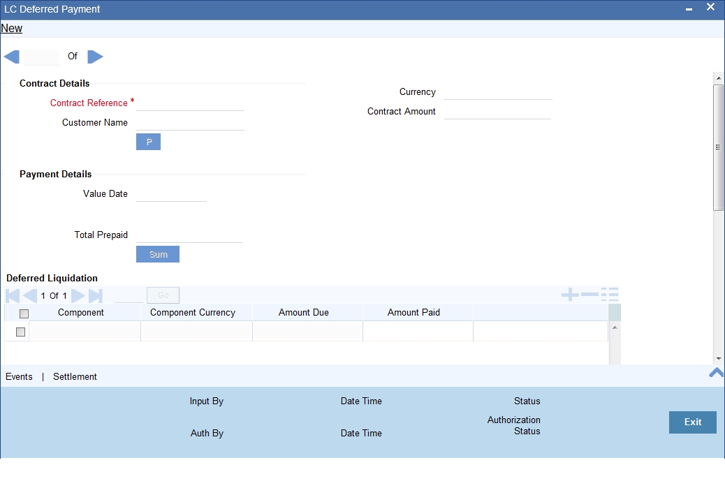

You can liquidate the outstanding components manually using ‘LC Deferred Payment’ screen.
Specify the following details:
Contract Reference Number
Specify the contract reference number. The adjoining option list displays all the valid contract reference number. You can choose the appropriate one.
Contract Amount
System defaults the contract amount from the LC contract.
Customer Name
System defaults the name of the customer from the LC contract.
Currency
System defaults the currency from the LC contract.
Value Date
System defaults the value date to the application date. Howewever, you can not modify the value.
Total Prepaid
Specify the total prepaid amount.
Payment Remarks
Specify your remarks regarding the payments.
Component
System defaults the component from the LC contract.
Component Currency
System displays the component currency.
Amount Due
The total amount due for the charge components till date is displayed by the system during payment as the payment breakup.
Amount Paid
Specify the total amount paid.
Component
Specify the component.
Component Currency
Specify the component currency.
Due Date
System displays the due date.
Amount Due
Waiver
Check this box to indicate that the receivable charge amounts should be waived during manual liquidation.

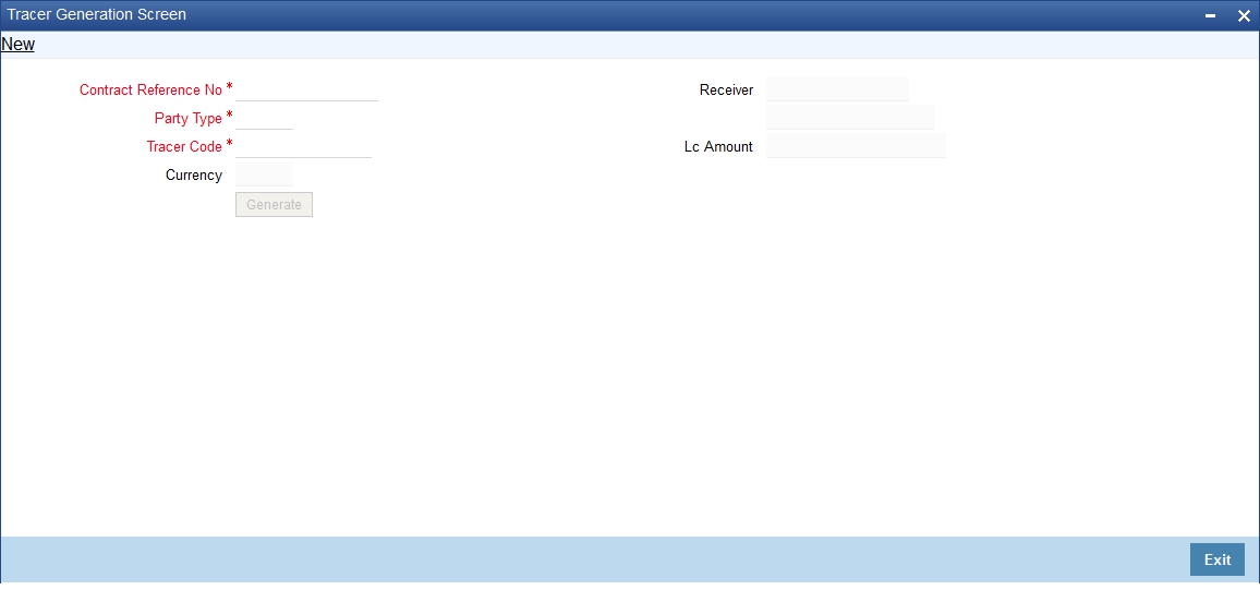

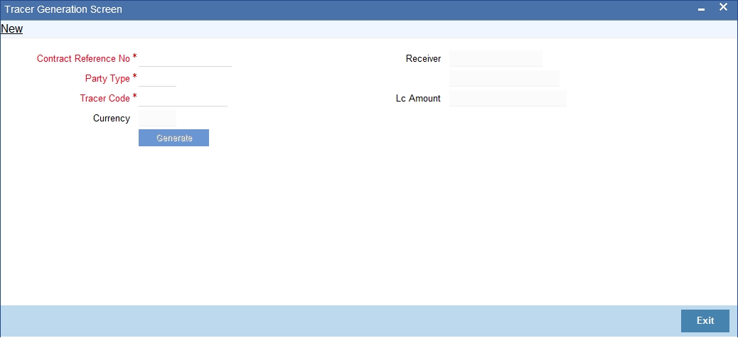

The system generates tracers under TRGN event, which can be viewed from the respective Contract or Outgoing Browser screens. You can manually generate ACK_TRACER and CON_TRACER using ‘LC Tracer Generation’ screen. You can invoke ‘LC Tracer Generation’ screen by typing ‘LCDTRGEN’ in the field at the top right corner of the Application tool bar and clicking on the adjoining arrow button.
You can maintain the following parameters here:
Contract Reference No
Specify contract reference number for which the ACK_TRACER and CON_TRACER are maintained at the contract level, from the adjoining option list.
Party Type
Specify party type of the specified contract reference number from the adjoining option list.
Tracer Code
Specify code of the tracer you need to generate manually. The adjoining option list displays tracers which are selected as required at LC contract level. You can select the appropriate one.
Currency
Currency of the contract is defaulted here based on the details maintained at contract level.
Receiver
Receiver of the contract is defaulted here based on the details maintained for specified party type.
LC Amount
LC amount of the contract is defaulted here based on the details maintained at contract level.
Click ‘Generate’ button. The system generates tracer message corresponding to the specified ‘Tracer Code’ based on the ‘Receiver’s Default Medium’ format
