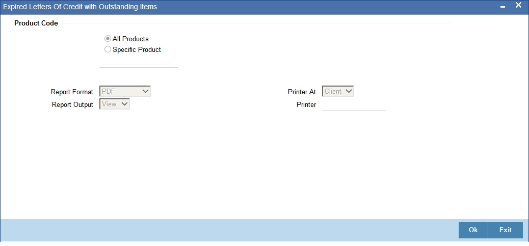

As the name suggests, this report lists all the expired LCs having still have some outstanding items. These outstanding items could be the liability amount, cash collateral and outstanding commission and charges. A commission or charge will be considered outstanding when they are debited from a receivable GL of the bank and not from a customer account.
This report is generated to check if there are outstanding items against an LC. This is done at the time of releasing the cash collateral or while inquiring whether an LC is to be extended, etc.
You have an option to close the LCs that has expired. Once an LC is closed, it will not be reported in this report even if it still has outstanding items. Instead these LCs will be reported in the Closed LC with Outstanding Items report.
You can invoke the screen by typing the code ‘LCRPEX’ in the field at the top right corner of the Application tool bar and click on the adjoining arrow button.
You can specify that the report should contain details of expired LCs associated with all LC products or a specific product. To generate the report for a specific product, select the appropriate Product Code from the option list.

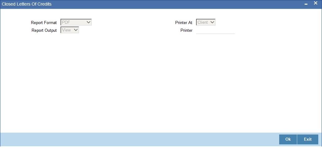

This report lists all the LCs that was closed but still has certain items outstanding. Such LCs may require follow-up action. The information given by this report will be as of the day on which the report is generated.
You can invoke the screen by typing the code ‘LCRPCOLI’ in the field at the top right corner of the Application tool bar and click on the adjoining arrow button.
The items of the LC that can be outstanding include the cash collateral, outstanding commission and outstanding charges. The liability amount outstanding prior to the closing of the record would have automatically been reversed, when the record was closed.
As long as the LC remains in the system, you can reactivate it using the reopen facility.

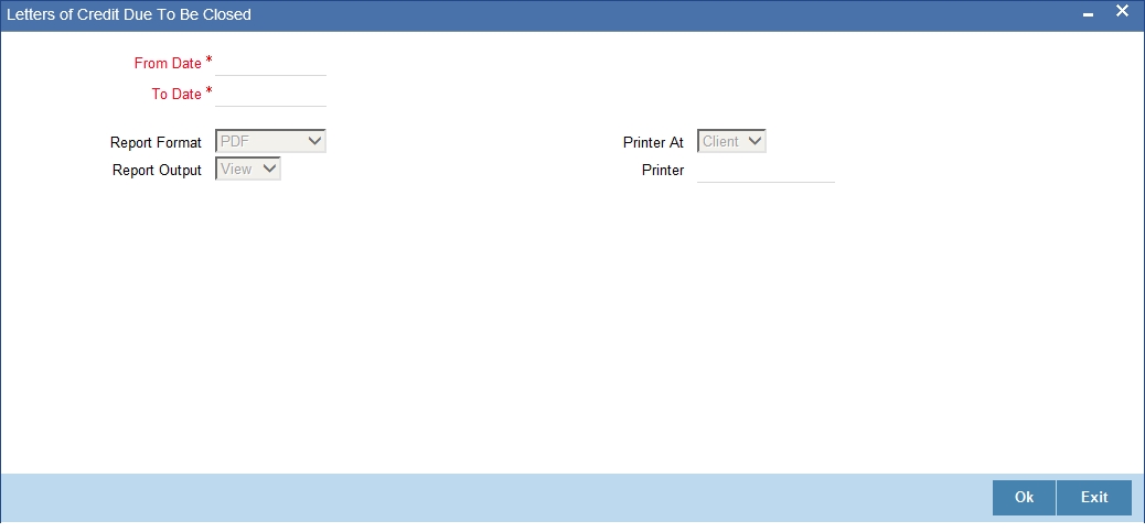

This report lists the details of the LCs that are due for closure, during the period that you indicate.
You can invoke the screen by typing the code ‘LCRPCOLC’ in the field at the top right corner of the Application tool bar and click on the adjoining arrow button.
You can configure this report to be triggered automatically as part of the batch processes run at EOD. You can also generate the report at any time in the day from the Reports menu.
If the report is generated as part of EOD, the report will by default, list all the LCs that is due to be closed, on the date the report is generated.
If you generate the report outside the EOD, specify the period for which the report has to be generated. On selecting this report, you can indicate the period (from and to dates) during which LCs that are due to be closed should be reported. The system will report all LCs due to be closed, whether they have outstanding items or not.
The report options that you selected while generating the report are printed at the beginning of the report. The details of the report are listed on the basis of the closure date of the LC. The contents of the report are discussed under the following heads:

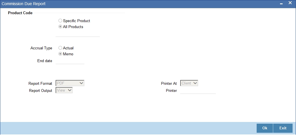

This report prints the details of the periodic commissions that are due to be collected, for a specific period in time.
You can invoke the screen by typing the code ‘LCRPCODU’ in the field at the top right corner of the Application tool bar and click on the adjoining arrow button.
You can specify that this report should contain details of the commission that is due to LCs for a specific period in the future or for all dates. The selection options that you can indicate for the generation of the report are:
The sequence in which the details will be reported is next collection date (from earliest to latest) and then LC reference.
On selecting this report, you can specify the period for which the periodic commissions due to LCs should be reported. For the purposes of reporting, the system takes the next calculation date as the date of collection for LCs. This is for the LCs which you specified that commission should be collected in arrears.
The report options that you indicate while generating the report are printed at the beginning of the report.

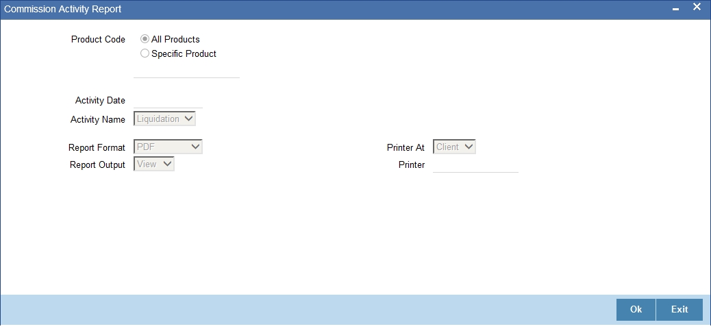

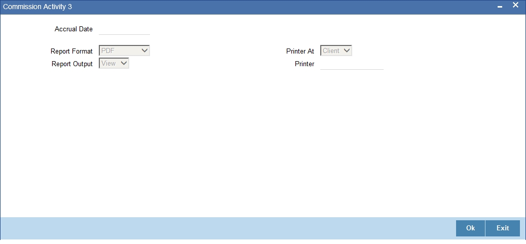

The Commission Activity report prints details of all the LCs for which commission was liquidated or calculated, as of the date the report was generated.
You can invoke the screen by typing the code ‘LCRPCAC’ in the field at the top right corner of the Application tool bar and click on the adjoining arrow button.
You can configure this report to be triggered automatically as part of the batch processes run at EOD, or you can generate the report at any time in the day from the Reports menu.
If the report is generated as part of EOD, it will byf default list all the LCs for which commission was liquidated or calculated as of the current date (the date on which the report was generated).
If you generate the report outside the EOD, you can indicate the date for which you want the activity reported. You also have the option to indicate the activity for which you want details.
You can specify the following options:
Header
The Header carries the title of the report, information on the user who generated the report (User Id), the branch, branch date, the date and time and the page number and module of the report.
Body of the report
The report contains the following details:
Fields |
Description |
Contract Reference |
This is the reference number assigned to the LC by the system. |
Component |
This is the commission component for which there was an activity. |
Event |
This is the Code that identifies the event, during which the commission component is being reported. |
Component CCY |
This is the currency of the commission component that had an activity. |
Component Amount |
This is the commission amount that was involved in the activity.. |
Start Date |
This is the start date of the period for which the commission component is being reported. |
End Date |
This is the end date of the period for which the commission component is being reported. |
Debit Acc Branch |
This is the branch to which the debit account belongs. |
Debit Account |
If the activity reported is collection, this is the account number or GL to which the commission amount is debited. |

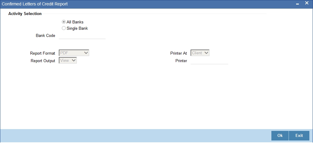

This report lists all the LC that has been confirmed.
You can invoke the screen by typing the code ‘LCRFNREP’ in the field at the top right corner of the Application tool bar and click on the adjoining arrow button.
You can configure this report to be triggered automatically, as part of the batch processes run as part of EOD or you can generate the report at any time, in the day from the Reports menu.
If the report is generated as part of EOD, the report will by default list details of the LCs that have the confirming bank, as a party.
If you generate the report outside the EOD process, you can specify preferences for the generation of the report. On selecting this report, you can indicate whether the report should contain details of all the banks that are involved as confirming banks or of a selected bank. You need to select the bank code from the adjoining option list.
The report options that you select while generating the report are printed at the beginning of the report.
Header
The Header carries the title of the report, information on the user who generated the report (the User Id), the branch, branch date, the date and time, the page number and module of the report.
Body of the report
The report contains information on:

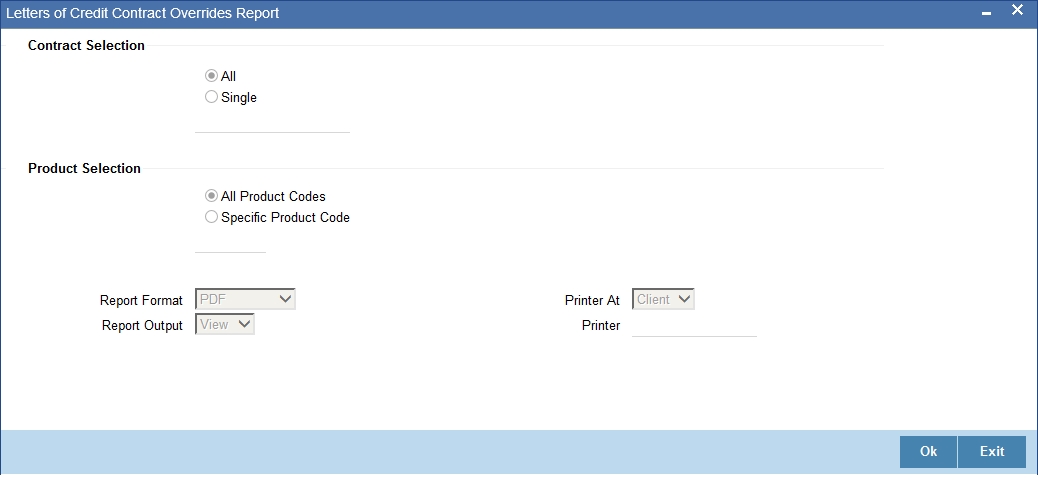

A contract can be saved, with certain exception conditions that were encountered, be given an override. This report lists the overrides that were encountered for contracts, on the date the report was generated.
You can invoke the screen by typing the code ‘LCRPOVD’ in the field at the top right corner of the Application tool bar and click on the adjoining arrow button.
You can generate this report to contain details of all the overrides that occurred during the day or to list the overrides that were encountered, while processing a single LC contract. If you indicate that the report should contain details of the overrides that were encountered in the processing of a single LC, you should also indicate the Reference number of the LC. Also, you need to indicate whether the override report should contain details of all product codes or for a specific product code.
Header
The Header carries the title of the report, information on the user who generated the report (User Id), the branch, branch date, the date and time, the page number and module of the report.
Body of the report

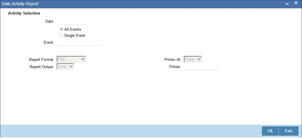

This report gives the details of LCs daily activity journal report. You can initiate the necessary follow up activities after generating this report.
You can invoke the screen by typing the code ‘LCRLYREP’ in the field at the top right corner of the Application tool bar and click on the adjoining arrow button.
Date
You can specify the date for which, you have to generate the report.
On selecting this report, you can indicate whether the report should contain details of all the events or single event. If you indicate single event, then you need to select the event code from the option list. Also, you have to select the date on which the report should be generated.

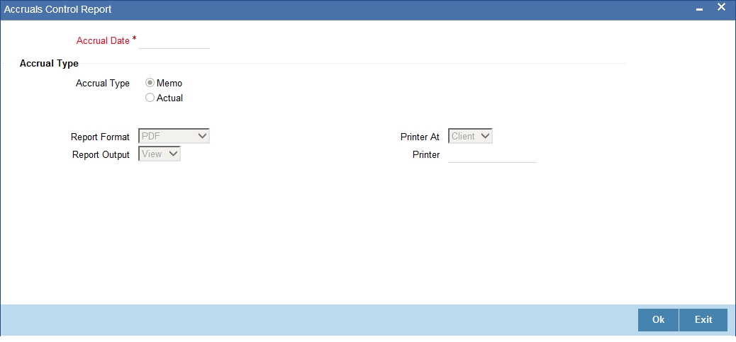

This report lists all the LCs that was accrued. Such LCs may require follow-up action. The information given by this report will be as of the day on which the report is generated.
You can invoke the screen by typing the code ‘LCRPACCR’ in the field at the top right corner of the Application tool bar and click on the adjoining arrow button.
You can specify the date of the accrual.
You need to specify the accrual type. You have the following options:
Header
Body of the report
You can invoke the screen by typing the code ‘LCRPACR’ in the field at the top right corner of the Application tool bar and click on the adjoining arrow button.
Accrual Date

This report prints the details of the periodic commission activity. The information given by this report will be as of the day on which the report is generated.
You can invoke the screen by typing the code ‘LCRPCACT’ in the field at the top right corner of the Application tool bar and click on the adjoining arrow button.

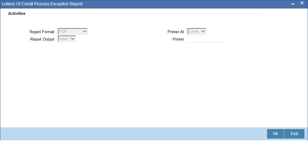

You can generate process exception report by using the ‘Letters of Credit Process Exception Report’ screen. This report lists the process exceptions that were encountered for contracts, on the date the report was generated.
You can invoke the screen by typing the code ‘LCRPEXP’ in the field at the top right corner of the Application tool bar and click on the adjoining arrow button.
Select the process ID from the option list.
You need to indicate whether the process exception report should contain details of all types of activities or a single activity.
Header
Body of the report

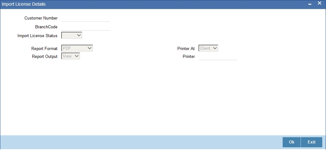

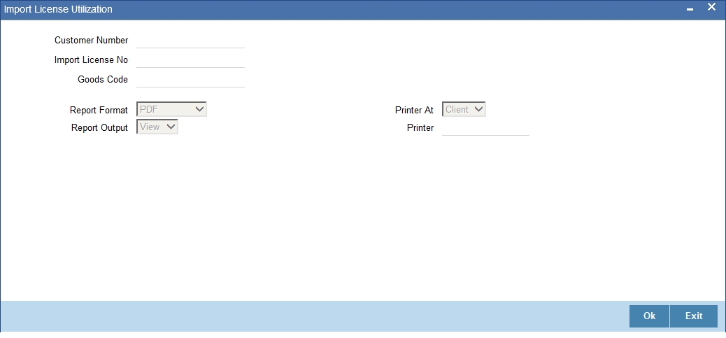

This report provides with the details of the import licenses captured for each customer.You can invoke the screen by typing the code 'LCRIMLIC’ in the field at the top right corner of the Application tool bar and click on the adjoining arrow button.
Customer Number
Select the customer number from the adjoining option list.
Branch Code
Select the branch code from the adjoining option list
Import License Status
Select the import license status from the adjoining option list.
Header
The Header carries the title of the report, information on the user who generated the report (user id), the branch, branch date, the date and time, the page number and module of the report.
Body of the Report

Goods Code |
Goods code captured for import license will be displayed |
Goods Description |
The short description captured for the good code |
Qty |
The quantity of the goods is displayed |
UOM |
The Unit of Measurement is displayed |
License Amount |
The License Amount for the goods code is displayed |
Quantity Utilized |
The Quantity Utilized for the goods code is displayed |
License Amount Utilized |
The License Amount Utilized for the goods code is displayed |
Quantity Reinstated |
The Quantity Reinstated for the goods code is displayed |
License Amount Reinstated |
The License Amount Reinstated for the goods code is displayed |
Available Quantity |
The Available Quantity for the goods code is displayed |
Available License Amount |
The Available License Amount for the goods code is displayed |
This section contains the following details:
This report provides with the details of utilization for an import license.You can invoke the screen by typing the code 'LCRILUTL’ in the field at the top right corner of the Application tool bar and click on the adjoining arrow button.
Selection Options
Customer No
Import License Number
Select the import license number from the adjoining option list.
Goods Code
Select the goods code from the adjoining option list.
Header
Body of the Report
Fields |
Description |
Goods Code |
Goods Description |
Quantity |
Unit Of Measurement |
License Amount (Ccy & Amount) |
Quantity Utilized |
Amount Utilized |
Amount Reinstated |
Available Amount |
Transaction Date |
Displays the transaction date |
Util Ref No |
Displays the transaction ref or the contract ref of the utilization\reinstatement done |
Quantity Utilized |
The Quantity Utilized for the goods code for that particular transaction |
Amount Utilized |
The License Amount Utilized for the goods code for that particular transaction |
The Quantity Reinstated for the goods code for that particular transaction |
Amount Reinstated |
The License Amount Reinstated for the goods code for that particular transaction |
Remarks |
Displays the remarks if any. |

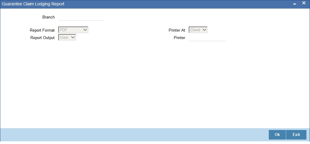

This report provides details of active guarantee contracts on which claim is lodged on the system. You can invoke the screen by typing the code 'LCRGCLM’ in the field at the top right corner of the Application tool bar and click on the adjoining arrow button.
Header
The Header carries the title of the report, information on the user who generated the report (user id), the branch, branch date, the date and time, counterparty ID and name, the page number and module of the report.
Body of the Report
Fields |
Description |
Indicates the contract reference number |
Issue Date |
Indicates the date on which the guarantee was issued. |
Effective Date |
Indicates the date from which the guarantee was effective |
Expiry Date |
Indicates the date of expiry of the guarantee |
Amount |
Indicates the amount of guarantee |
Applicant Name & Address |
Indicates the applicant name and address |
Beneficiary Name & address |
Indicates the beneficiary name and address |
Advising Bank |
Indicates the advising bank |
Claim Date |
Indicates the date on which the guarantee claim was received by the bank |
Claim Amount |
Indicates the amount of the claim |
Claim Remarks |
Indicates the remarks if any specified |
Counter Guarantee Reference |
Indicates the counter guarantee reference number |
