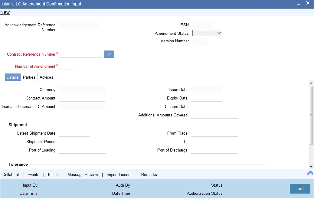

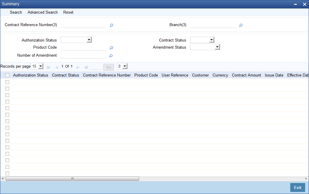

You can invoke this screen by typing ‘LIDAMEND’ in the field at the top right corner of the Application tool bar and clicking on the adjoining arrow button. The screen will be displayed without any details, as shown below:
Click new icon in the application toolbar of the screen.
Acknowledgement Reference Number
Specify the acknowledgement reference number. Alternatively, you can select the reference number from the option list. The list displays all the acknowledgement reference numbers for contract amendment registered in the system.
Note
Registration status will be updated as Processed when the amendment request is processed by selecting Acknowledgment Reference Number.
Contract Reference Number
Select the reference number of the contract to be amended from the option list provided. This option list will display all contracts that are authorized.
Number of Amendment
The system displays the number of amendments based on the contract reference number.
You can amend an LC multiple times before the previous amendment is confirmed or rejected.
ESN
The system displays the event sequence number.
Amendment Status
The system displays the amendment status.
If the following data elements are amended during the previous amendments and the beneficiary consent has not been updated in the system for these amendment, then the system will not allow to proceed with the current amendment:
The system displays an error message in the following cases:
Upon selection of the contract, the following details will be displayed in editable mode:
Make the necessary amendments. Save the changes. To save, click save icon in the toolbar of the screen.
The system will update the following details in the audit trail of the screen:
For details on the amendable fields, refer the chapter ‘Processing an Islamic LC contract’ in this User Manual.

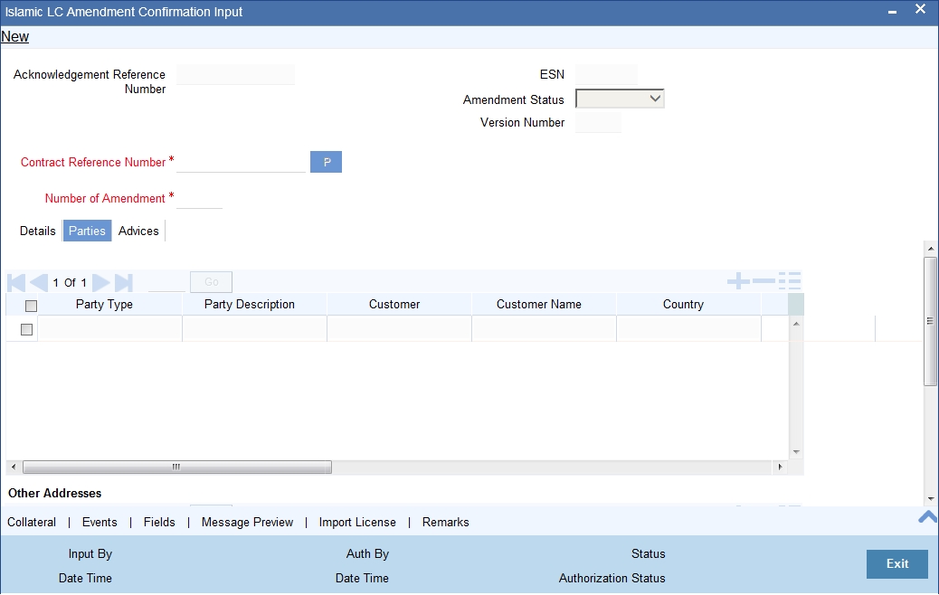

Click the ‘Parties’ tab to view and specify the following details:
Party Type
The system defaults the party type. The user can edit the party type using the adjoining option list that displays all the party types available for the Islamic LC..
Customer
The system defaults the customer number. However, you can modify it.
Customer Name
The system defaults the customer name. However, you can modify it.
Country
The system defaults the country of the customer. However, you can modify it.
Party Description
The system defaults the party description. However, you can modify it.
Dated
The system defaults the date on which the party joined. However, you can modify it.
Customer Reference
The system defaults the customer reference number. However, you can modify it.
Address 1 to 4
The system defaults the address of the party.
Language
The system defaults the language in which advices are sent to the customer.
Issuer Bank
The system defaults the name of the issuer bank.
Media Type
The system defaults the media type. You can select a different medium from the adjoining option list.
Address
The system defaults the other address of the party. However, you can edit this field.
Account
The system defaults the account number. However, you can edit this field.

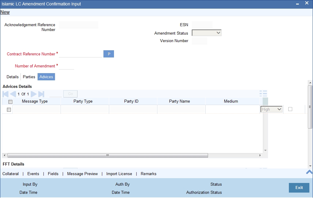

Click the ‘Advices’ tab to view and specify the following details:
Message type
Check the box to view the advice details.
Party type
The system displays the party type for which the advice is generated.
Party Id
The system displays the party id for which the advice is generated.
Party Name
The system displays the name of the party for which the advice is generated.
Medium
The system displays the medium through which the advice is sent. The user can select a different medium from the list. If the medium is modified, the user must provide the new address in the ‘Other Addresses’ section, in the ‘Parties’ tab.
Priority
The system displays the priority of sending the advice. However, you can change the priority.
Suppress
The system displays if the advice is suppressed or not. However, you can edit this field.
Charges
The system displays the charges involved. However, you can edit the charges.
The user can select a message from the ‘Advices Details’ section and associate a code and a description to it.
Code
The user can select the appropriate code from the adjoining option list.
Description
The system displays the description of the selected code. However, you can modify this description.
Note
Advices for a party are sent to the default media maintained in the Customer Addresses table. However, you can send the advices through a different medium by doing the following:

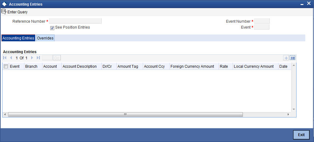

Click on ‘Accounting Entries’ button to view the accounting entries for the event that is highlighted. Click ‘Message’ button to view the messages applicable to the event. Click on ‘Exit’ button to go back to the ’Event Details’ screen.
From ‘Event Details’ screen, click ’Accounting Entries’ button to view the Accounting Entries for the event.The accounting entries that are passed depends on the type of Islamic LC contract that you are processing.
The following information is provided for each event:
Click ‘Exit’ button to go back to the screen from where you invoked the ‘Accounting Entries’ screen.

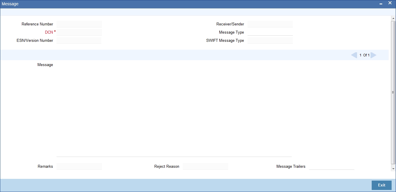

Click ‘Message’ button from the ’Event Details’ screen to view the list of advices applicable to a particular event in the lifecycle of Islamic LC.
The following details of a message are displayed:
To view the text of a message, highlight the message and click on the ‘Message Details’ button. Click ‘Exit’ button to exit the screen.

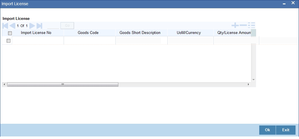

You can link the import license to an import Islamic LC contract and update the utilization amount or quantity for the linked import licenses. Click on ‘Import License’ to invoke the import license screen.
Import License No
Select the import license number from the adjoining option list.
Goods Code
Select the goods code from the adjoining option list.
Goods Short description
The system displays the goods code description maintained in the ‘Bills and Collections Commodity Code Maintenance’ screen.
UoM/Currency
The system displays the unit of measurement or currency captured for the goods code of import license.
Qty/License Amount
The system displays the Quantity or License Amount captured for the goods code of import license.
Qty/License Amt Already Utilized
The system displays the sum total of Quantity or License Amount already utilized for the goods code.
Qty/License Amt Already Reinstated
The system displays the sum total of Quantity or License Amount already reinstated for the goods code.
Available Qty/License Amt
The system displays either the Available Quantity or Available License Amount for the goods code.
Qty/License Amt Utilized
Specify the quantity or the license amount utilized.
Qty/License Amt Reinstated
Specify the quantity or the license amount reinstated.
After authorization, you cannot modify or delete import licenses linked to an Islamic LC contract.
The system allows utilization details only for an import license linked to an Islamic import LC contract. The system displays an error message if reinstatement details are specified.
The utilization maintained for an import license is updated on save of an amendment capture. Subsequently if the amendment is marked as 'rejected', then the system automatically reinstates the utilization captured.
If reinstatement details are captured for an import license, then the same should be captured while marking the amendment status as confirmed. During status marking, the system displays the Islamic import LC contract information in the Islamic LC Contract Input screen and the Import License sub-system in the screen can be accessed for input of reinstatement details. The system displays an empty Import License sub screen where the user can input or add new rows to reinstate.
When a reduction in Islamic LC amount is performed as an amendment for an Islamic import LC contract with import licenses, then the system will validate whether reinstatement details are entered for the linked import licenses. If not, the system displays an override message as “Reinstatement details are not entered”.
When a utilization for an import license is already entered as part of an amendment capture and if utilization details are captured again while marking the amendment status as 'confirmed' in Islamic LC Contract screen, the system displays an override message as “Utilization is already marked as a part of amendment capture”.

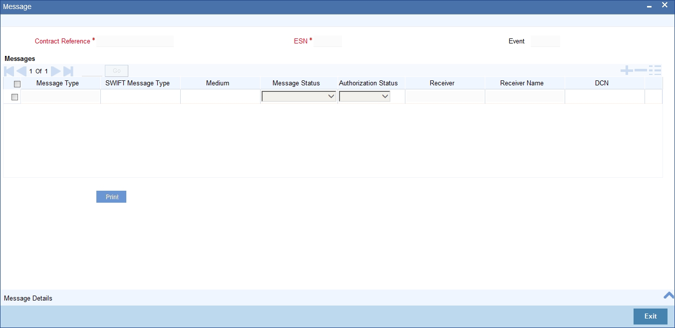

You can preview the messages or advices that will be generated for the contract using ‘Message Preview’ screen. To invoke this screen, click ‘Message Preview’ button.
For the contract, you can view the following details of the messages:
You cannot preview the message if the contract has been authorized. The ‘Message Preview’ button will be disabled in that case.
Select a message/ advice and click ‘View’ button to view the complete message/advice. The system will display the following details in a new window.
You can view the following details:
From the ‘Message Preview’ screen, you can print a message/advice using ‘Print’ button. Select the message/advice and click ‘Print’ button to print the message/advice.

Once the confirmation is saved on the amendment screen, the Islamic LC contract online screen is launched with the data modified, and this can be unlocked and modified, or closed as chosen by the user. These changes are directly made by launching the Islamic LC contract screen. However the amendment can only be deleted by using the amendment screen as described above.
The following Islamic LC contract screen is launched when the amendment is confirmed in the Islamic LC amendment confirmation input screen.
The amendment cannot be deleted using the Islamic LC contract screen, and can only be deleted using the amendment screen as part of the confirmation. This is done by deleting the confirmation using the amendment screen.
Hence the process is carried out as follows:
During an auto authorization of Amendment Confirmation, the amendment created by this confirmation is also authorized
Your supervisor now needs authorize the confirmation to view the changes made. The steps to authorize are given below:
Note
You can delete the amendment if the ‘Amnd Status’ of the contract is ‘Confirmed’ but unauthorized.
To reject the amendment details, do the following:
Your supervisor now needs authorize the rejection. The steps to authorize are given below:
Note
You can amend the same contract several times in ‘Amendment Confirmation’ screen as long as the amendment is not authorized.
You can view the summary of islamic LC amendment details through ‘Islamic LC Amendment Confirmation Summary’ screen. To invoke this screen, type ‘LISAMEND’ in the field at the top right corner of the application toolbar and click the adjoining arrow button.
You can search for the records based on one or more of the following parameters:
Once you have specified the parameters, click ‘Search’ button. The system displays the following details of all records that match the search criteria.
