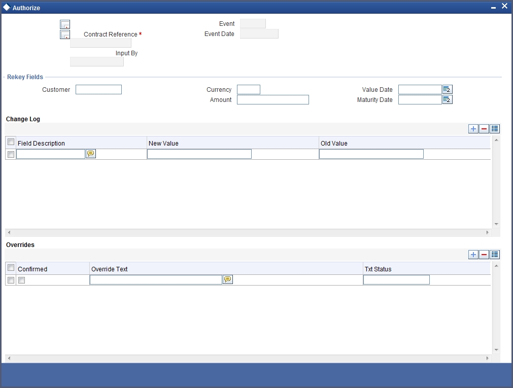

To authorize the value dated changes; you have to invoke the authorization screen by selecting ‘Authorise’ option in the Application toolbar.
If the contract involves a product for which some Re-key fields have been defined, the details of the contract will be displayed only after you input the values in those fields. If no Re-key fields have been defined, the details of the contract will be displayed in the ‘Authorization’ screen.
All the overrides that were given during the operation will be displayed when the contract is being authorized.
If you are authorizing an amendment, the old values are replaced by the amended values, which will be available for subsequent processing.
The old values, however, will still be available in an earlier version of the contract. Click on ‘Ok’ button to authorize the contract. Click on ‘Exit’ button if you do not want to authorize the contract.
After the contract has been authorized, the accounting entries passed during this stage will also be marked as authorized and advises, if any have been specified for the operation, will be generated.
