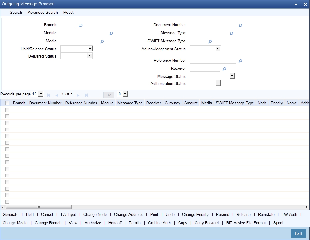

7.1.1 Generating Messages from Outgoing Browser
If the background message process is not running, all the messages that are triggered for generation will be displayed in the Outgoing Message Browser from where you can generate the message.
You can generate messages from the Outgoing Browser at any time in the day. You can invoke the ‘Outgoing Message Browser Summary’ screen by typing ‘MSSOUTBR’ in the field at the top right corner of the Application tool bar and clicking on the adjoining arrow button.
Viewing Outgoing Messages
You can view features of the outgoing messages based on any of the following criteria.
Click ‘Search’ button. The system identifies all outgoing messages satisfying the specified criteria and displays the following details for each outgoing message:

7.1.2 Performing Operations on an Outgoing Message
The operations that you can perform on an outgoing message are determined by the rights that you are assigned with, at Security Management System (SMS) level. If a function in the Outgoing Browser is disabled, then the function is not allowed for the record.
Check the box against the message(s) for which you need to perform an operation and then click the corresponding operation. The action performed will require authorization, if maintained at the Messaging Branch Preferences level.
The following operations can be performed on the outgoing messages:
Generate
Click to generate an outgoing message. You can generate un-generated and repaired messages.
When you click ‘Generate’, the system checks the contract status for which the message is generated and will not generate a message in the following condition:
Hold
Click if you need to temporarily stop generating an outgoing message. Authorizing Supervisor can view details and then release the messages or change their status to Carry Forward, which in turn can be released on further authorization.
Note
Messages with Hold status must either be carried forward or released, before you execute the EOD processes at the branch; else the system displays an error message. However, if the message is cancelled, then the system will not display error message, though the status is ‘Hold’.
Cancel
Click if you need to cancel an outgoing message. You can cancel messages with ‘Un-generated’ and ‘Hold’ status.
TW Input
Click if you need to input testword for Telex messages which were moved to ‘Repair’ status.
Change Node
Click if you need to change the node from which an outgoing message is generated.
In a distributed environment, the database of one or more branches of your bank will be located at a node or a server. Hence a Media Control System will be installed and defined specifying the node at which it is installed.
When you click ‘Node’, the system displays the details of the individual message providing an option to change the ‘Node’. Select the node you need to change from the adjoining option list.
Note
MCS status at the node in which the database of your bank is installed should be passive.
Change Address
Click if you need to change the address to which an outgoing message has to be sent. Enter the new address to which the message should be sent and click ’OK’ to save.
Note
Change of address can be done only before a message is generated.
Print/Spool
Click if you need to print an outgoing message. When you click ‘Print’, option will be provided to select spool or print on-line.
Messages that are transmitted through mail and those cancelled should be printed. You can also choose to print the details of messages transmitted through other media types.
The system provides an option to spool the advices in PDF format. When you click the ‘Print/Spool’ button, you can view the selected advice in PDF file. You can also view the SWIFT tag description.
Undo
Click if you need to reverse the last action you performed on an outgoing message at ‘Outgoing Messages Browser’ level
Change Priority
Click if you need to change the priority, for sending a payment message which is yet to be generated.
Note
In the Background, Oracle FLEXCUBE generates messages on the priority basis.
Resend
Click if you need to regenerate and resend a message which was generated and sent.
Release
Click if you need to release a message which is on hold.
Reinstate
Click if you need to reinstate cancelled outgoing messages.
TW Auth
Click if you are provided rights to authorize testword entered for a Telex message. While authorizing you have to reenter the testword.
Change Media
Click if you need to change the media through which a message is transmitted, before it would be generated. Media of transmission of a message is changed if there is a failure of the medium at the recipient’s end.
Note
The selected media through which a message is transmitted should be available to the re­cipient.
Change Branch
Click if you need to send an outgoing message from another branch. Select the branch to which the message needs to be moved from the adjoining option list.
You change the branch of a message for the following reasons:
View
Click if you need to view the contents of a generated outgoing message. Viewing multiple messages is not supported.
Authorize
Click to authorize, if you are provided authorization rights for an operation at the Messaging Branch Preferences level. Messages should be authorized before sending them.
HandOff
Click if you need to hand-off a generated message to MCS to save the date in an ASCII format.
Details
Click if you need to view the details of a generated outgoing message. Viewing details of multiple messages is not supported
On-line Auth
Click to authorize online, if you are provided online authorization rights for an operation at the Messaging Branch Preferences level. Messages should be authorized before sending them.
Copy
Click if you need to send a copy of an outgoing message to another customer involved in a contract. You will provide the following to options:
Carry Forward
Click if you need to Carry Forward an outgoing message which is on ‘Hold’ for subsequent days.
Note
Messages which have been Carried Forward can be put back on Hold.
BIP Advice
Click if you need to generate advice in PDF format.
Note
You can generate BIP advice messages for Branch advices by maintaining ‘BRANCH_ADV_TYPE’ as ‘BIP’. Generation of these BIP advices is similar to ‘Host’ advices.
Note
If an advice is not generated, then the system generates, spools, and moves it to the client work station.

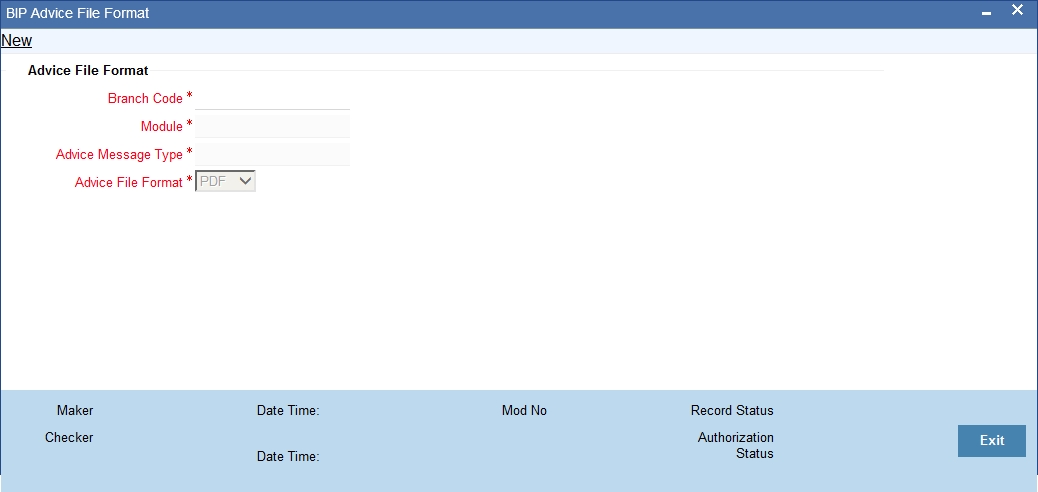

7.2.1 Maintaining BIP Advice File Format
You can maintain BIP advice file format using BIP Advice File Format screen. You can invoke the ‘BIP Advice File Format’ screen by typing ‘MSDADFTP’ in the field at the top right corner of the Application tool bar and clicking on the adjoining arrow button.
The screen is as shown below:
You can maintain the following parameters here:
Branch Code
Specify branch code for which you need to maintain BIP advice file format, from the adjoining option list
Module
Advice Message Type
Specify advice message type of the BIP advice file format, from the adjoining option list.
Advice File Format
Select a valid file format in which you would prefer to generate the BIP message, from the adjoining drop-down list. This list displays the following:

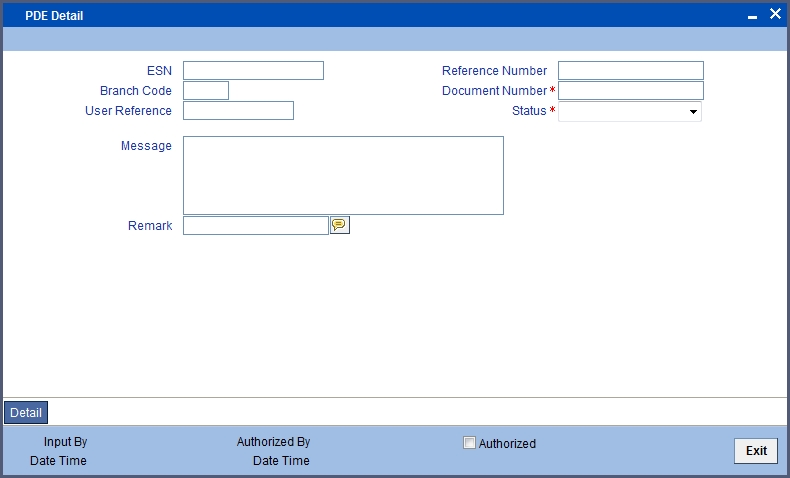

System identifies outgoing messages with a PDE (Possible Duplicate Emission) trailer and parks it in the PDE queue. From the PDE queue you can opt to either release the message with/without the PDE trailer or reject the message. You can release or reject an outgoing message with a PDE Trailer using the PDE Detailed screen. You can invoke the ‘PDE Detailed’ screen by typing ‘MSDETPDE’ in the field at the top right corner of the Application tool bar and clicking on the adjoining arrow button.
The following details of the message are displayed in the above screen:
You need to capture the following information in the above screen:
Status
Select the status of the message from the drop-down list. The options available are:
In order to view the details of the record click ‘Detail’ button. The details of the record are displayed in the ‘PDE Detail’ screen.
The following details of the message are displayed:

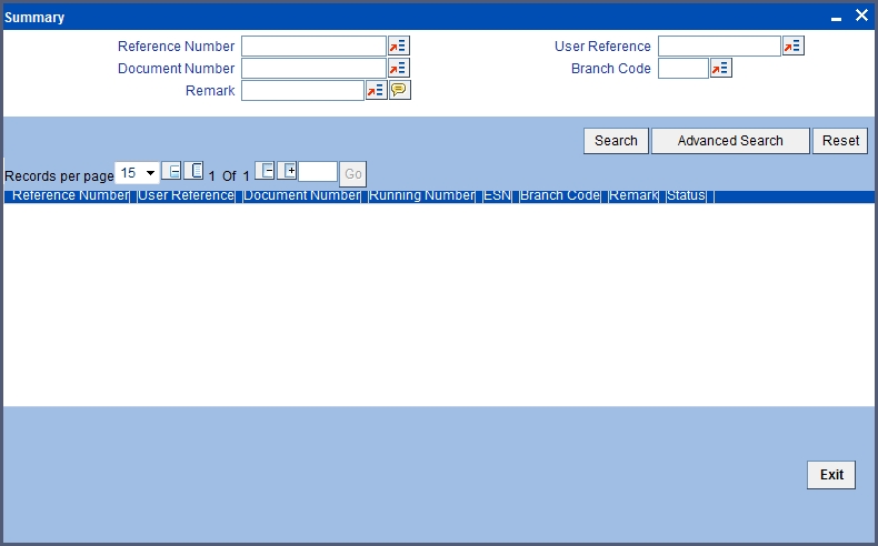

You can view all the PDE messages parked in the PDE queue using the ‘PDE Summary’ screen. You can invoke the PDE Summary screen by typing ‘MSSETPDE’ in the field at the top right corner of the Application tool bar and clicking on the adjoining arrow button.
In the above screen you can query for a record based on any of the following parameters:
Based on the query, the following details of the record which match the query parameter are displayed:
In order to view the details of each record select the record and click ‘Detail’ button. The details of the selected record are displayed in the ‘PDE Detail’ screen.
For more details on PDE validations on outgoing messages refer section ‘Performing PDE Validations on SWIFT Messages’ in ‘Maintaining Messaging Branch Preferences’ chapter of this User Manual
