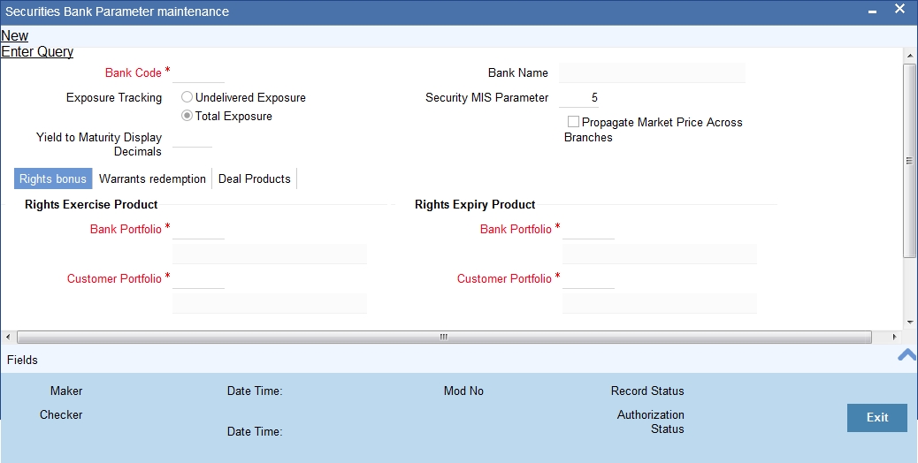

In the Securities Bank Parameters screen, you maintain certain basic information regarding the processing of Auto Deals.
You can invoke the ‘Securities Bank Parameters Maintenance’ screen by typing ‘SEDXBNPM’ in the field at the top right corner of the Application tool bar and clicking on the adjoining arrow button.
If you are calling a record that has already been created, click on Summary view. From the Summary screen you can open an existing record. Highlight the record you wish to view and double click on it. The details of the bank parameter record will be displayed in a tabular form.
Security MIS parameter
In Oracle FLEXCUBE, a maximum of 10 transaction classes can be maintained for a security and portfolio.
By specifying the security MIS parameter, you can indicate how the MIS transaction classes for a security position (Portfolio plus Security combination), is built from the respective transaction classes of the security and portfolio.
The number that you enter in this field denotes the number of MIS transaction classes of the security that should be picked up, to determine the MIS transaction of the security position.
Year to Month Display Decimals
The YTM values, which you can view through the Yield to Maturity details sub-screen of the Deal Online screen, are rounded off to the number of decimal places that you specify in this screen.
You can indicate the deal combination product code, which should be picked up, in case of declaration of one of the following:
Deal combination product codes are maintained in the Deal Combination Product definition screen. All the product codes defined in that screen will be reflected in the picklist available. The attributes defined for a particular deal combination product, will be inherited by the auto deal to which it is linked. The parameters maintained in this screen are applicable across the bank.
Specifying Banker’s Acceptance for a Placement/Loan Product
If you wish to process Banker’s Acceptances in your bank, then you must indicate the Loan/MM product, under which loan contracts or money market placements are to be created whenever you process a Banker’s Acceptance deal.
In a Banker’s Acceptance deal, you fund the issuer of a security by creating a loan or a money market placement.
Select from the list of values containing all open and authorized Loan / MM products, which satisfy the following conditions:
Refer to the Deal Online chapter of this User Manual for details on processing Banker’s Acceptances.
For your bank you can specify whether the yield computation for securities should be based on Nominal Cash Flows or Face value (per unit). You can maintain this parameter in the CSTB_PARAM (Bank Level Parameters) table. Maintain the parameter COMMON_YLD_ACCR as ‘Y’.
Once this parameter is maintained as Y, the system will compute the yield and NPV for Bonds and T Bills using Nominal based cash flows.
Subsequently, the system triggers the Yield accrual event YACR. The value passed for the event YACR is inclusive of the discount/premium accrual for the deal and the events ACRD and ACRP will not be passed separately.
To compute yield using nominal based cash flows, the following validations are performed in the system:

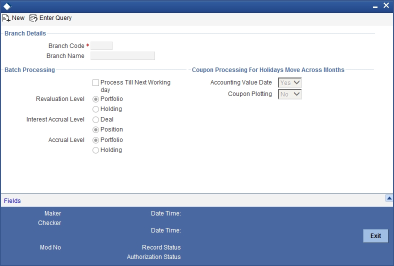

A set of rules that governs the processing of securities in a particular branch of your bank, is defined in the Branch Parameters screen.
You can invoke the ‘Securities Branch Parameters’ screen by typing ‘SEDXBRPM’ in the field at the top right corner of the Application tool bar and clicking on the adjoining arrow button.
The events, for which you had indicated automatic processing, are triggered off during the Batch Process. You can specify preferences for the automatic events that fall on a holiday, in the Branch Parameters screen.
You have the option to specify when the batch process, should process automatic events falling due on a holiday. It could be either:
Revaluation entries can be passed at the portfolio level or at the holding level.
For example, consider the following securities held in a portfolio at your bank:
| Portfolio | Security ID | ||
| PF1 | SE01 | ||
| PF1 | SE02 | ||
| PF1 | SE03 | ||
| PF1 | SE04 |
The security currency for SE01, SE02 and SE03 is USD. The security currency for SE04 is GBP.
If you indicate that revaluation should be passed at the holdings level, entries will be passes exclusively for the following combinations:
If you specify that entries should be passed at the portfolio level, then the revaluation entries will be made in the following manner:
PF1 + SE01 + SE02 + SE03
PF1 + SE04
Note
If you indicate that revaluation should be performed at the Holdings level, you have the option of selecting between Deal level revaluation and Position level revaluation while defining a portfolio.
See the ‘Maintaining a Portfolio Preference class’ chapter of this User Manual for more details.
Specifying the Accrual level
In the Security Definition screen, you can define whether a coupon payment falling due on a holiday should be shifted backward or forward. In the Securities Branch Parameters screen, you can specify if such a forward/backward shift shall be allowed when it involves a movement across months. In the Coupon Plotting field in the Holiday Treatment – Move Across Months area, you have to select either ‘Yes’ or ‘No’ accordingly.
Interest calculations and accruals are done till the coupon event date. However, if the coupon event date is a holiday, the accounting entries are processed as part of the batch process on the next working day or the previous working day, depending upon your specification. Select ‘Yes’ or ‘No’ in the Accounting field in the Holiday Treatment – Move Across Months area.
If the coupon plotting date itself has moved to a working day, then this field becomes irrelevant.
Note
For both Coupon Details and Accounting Value Date, if movement across months is allowed, then such movement takes place (subject to necessity and as per other preferences maintained) even if this entails a movement across accounting periods or across financial years.
You can opt to accrue interest at a position level or at a deal level.
Interest accrual at deal level is for Bank Portfolios only.
Deal Level Interest Accrual
The interest accrual process pickups all the settled buy deals and pass accrual entries for each of them.
The deal level interest accrual will be done only for portfolios with the following costing methods:
Deal level interest accrual cannot be done for portfolios with Weighted Average Costing (WAC) method since it would not be possible to determine the deals for which interest accrual should be stopped.
Consider the following example.
The following buy deals for ’1year EURODOLLAR Bonds’ (S1) have been struck for the Trading Portfolio (P1):
| Leg Ref. No | Purchase date | Deal | No of units | ||||||||||||
| Deal 1 (D1) | Deal 2 (D2) | Deal 3 (D3) | 1st January | 2nd January | 5th January | Buy | Buy | Sell | 10 | 15 | 12 |
If P1 were maintained as a WAC portfolio, it would not be known from which deal the 12 units of ‘10-Year RBI Bond’ are being sold. It could be 6 units each from D1 and D2 or 12 units entirely from D2. Therefore, for WAC portfolios, interest accrual will be done at the position level rather than at individual deal level.
However, if P1 were of type FIFO, it would be easy to determine that the 12 units that are sold comprise of 10 units from D1 and 2 from D2. Therefore, once the sell deal, D3 is settled, interest accrual will be stopped for D1 as all the 10 units are sold. For D2, interest accrual will happen for the remaining units (i.e. 15 – 2 = 13).
Revaluation
Though interest accrual occurs at deal level, the revaluation (REVL) entries will continue to be posted at the position level. The revaluation process will compare the current book value (cost of assets in your books) with the book value at the market place.

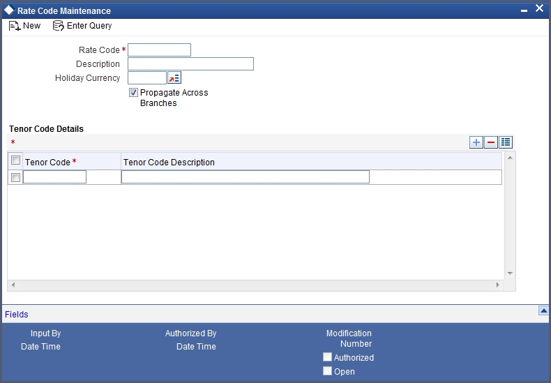

You can define rate codes using the ‘Rate Code Maintenance’ screen. You can invoke this screen by typing ‘CFDRTCD’ in the field at the top right corner of the Application tool bar and clicking the adjoining arrow button.
You can enter the following details:
Rate Code
Enter a code to identify the rate you are defining. You can associate several currencies to the rate code and specify rates for each currency. While processing a contract, you need to indicate this code to make the rate applicable to the contract. The code cannot exceed 10 characters.
Description
Enter a brief description to identify the rate code being defined.
Holiday Currency
Specify the holiday currency for this rate code. You can choose the appropriate one from the adjoining option list that displays all valid currency codes maintained in the system.
Propagate Across Branches
Check this option to indicate that the rate code should be available across all branches.
Here you need to indicate the following:
Tenor Code
Specify a unique code to identify the tenor for which this rate code should be applicable.
Tenor Code Description
Enter a brief description for the tenor code.
You can add multiple tenor codes for the rate code by clicking the add row button. Similarly, you can delete a tenor code by selecting the desired row and then clicking delete row button.
In order to process MT340, MT360 and MT361 you need to maintain the following rate codes:

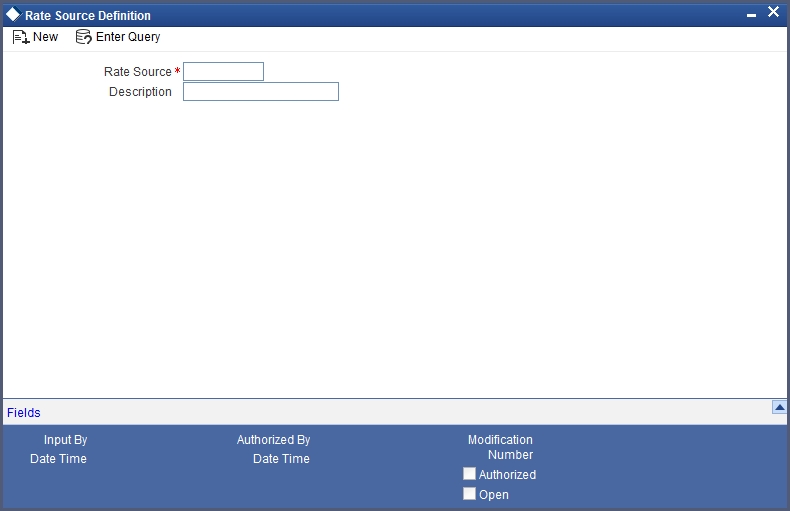

You can maintain rate sources using the ‘Rate Source Definition’ screen. You can invoke this screen by typing ‘CFDRTSRC’ in the field at the top right corner of the Application tool bar and clicking the adjoining arrow button.
Here you can capture the following details:
Rate Source
Specify a unique code to identify the rate source you wish to maintain. The code cannot exceed 10 characters.
Description
Enter a brief description for the rate source.
In order to process MT340, MT 360 and MT361you need to maintain the following rate sources:

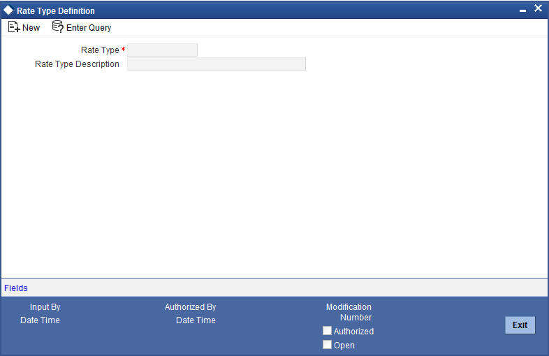

You can maintain rate types using the ‘Rate Type Definition’ screen. You can invoke this screen by typing ‘CFDRTTYP’ in the field at the top right corner of the Application tool bar and clicking the adjoining arrow button.
Rate Type
Specify a unique code to identify the rate type you wish to maintain. The code cannot exceed 10 characters.
Description
Enter a brief description for the rate type.

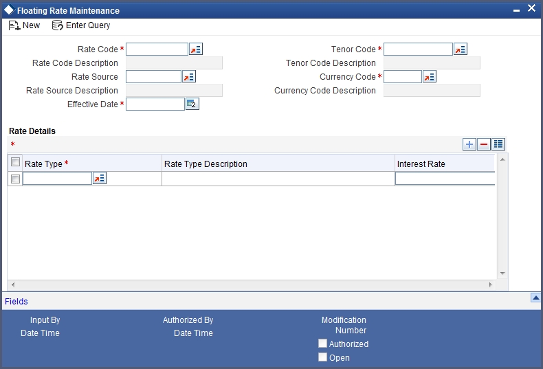

You can maintain floating rates using the ‘Floating Rate Maintenance’ screen. You can invoke this screen by typing ‘CFDFLRAT’ in the field at the top right corner of the Application tool bar and clicking the adjoining arrow button.
Rate Code
Select the Appropriate Rate Code from the List of Values Available.
Rate Source
Select the Appropriate Rate Source from the List of Values Available.
Tenor Code
Select the Tenor Code created as part of Rate Code Maintenance from the List of Values Available.
Currency Code
Select the Currency Code from the List of Values Available for which the Interest Rates are to be maintained.
Rate Details
Update the Interest Rate by adding the required rate types maintained and providing the Interest rates pertaining to the particular rate type selected.

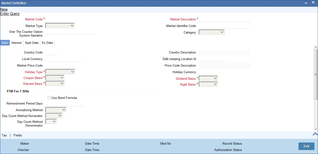

It is necessary to maintain certain standard details, relating to the markets where securities are traded. The information relates to issues such as the interest calculation method, the relevant spot and ex-dates and the default safe keeping location.
Only the Head Office of your bank can define and maintain market place related details. The other branches of your bank can refer to these details, every time a security is processed.
The advantage of defining market place details is that at the time of defining a security, you only need to specify the code assigned to the market. All the details maintained for the particular market will be automatically picked up.
You can invoke the ‘Market Definition’ screen by typing ‘SEDXMTCD’ in the field at the top right corner of the Application tool bar and clicking on the adjoining arrow button.
If you are maintaining details of a new market place choose New from the Actions Menu or click on new icon from the tool bar. The Market Definition detailed screen will be displayed.
If you are calling a market place maintenance record that has already been defined, choose the Summary option under Market Codes. From the Summary screen double click a record of your choice to open it.
Prior to maintaining, the interest calculation method and the relevant spot and ex dates etc., certain basic details about the market place need to be maintained.
Country Code
You need to specify the country to which the market belongs.
Local Currency
You need to specify the local currency of the country in which the market is situated.
Safe Keeping Location Id
The Safe Keeping location to and from which the securities will be delivered.
Price Code
You need to specify the price code from which the security price is to be picked up for this market.
All the details maintained here are picked up and defaulted to the Securities Definition screen. You are allowed to change the information, at the time of defining securities.
Apart from the other ‘main’ details you can specify the Yield Calculation Parameters for Bonds and T-bills for each market definition record that you maintain.
YTM method for T-Bills

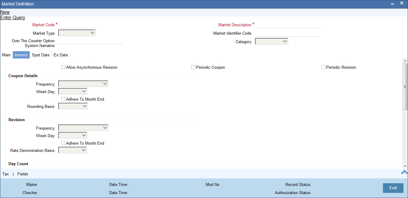

Click on the Interest tab to maintain interest related details.
The details maintained here are specific to the interest calculation methods, applied during accruals and liquidation.
It is not necessary to specify, the same day count method for calculating interest on accruals as well as on liquidation. The system allows you to specify two different day count methods for calculating interest, one for accruals and the other for liquidation.
The following combinations are allowed for calculating interest:
| Actual / Actual | The Actual number of days in the period/ The Actual number of days in that year. | Click on Actuals in Numerator Method field, click on Actuals in ‘Denominator Method’ field. | |||||
| Actual / 365 | The number of actual calendar days for which calculation is done / 365 days in a year. | Click on Actuals in Numerator Method field; click on 365 days in Denominator Method field. | |||||
| Actual / 365 – Japanese | This is similar to the Actual/365 method except that leap days are always ignored, in the numerator day count calculation. | Click on Actual Japanese in Numerator Method field; click on 365 in Denominator Method field. | |||||
| Actual / 365 – ISDA | Sum of (A) and (B) where: | A = Interest accrual days falling within the leap year / 366 | B = Interest accrual Days not falling within the leap year/ 365 | The denominator is the actual number of days in a year. | Click on 365 ISDA in Numerator Method field; click on Actual in Denominator Method field. | ||
| Actual / 360 | The actual number of calendar days for which calculation is done / 360 days. | Click on Actual in Numerator Method field; click on 360 in ‘Denominator Method’ field. |
Denominator Method
Select the denominator method from the adjoining drop-down list. This list displays the following values:
This section contains the following topics
Apart from the above-mentioned method for calculating the interest, you can also use the ACT/ACT–ISMA Interest Method and ACT/ACT–FRF Interest Method.
The ACT/ACT–FRF Interest Method is applied for periodic coupons using the following coupon:
Coupon Interest = Nominal x (Coupon Rate/Number of Coupons) x (Number of elapsed Days/ Number of days in coupon period)

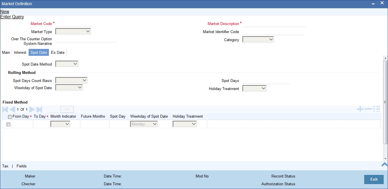

In this section, you have to indicate the method by which Spot Date is calculated. Spot date is calculated to keep a track of deal settlements. You can click on the respective tab to go to this section of the screen.
There are two methods for calculating the spot-date. It can be calculated as a certain number of days from the trade date of the security. It can also be fixed for a market place for a specific range of trade dates.
Rolling
If the spot date calculation method indicated is rolling, then you can specify the spot day count basis.
Spot Day Count Basis
There are two options available for this field:
Weekday of Spot Date
You can indicate your preference of weekday for the spot date if you have specified the calculation method as rolling.
If the weekday of the spot date computed, is different from the preferred weekday then, the spot date computed will be moved forward to the preferred weekday.
Holiday Treatment
Once you indicate a preferred weekday for the spot date, you are required to specify the holiday treatment for the preferred weekday. If you choose to ignore this option, the spot date will be retained on the holiday. If not, as specified by you, it will be moved forward to the next working day or moved backward to the previous working day.
When the spot day method specified is Fixed, indicate the details relating to the range of trade dates and the corresponding spot date for each slab. You also have to specify whether the spot date lies in the current month or in a future month. You can select the relevant option from the picklist available for the month indicator.

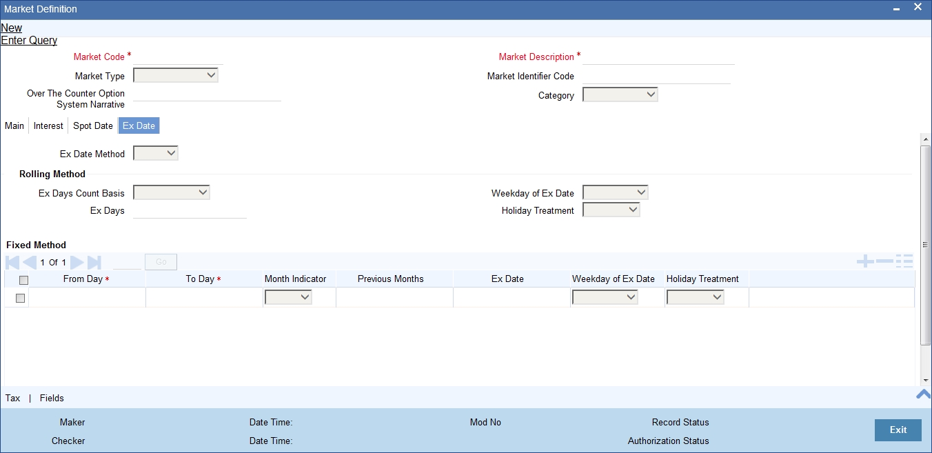

The Ex date referred to here, is the same as the Record date. You need to specify the ex date to keep a track of corporate events for securities that are using this market place as the default market. Click on the Ex Date tab, to go to this section of the screen.
There are different methods for calculating the ex date. It can be calculated as a certain number of ex days, prior to the next coupon date of the security or it can be fixed for a market place for a specific period.
Expiry Date Method
If the expiry date calculation method indicated, is rolling then you can specify the expiry date count basis.
Expiry Days Count Basis
You can express the expiry days as calendar days or as weekdays.
Weekday of Expiry Date
You can also specify your preference of the weekday for the ex date. The concept of weekday, of the ex date and of the holiday treatment, is the same as that of Spot date.
If the ex date specified is fixed then you need to maintain certain mandatory details such as the From and To dates, the month indicator and the holiday treatment. The information that you maintain here, is similar to the information entered for the spot date. This is so only if the spot date method specified, is fixed. However in such a case, the ex date will be prior to the event date.
With every market place that you define you can associate a Tax scheme. When you specify the market code, at the time of defining a security, the details of the tax scheme associated with the market code are automatically associated with the security.
Note
At the market definition level you can only maintain the Issuer tax details. You can however change these details at the security definition level.
To invoke this screen, click ‘Tax’ button in the Market Definition screen. The Tax Definition screen will be displayed.
To associate a tax scheme with an issuer class, click ‘Default From Class’ button. The Default from Class screen will be displayed. In it are available a list of tax classes specific to the Securities module. Select the tax scheme to be associated with the issuer tax. All the components linked to the particular scheme, will be associated with the market code you are defining.
To change the tax scheme which has already been linked to a market code, in the Market Definition screen, click on the unlock button in the toolbar.
The tax components linked to a tax scheme will be automatically applied to all deals involving the security associated with the particular market code. However if you want to stop applying one or more of these components to new contracts that are initiated, you can do so by checking the Stop Association field.
Stopping the application, of a tax component for a market code would be equivalent to deleting the component for all deals involving the security. However you have the option of using the definition made for the component, once again. To do so, uncheck this field. Deals that are subsequently input, will pick up the components.
Note
Entry to certain fields in the Market Definition screen is mandatory. If you try to save the record without inputs to all these fields, the record will not be saved. You will be prompted to give all the mandatory inputs before attempting to save it again.
