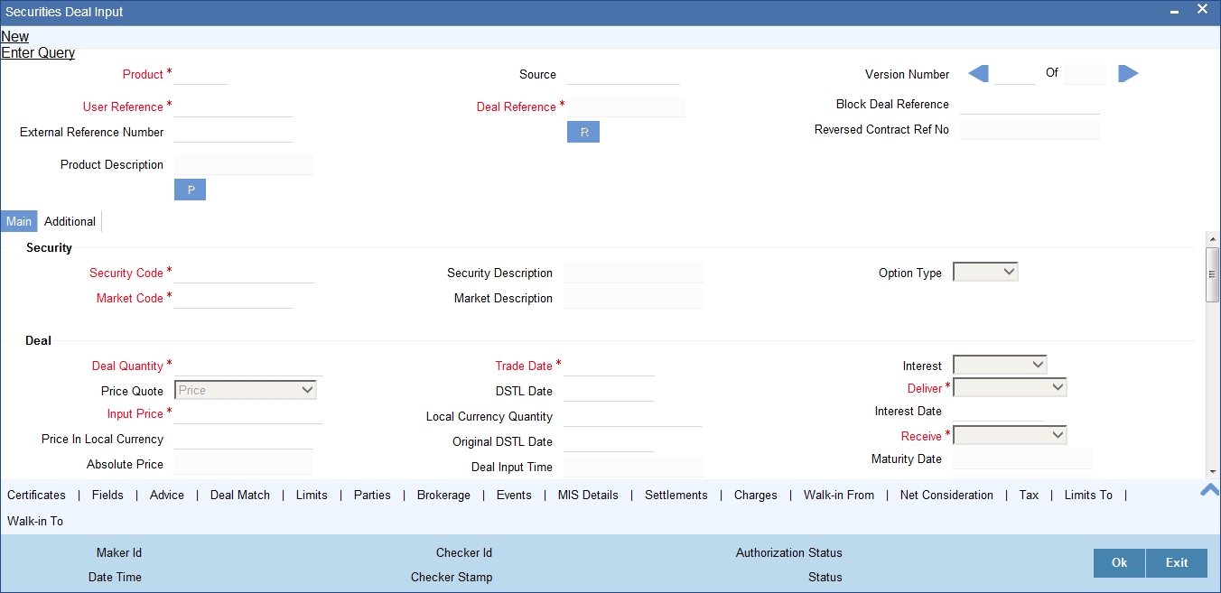

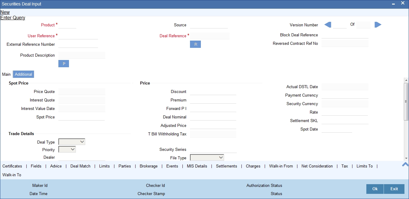

You can invoke the Securities Deal Input screen from the Application Browser. To enter the details of a new deal click new icon from the tool bar.
You can invoke the ‘Securities Deal Input’ screen by typing ‘SEDXDLNL’ in the field at the top right corner of the Application tool bar and clicking on the adjoining arrow button.
If you are calling a deal that has already been created, choose the Deal Input Summary option. The details of all the deals that you entered earlier will be displayed in a tabular form. From the summary screen, you can open an existing deal by double clicking it.
The securities deal input screen, as it appears contains a header and a footer containing fields that are specific to the deal you are entering. Besides these, you will also notice two tabs and an array of icons along the lines of which you can enter details of a securities deal.
The two tabs are:
‘Main’ | Click this tab to enter the essential terms of a deal. This screen, along with its fields has been detailed under the head ‘Entering the details of a deal’. | ||||
‘Additional’ | In the screen that corresponds to this tab, you can enter additional details that are required to process the deal. | The screen also displays price-related details, calculated on the basis of the amounts that you specified in the Main screen. | The features of this screen have been detailed under the head ‘Entering additional details of a deal’. |
On the Securities Deal Input screen you will also notice a toolbar with icons. The same set of icons is available for each leg of a deal. The buttons on this toolbar enable you to invoke a number of functions that are vital to processing a deal. These buttons have been briefly described below:

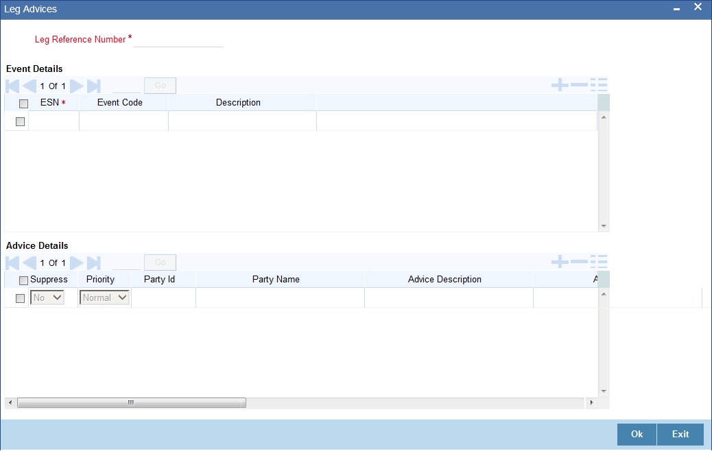

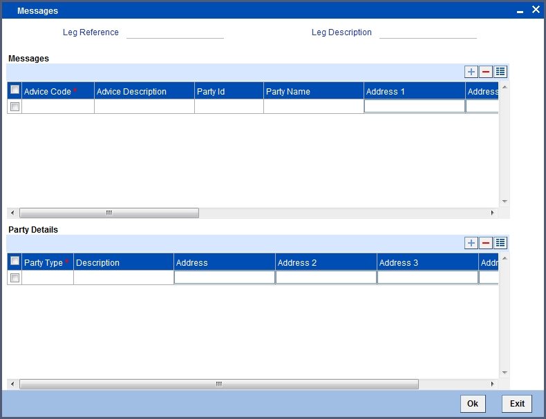

Advices | Click this icon to invoke the advices screen. In the screen corresponding to this icon you can view, suppress and prioritize the advices that are to be generated for each leg of the deal. This screen along with its fields has been detailed under the head ‘Specifying Advices for a deal'. | |||

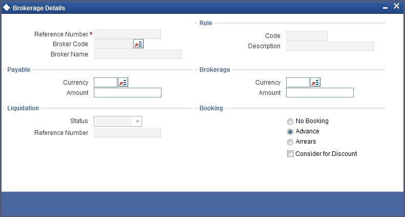

Brokerage | Click this icon to indicate brokerage details applicable to the deal leg. | |||

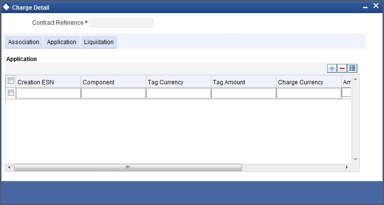

Charges | This button invokes the Charge service of Oracle FLEXCUBE. On invoking this function you will be presented with a screen where the charge rate, amount, currency, and the waive charge parameter can be specified. | The procedure for making charge components applicable to a deal leg is discussed under the head 'Levying charges on a deal'. | ||

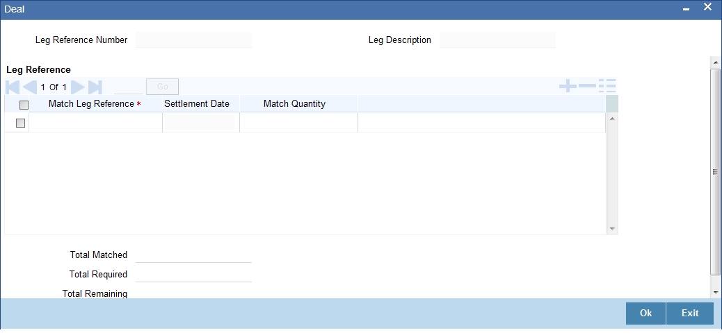

Deal Match | If you are trading in a portfolio that involves deal matching, you can indicate deal-matching preferences. | Click this button to match earlier buys in a portfolio, to the deal you are processing. | ||

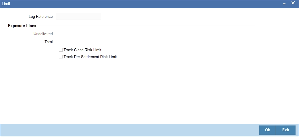

Limits | Click this icon to view the forward profit that you have made or the loss that you have incurred on account of the deal. | |||

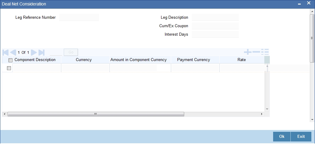

Netcons | Click this icon to view your net consideration in the deal. | |||

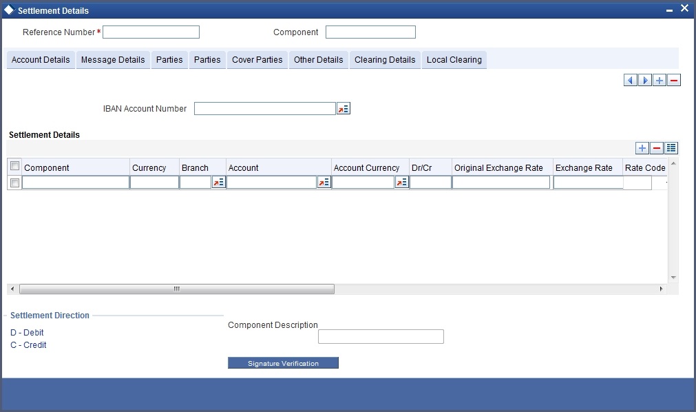

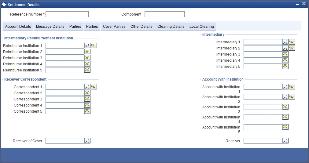

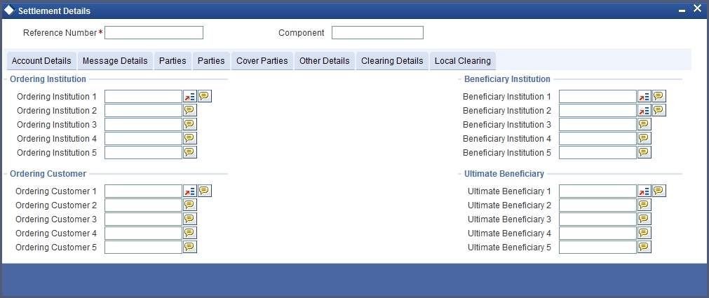

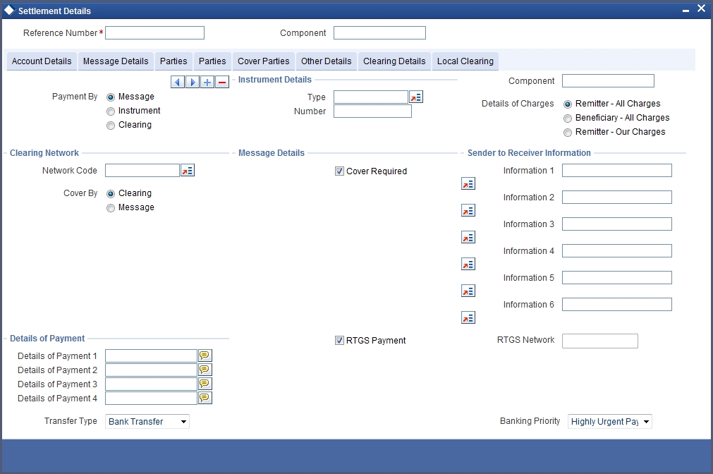

Settlements | Click this icon to invoke the settlement screens. Based on the details that you enter in the settlement screens, the deal will be settled. | The details of these screens have been discussed in the section titled ‘Maintaining Settlement Instructions’. | ||

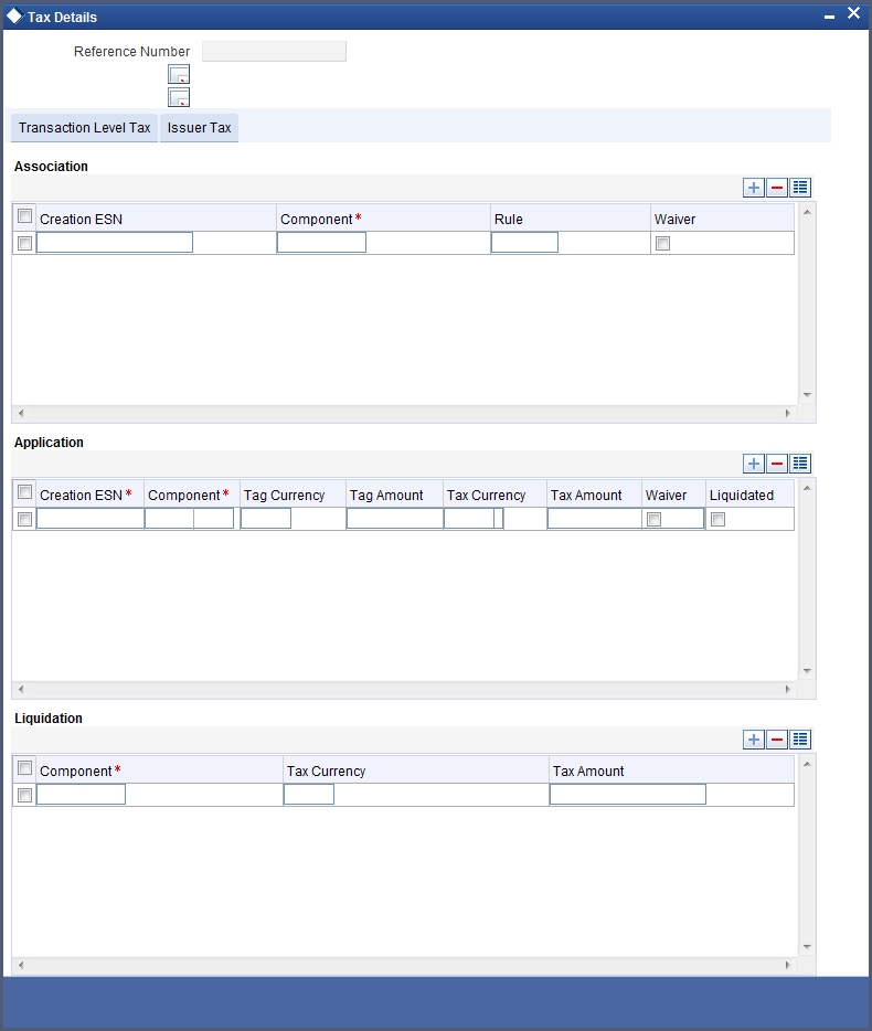

Tax | This icon invokes the Tax services. The application of tax on a deal is discussed under the head 'Levying tax on a deal'. |

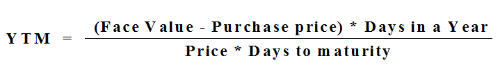

YTM - the price is quoted on the basis of its yield to maturity. This price quotation method is applicable only for Zero coupon bonds.
The yield on discounted instruments is measured by the yield to maturity (YTM) which is the return on a security bought at current market price for the remaining time to maturity of the security. The YTM would keep changing with the market price, in case the market price increases above the straight discounted price YTM would decrease and vice versa. The price using this quotation method is calculated thus:

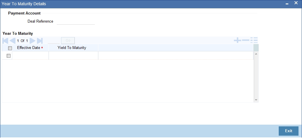

Viewing revised YTMs
Deal YTMs are computed for a security on the following occasions:
Event | YTM is computed Effective from | ||
When you enter the deal | Deal Settlement Date | ||
When coupon rates are revised for securities with periodic rate revision | Rate Effective Date | ||
When the redemption definition is changed | Event Date |
To view details of changes in YTM, click ‘D’ button . The Yield to Maturity details screen is displayed.
YTM values can change due to Coupon Rate Revision, Redemption redefinition or extension of a security.
The YTM values are rounded off to the number of decimal places specified in the Securities Bank Parameters screen.

For indexed securities, you can specify the number of units that are traded either in the index or local currency. If you express the deal quantity in the local currency, the equivalent in the index currency is displayed in the field titled Deal Quantity. Similarly, if you indicate the deal quantity in the index currency, it’s equivalent in the local currency is displayed in this field.
Maturity Date
This field is applicable only in case of Bonds or securities with a redemption date. This is automatically generated to reflect the maturity date of the security being traded.
Original DSTL Date
This is automatically generated by the system to reflect the original delivery settlement date as per the market code maintenance for Spot days. You can change the date by using the calendar menu.
Transaction Date
The transaction date is the date on which you entered the deal into Oracle FLEXCUBE. The system defaults the transaction date to today's date. Normally, the transaction date would be the same as the trade date of the deal. It would differ from the trade date if you enter a back valued deal.
Deal Input Time
This is system updated date and time stamp.
Quote By
This is the Quantity quotation method. Here you specify whether the Security quantity quoted above is in Units or in Nominal.

Indicating the broker
If you are processing a bank buy or bank sell deal that involves brokerage, you can indicate the ID of the broker through whom the deal was brokered. You can select a Broker ID from the picklist available. The picklist will contain a list of valid brokers with whom you can enter deals. On indicating the broker code, the name of the broker is also displayed.
You will be allowed to enter details of a broker only if brokerage was allowed for the product to which the deal is associated.

From the Securities Deal Input screen, click ‘Advices’ button. The advices screen is displayed. To recall, the advices that can be generated for the events that occur during the life-cycle of a deal are defined for the product to which the deal is associated.
The details of the advices applicable for an event are displayed in the Advices screen. The party type to whom a specific advice should be sent is picked up automatically based on the type of deal you are entering and the parties involved in the deal.
Choose the event for which you want to view advice details. .The address of the party who is the recipient of the message, will be picked up by default, based on the media and address maintenance for the party. You can change either of them.
For a payment message by SWIFT, you also have the option to change the priority of the message.
Suppressing the generation of an advice
By default, all the advices defined for a product will be generated for the deals involving it. If any of the advices are not applicable to the deal you are processing, you can suppress its generation.
Indicating the generation priority
For a payment message by SWIFT, you also have the option to change the priority with which the message should be generated. By default, the priority of all advices is marked as 'Normal'.
You have the option to prioritise a payment message to one of the following options:
Indicating the medium of generation
The medium through which an advice is transmitted and the corresponding address will be picked up based on the address and media maintained for the customer who is the recipient of the message.
You can, however, change either of these while processing a deal. Typically, if changed, both of them will be changed.

For each leg of the deal you can specify the charges that you levy. Charges are applicable only for customer legs of a deal (customer buys, customer sells, lodge, withdraw and block securities).
The characteristic feature of a charge is that it is always booked in advance and is not accrued, as a charge is collected only when it is due.
To recall, you have defined the attributes of a charge by defining a ‘Rule’. A rule identifies the basic nature of the charge. You have further defined a Charge class where you have enriched the attributes of a rule. We shall refer to these classes as 'components'.
Each charge component in turn is linked to a deal product. All the charge components linked to a product are defaulted to the deals associated with it. Thus each time you enter a deal, you need not specify when and how charges should be collected.
However, while capturing the details of a deal, you can choose to associate a component to the deal. Further, you can modify some of the attributes defined for the applicable component.
From the Securities Deal Input screen, click ‘Charges’ button - The Contract Charge Details screen is displayed.
The reference number of the deal leg for which you are defining charge details is displayed. The screen will contain a list of all the charge components applicable to the deal leg.
Associating a charge component to a deal leg
All the charge components applicable to the deal leg you are processing will be displayed together with the rule that is linked to the component.
In this section of the screen you can:
Changing the charge rule linked to a component
The rule that is linked to a charge component is displayed next to the component. To link a new rule to the component. A list of all the charge rules maintained will be displayed. Select the appropriate rule from the picklist. The new rule will be made applicable to the charge component.
Disassociating a charge component from the deal leg
You can disassociate a charge component from the deal leg. In the 'Association' section of the Contract Charge screen, click against the waive option positioned next to the component.
In this case, the charge component is attached to the deal leg but is not calculated.
Indicating the charge components to be applied to a deal leg
In the application section of the screen, you can indicate the charge components that should be applied to the deal leg. The list of components that is displayed depends on the charge components that you have associated to the deal leg.
The following details of the component are also displayed:
You can change the charge amount that is calculated using the class applicable to the component.
Waiving a charge on a deal leg
You also have the option to waive the component for the deal leg that you are processing. If, for some reason you want to waive the charge on the deal you are processing, you can do so by checking against the 'waiver' option in the application section of the screen. The charge will be calculated but not applied.
You can waive a charge only if it is yet to be liquidated.
Consider as Discount
If the charge component is to be considered for discount accrual on a constant yield basis, ‘Consider as Discount’ option will be checked. You cannot modify this value.
In case the charge currency is not equal to the contract currency and the contract currency is equal to the settlement account currency, the exchange rate as specified in the Settlements Screen will be used to convert Charge Amount to Contract Currency.

If the portfolio from which you are buying or selling involves deal matching, you should indicate against which of the earlier buy deals the sell deal is to be matched. Click ‘Deal Match’ button from the Securities Deal Input screen to match the sell leg of a deal to the buy leg. Click this button from the buy leg section of the screen to indicate the matching preferences and from the sell leg section to view the matched details.
For the sell leg
If you are processing the sell leg of securities deal, and if the portfolio from which you are selling involves the deal matching costing method, you should also match the sell leg to previous buys in the portfolio.
Procedure
Indicate the reference number of the buy deal, which you have selected for deal matching. In other words, indicate the buy deals done in the same security and portfolio to be matched with the sell leg of the deal. You can select a leg reference number from the picklist available.
On indicating the match leg reference, you should also indicate the number of units or nominal that should be matched. Click add icon to add the details of another buy leg to which you want to match the sell leg. Click delete icon to cancel a buy leg that you have mapped to the sell leg.
The summation displayed at the bottom of the screen contains the following information:
For the sell leg
While processing the sell leg of the deal, you can view details of the buy deals that have been matched to the sell leg. The reference number of the buy deal from which securities have been matched is displayed together with the number of units or nominal for which matching is done.

In Oracle FLEXCUBE, liability tracking is done using credit lines allotted to a customer. If you indicated that your exposure to the deal should be tracked, you can indicate the credit lines under which it should be tracked.
Click ‘Limits’ button from the Securities Deal Input screen, the Limits screen is displayed.
In this screen you can indicate the credit lines under which you want to track your:
Your undelivered risk arises only if you specified that the mode of security settlement for the deal is 'deliver free'. You can choose a credit line from the picklist available in this screen.
Click ‘Exit’ button to delete the entries. In either case you will be returned to the Securities Deal Input screen.

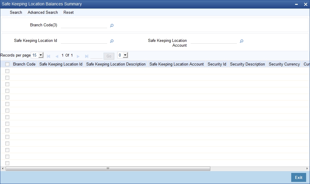

You can view the safe keeping location balances in the 'Safe Keeping Location Balances Summary' screen. You can invoke this screen by typing 'SESXSKBL' in the field at the top right corner of the Application tool bar and clicking on the adjoining arrow button.
In the above screen, you can base your queries on any or all of the following parameters and fetch records:
Select any or all of the above parameters for a query and click 'Search' button. The records meeting the selected criteria are displayed.
If you are allowed to query, then system displays the following details pertaining to the fetched records:
The sum of all the components of a deal is the net value of the deal. While processing a leg of a securities deal, you can view the net consideration of the deal.
Click ‘Netcons’ button from the Securities Deal Input screen. The deal net consideration screen is displayed.
From this screen, you can choose to view either the:
Viewing the Net consideration
The sum of the different components of a deal determines the net value of the deal. To recall while defining a charge or tax (transaction and issuer) component, you can indicate whether the charge or tax component should be taken into account, when determining the net value of a deal.
All other components of the deal like the interest, premium, discount, forward profit or loss etc will be included in the net consideration of the deal.
The screen displays in tabular columns the following details:
If the component and payment currencies are different, the default exchange rate used for the conversion is displayed. You have the option to change the exchange rate to be used in the conversion. However, the rate that you specify should be within the exchange rate variance specified for the product to which the deal is associated.
The net consideration for the deal expressed in the payment currency is displayed at the bottom of the screen.

So far, we have discussed the basic information that is captured through the Securities Deal Input screen. To recall, along with other details of a deal, you have also specified the buy or sell amounts and the accounts to be debited or credited. The Debit and Credit amounts (and accounts) indicate the accounting entry that has to be passed at your bank to effect the deal. This entry is for the deal amount only.
Apart from the details of these two accounts, you may have to capture the following details to effect a deal successfully:
The information that is related to the settlement method and route applicable for a transfer is referred to as “Settlement Instructions”.
The Settlement Instructions are captured through four different screens. Click ‘Settlements’ button on the Deal Input screen, to invoke the Settlement Instructions screen. Through the four screens you can capture the following information:

As mentioned earlier, you have specified the accounts to be debited and credited for the deal amount in the Securities Deal Input screen. For deals that settle in a currency other than the security currency, the local currency equivalent of the Deal Amount is called the ‘Amount Equivalent’. Amount Equivalent is also the term used for the amount involved in the second leg of the accounting entry for the deal.I
The accounts and amount involved in the Debit and Credit legs of the accounting entry for the deal amount will be displayed, as you have already entered them in the Securities Deal Input screen. These details cannot be changed here. If a change is necessary, you have to go back to the Deal Input screen and specify the change.
For the other components involved in a deal, like charges, etc, you have to specify the account details in this screen. These details include the component, the currency in which it is paid, the payment account and its currency, the branch of your bank to which the account belongs, the exchange rate (in the case of the component currency being different from the account currency).
Depending on the component, the system will also display whether the account involved in an entry has to be debited or credited:
A deal can be settled either in the form of an instrument (a Demand Draft, a Manager’s Check or a Check) or a Message (a S.W.I.F.T, TELEX or Mail message to be sent to the receiver). The details regarding the instrument or message have to be specified in the Message Details screen.
The message details that you specify here are applicable only for S.W.I.F.T. The type of S.W.I.F.T. message that is generated depends on the parties involved in the deal.I
Depending on the method in which you want to settle the deal, you should input either Instrument or Message details.
Specifying instrument details
For a deal that is being settled through an instrument, you should specify the type of instrument being used. It could be Manager’s Check, Check or a Demand Draft. You should also specify the number that will identify the instrument. This number will be printed on the instrument.
If the settlement is through an instrument, you cannot specify party details for the deal.
Specifying message details
For a SWIFT message, you have to specify:
To effect a securities deal, you may have to pass on funds through a series of banks before it actually reaches the ultimate beneficiary. Through the two ‘Parties’ screens you can capture details of all the parties that will be involved in settlement of the deal.I
These screens contain fields that explore the possible routes in which the deal components can be transferred.
Intermediary Reimbursement Institution
An ‘Intermediary Reimbursement Institution’ is the financial institution between the Sender’s Correspondent and the Receiver’s Correspondent, through which the reimbursement of the deal will take place.
Intermediary
The ‘Intermediary’ in a deal, refers to the financial institution, between the ‘Receiver’ and the ‘Account With Institution’, through which the deal component must pass.
The Intermediary may be a branch or affiliate of the Receiver or the account with Institution, or an entirely different financial institution. This field corresponds to field 56a of S.W.I.F.T.
Here you can enter either the:
The ‘Receiver’s Correspondent’ is the branch of the Receiver or another financial institution at which the funds will be made available to the Receiver. This field corresponds to field 54a of S.W.I.F.T. You can enter one of the following:
An ‘Account With Institution’ refers to the financial institution, at which the ordering party requests the Beneficiary to be paid. The Account With Institution may be a branch or affiliate of the Receiver, or of the Intermediary, or of the Beneficiary Institution, or an entirely different financial institution.
This field corresponds to field 57a of S.W.I.F.T. You can enter one of the following:
Ordering Institution
The ‘Ordering Institution’ is the financial institution, which is acting on behalf of itself, or a customer, to initiate the transaction. This field corresponds to 52a of S.W.I.F.T.
In this field you can enter one of the following:
Ordering Customer
The ‘Ordering Customer’ refers to the ordering customer of the deal. Here you can enter the name and address or the account number of the Customer, ordering the transaction. This field corresponds to field 50 of S.W.I.F.T. You will be allowed to enter details in this field only if you have initiated a customer transfer (MT 100 and MT 202).
Here, you can enter details of the institution in favour of which the payment is made. It is in reality the bank that services the account of the Ultimate Beneficiary. This field corresponds to field 58a of S.W.I.F.T.
You will be allowed to make entries into this field only for Bank Transfers (when the remitter and beneficiary of the transfer are financial institutions -- MT 100 or MT 202). Here you can enter either:
The Ultimate Beneficiary refers to the Customer to whom the deal amount is to be paid. This field refers to field 59 of S.W.I.F.T. You can make entries into this field only for a customer transfer (MT 100 and MT 202).

The tax details specified for the product to which the deal is associated will be automatically applied to the deal. However, while processing a deal, you can waive the application of tax.
You can invoke the Contract Tax Details screen by clicking ‘Tax’ button from the applicable leg of the deal.
The reference number of the deal leg for which you are defining transaction tax details are displayed. The screen will contain a list of all the tax components applicable to the deal leg.
Associating a tax component to a deal leg
All the transaction tax components applicable to the deal leg you are processing will be displayed together with the rule that was linked to the component.
Changing the tax rule linked to a component
The rule that is linked to a tax component is displayed next to the component. To link a new rule to the component. A list of all the tax rules maintained will be displayed. Select the appropriate rule from the picklist. The new rule will be made applicable to the component.
Disassociating a tax component from the deal leg
You can disassociate a tax component from the deal leg. In the 'Association' section of the Transaction tax screen, click against the waive option positioned next to the component.
In this case, the tax component is attached to the deal leg but is not calculated.
Indicating the tax components to be applied to a deal leg
In the application section of the screen, you can indicate the tax components that should be applied to the deal leg. The list of components that is displayed depends on the tax components that you have associated to the deal leg.
You can change the tax amount that is calculated using the class applicable to the component.
Waiving tax on a deal leg
You also have the option to waive the component for the deal leg that you are processing. If, for some reason you want to waive tax on the deal you are processing, you can do so by checking against the 'waiver' option in the application section of the screen. The tax will be calculated but not applied.
Note
You can waive tax only if it is yet to be liquidated.
Tax liquidation
When a tax component that is applied to a deal is liquidated, the relevant accounting entries are passed. The contract tax screen displays:
When capturing the details of a deal that involves brokerage, you will have to specify the brokerage details applicable to the deal. To recall, you have already specified the name of the broker through whom the deal was brokered in the Securities Deal screen. The details specified for the broker including the brokerage rule linked to the broker, is defaulted. However, you can change some details, like — whether brokerage should be booked in advance, in arrears or whether it should be waived altogether.
Click ‘Brokerage’ button to define the brokerage details that are applicable to the deal leg you are processing. You will be allowed to enter details of a broker only if brokerage was allowed for the product to which the deal is associated.
The code assigned to the broker through whom the deal was brokered is displayed along with the broker’s name.
If the brokerage payable currency is the same as the brokerage paid currency, then the same amounts (brokerage paid and brokerage payable) are displayed against the currencies. You have the option to change these currencies.
While you cannot input the brokerage payable amount, the brokerage paid amount can be changed.
The following brokerage details are displayed:
Booking
You can indicate preferences as to when the brokerage applicable to the deal should be linked. The options available are:
The preference specified for the broker will be displayed. You can change it in this screen, say from advance to arrears or vice-versa.
You have a third option. That is, of waiving brokerage. If you opt for no booking, no accounting entries will be passed for brokerage for this deal.
Consider As Discount
This option is defaulted from the deal product level. However, the following validations are carried out:
Note
If you invoke the Contract Brokerage Details screen for operations like delete, change, authorise, liquidate and detailed view, this screen will only display brokerage details. You can change brokerage details for a deal only if you have clicked the Modify option from the Actions Menu.
Click ‘Exit’ button to delete the details and return to the Securities Deal details screen.

Money settlement for security deals can be either automatic or manual. While processing a deal you can indicate the manner in which the deal should be settled. Check against the option 'automatic money settlement' from the Securities Deal Main screen to indicate the automatic mode of settlement. Leave it unchecked to indicate manual settlement.
If you specify the automatic mode of money settlement, the deal will be automatically settled on the settlement date that you specify when the beginning of day operations are run.
If you specify manual money settlement, you will need to give specific instructions for money settlement. You can liquidate a deal by choosing 'Liquidate' from the Processing submenu of the Actions Menu, on the day you want to settle a deal.
The settlement of securities in Oracle FLEXCUBE is automatic. While processing a deal, you can indicate the date on which the traded securities should settle. On the security settlement date that you specify for the deal, the settlement will take place automatically.
