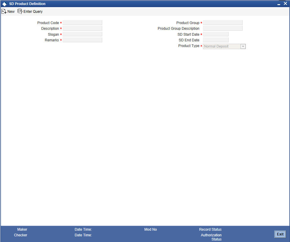

You first need to set up Structured Deposit (SD) products to start the fund raising activity to launch a Structured Deposit scheme. Subsequently, you can capture details of every SD fund raising activity. You can initiate several fund raising activities using a single productYou need to maintain Structured Deposit Products in the ‘SD Product Definition’ screen. You can invoke this screen by typing ‘SFDPRODT’ in the field at the top right corner of the Application tool bar and clicking on the adjoining arrow button.
For any product you create in FLEXCUBE, you can define the generic attributes. Consequently, the contracts associated with the product will inherit the attributes defined for the product.
Product Code
The code you assign to a product will identify the product throughout the module. The code should contain four alphanumeric characters. You can follow your own convention for devising the code.
Since the code that you define is used to identify the product, it should be unique across the modules of FLEXCUBE. For instance, if you have assigned the code ‘SD01’ to a particular product in this module, you cannot use it as a code in any other module.
Product Description
You can enter a brief description of the product, which will be associated with the product for information retrieval purposes.
Slogan
You can specify a marketing punch-line to be associated with the product. This slogan will be printed on all the advices that are sent to the customer, for an SD involving this product.
Remarks
You can enter information about the product, intended for the internal reference of your bank. The remarks are displayed when the details of the SD are displayed or printed However, this information will not be printed on any correspondence with the customer.
Product Group
Each product is classified under a specific group. The different groups are defined in the Product Group Definition table.
Start Date
A SD product can be set up for use over a specific period, by defining a start and an end date.
The start and end dates of a product come in handy when you are defining a product for a scheme, which is open for a specific period.
End Date
Enter the date till which the product should be available in the system
After the product is set up, you can associate SD contracts with the SD products. This is discussed in the next chapter of this manual.
Product Type
The product type identifies the basic nature of a product. An SD product that you create in Oracle FLEXCUBE can be of the following types:
If you indicate the product type as Normal Deposit, the liquidation account currency of the subscription should be same as the currency of the Structured Deposit.
If you indicate the product type as Dual Currency Deposit, the liquidation account currency can differ from the currency of the Structured Deposit.

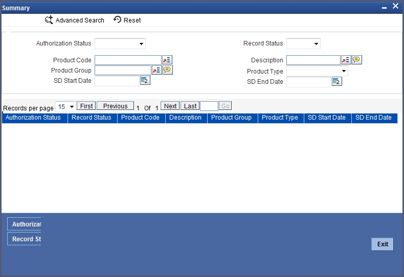

You can search for the SD Products in the ‘SD Product Summary’ screen. You can invoke this screen by typing ‘SFSPRMNT’ in the field at the top right corner of the Application tool bar and clicking on the adjoining arrow button.
In this screen, you can filter the search based on the following criteria:
Note
In case you do not specify the ‘End Date’, the system considers the product you filter, as open ended.
