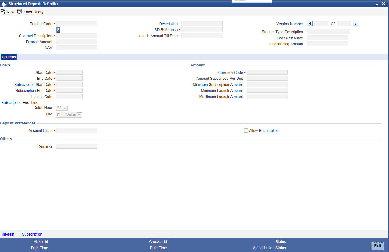

The Structured Deposit details are maintained as Contract Details in the ‘SD Definition’ screen The contract details basically will include all the properties for the SD like interest, currency, maturity date (SD End Date). After you enter and save the SD contracts, your bank can accept subscriptions for the contracts. Effectively, subscription is the way in which the bank raises the money for any SD. These details are maintained as Subscription details.
The SD contracts are maintained in the ‘Structured Deposit Definition’ screen. You can invoke this screen by typing ‘SFDTRONL’ in the field at the top right corner of the Application tool bar and clicking on the adjoining arrow button. The ‘Structured Deposit Definition’ screen is displayed.
The details that need to be maintained at the time of recording each fund raising activity are discussed below:
Product Code
Select the product from the list of products created under Structured Deposits. The details of this product get defaulted from the Product screen.
Product Description
A brief description of the SD Product is displayed in this field.
Product Type Description
A brief description of the SD Product Type is displayed in this field.
Contract Description
You can enter a brief description of the contract, which will be associated with the contract for information retrieval purposes.
Structured Deposit Reference Number
Specify the SD Reference Number based on the mask maintained in ‘Account Mask Parameters’ screen at the Branch Parameters level. However, The system would generate the SD Reference Number if the field, ‘Loan Account Auto Generate’ is checked in ‘Account Mask Parameters’ screen at the Branch level.
The SD Reference Number is a combination of the branch code, the product code, the date on which the contract is booked (in Julian format) and a running serial number for the booking date.
The Reference Number consists of a three-digit branch code, a four-character product code, a five-digit Julian Date and a four-digit serial number.
The Julian Date has the following format:
YYDDD
Here, YY stands for the last two digits of the year and DDD for the number of day(s) that has/have elapsed, in the year.
SD User Reference Number
In addition to Contract Reference Number, a unique User Reference Number also identifies a contract. By default, the Contract Reference Number generated by the system will be taken as the User Reference Number. But you have the option to change the User Ref Number. However, the User Reference Number has to be unique across various modules of Oracle FLEXCUBE.
Oracle FLEXCUBE also provides you the facility to generate the user reference number in a specific format
Note
You can specify a format for the generation of the User Reference Number in the ‘Sequence Generation’ screen available in the Application Browser. Refer to the Core Services User Manual for details on maintaining a sequence format.
Subscription Amount Till Date
Based on the number of subscriptions received, the system displays the amount that the bank has raised through the subscriptions. The system displays the amount after taking into account the unauthorized subscriptions also.

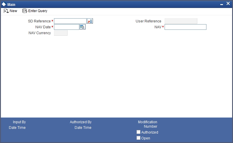

NAV
This is applicable only after the contracts for the SD is launched. After the SD is launched, you can feed the Net Asset Value for the contracts in the NAV Input screen. Consequently, the system picks up the NAV and displays here.
Refer to the section ‘Feeding the Net Asset Values’ in this chapter for details.
Launch till Date
This is the amount equal to the total subscription amount on the date of launch.
Outstanding Amount
The system updates this amount during TD redemptions. You can partially redeem subscriptions. For example, let us assume that the bank decides on the launch amount as USD 10000 and is offering 10 subscriptions of 1000 USD each. A customer can redeem USD 500. Consequently, the outstanding amount will be USD 9500.
As part of recording each fund raising activity, you need to capture the dates of each subscription.
Start Date
This indicates the start date of the contract.
End Date
This is the end date of the contract. If the bank raises the funds successfully, this end date will be the maturity date of the term deposits. The system defaults the end date to the end date of the associated product.
The system validates the end date with the holidays maintained for your branch. If the end date falls on a branch holiday, the system displays an override message.
Note
The system validates the end date against branch holidays every time you modify the end date of the contract.
Subscription Start Date
This is the date from which the bank starts the fund raising activity to float the structured deposit scheme. The customers can start subscribing for the SD scheme from this date. The subscription start date should necessarily be within the SD Start and End date.
Subscription End Date
This is the date by which the bank has to raise the money for floating the SD scheme. The customers can subscribe till this date.
Launch Date
The bank will launch the structured deposit scheme on the launch date. The bank can also launch the contracts manually if the necessary funds are raised through various subscriptions. On launching the contract manually, the launch Date will be the Next Working Date of the Branch. On the day of launching, the system will convert all amount blocks into term deposits.
If you do not specify the launch date, the system will default the launch date as the next working date after the subscription end date.
Subscription End Time
In addition to the end date for subscription, the bank can also specify the cut off time for the last day of the subscription till subscriptions are accepted for the SD scheme.
You need to specify the following amount details for the contract.
Currency Code
You need to indicate the currency of the SD contract.
Amount Subscribed Per Unit
You need to enter the amount for each subscription unit. For example, let us assume that the launch amount is USD 10,000. If a customer subscribes for ten subscriptions, the amount subscribed per unit will be USD 1000.
Minimum Subscription Amount
The bank can specify that the customers cannot subscribe less than a specific amount to enter into a SD contract. You need to enter this as the minimum subscription amount.
Minimum Launch Amount
The bank can launch the SD scheme after it receives a certain amount of funds. This refers to the minimum launch amount.
Maximum Launch Amount
This is the maximum amount that the bank needs to float the SD scheme. The funds required to start the SD scheme should be within the Minimum Launch Amount and Maximum Launch Amount range.
As part of entering the contract details, you need to specify the account class which will be used to create the term deposits on successful launching of the SD scheme.
Account Class
During the launch of a SD scheme, the system releases the amount blocks from the participating savings accounts and converts them to term deposits. Therefore, you need to associate the account class Deposit with the SD contracts.
You need to capture the Account class before the launch. Consequently, the system will automatically generate the term deposits during the launching of the SD scheme. Additionally, the subscription details will also be updated with the term deposit account details accordingly.
Premature Redemption
Select the option ‘Allow Premature Redemption’ to allow cancellation of SD after launch, premature closing individual TDs and individual TD partial liquidation.
Remarks
Specify any additional information about the SD.

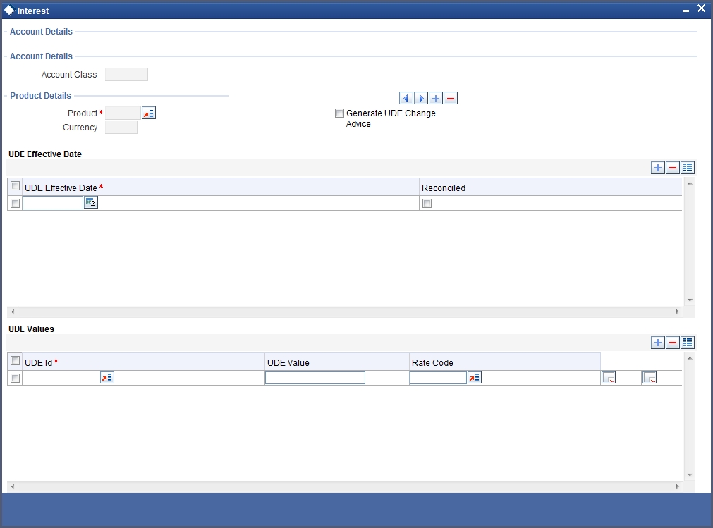

You need to specify the method for calculation of interest on the term deposits.
In Oracle FLEXCUBE, interest is calculated using the interest rules that you define. You can define the interest rules to suit the peculiar requirements of your bank. The rules are then associated to Interest and Charges products.
For further information on the Defining Interest Rules and Products, refer to the following Oracle FLEXCUBE User Manuals:
Click ‘Interest’ button to specify the conditions for calculating the interest on the deposits. The ‘IC Special Conditions Maintenance’ screen is displayed.
The features of this screen are as discussed below:
Account Class
The system defaults the account class from the SD Contract main screen.
Product Code
Select the IC product based on which you want the system to calculate the interest. The interest accrual and liquidation will happen based on the periodic frequency set for the IC product that you select.
UDE Currency
Based on the IC product that you select, the system displays the corresponding currency. You are not allowed to modify the currency.
Generate UDE Change Advice
Check this field to indicate advice generation in the events of interest liquidation and interest rate change.
You need to indicate the date from which the system should start calculating the interest on the automatically generated term deposits.
For more details on defining UDE Dates and UDE Values, refer to the section, ‘Defining Special Condition’ in the chapter, ‘Applying Interest Product on Account’ of the ‘Interest and Charges‘User Manual.

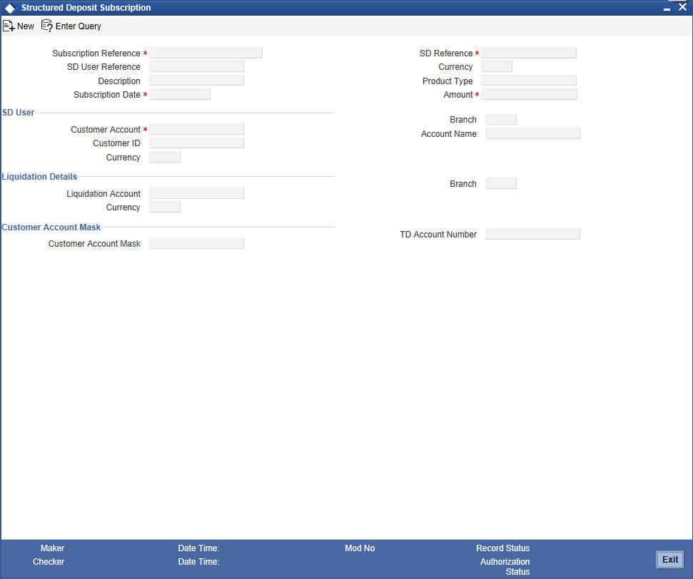

After saving the SD contracts, you can record the subscriptions against the SD contracts in the ‘Structured Deposit Subscription’ screen. You can invoke this screen by typing ‘SFDSUBSC’ in the field at the top right corner of the Application tool bar and clicking on the adjoining arrow button.
In this screen, you can enter the subscriptions for the SD contracts.
SD Reference Number
Select the contract for which you are entering the subscription. The system displays the corresponding contract description, SD User Reference Number and the product type.
Subscription Ref Number
The system sequentially generates and displays the reference number for each subscription that you enter.
SD User Reference
The system displays the SD User Reference maintained at ‘Structured Deposit Definition’ screen for the SD Reference Number you selected.
Description
The system defaults a brief description of the SD maintained at ‘Structured Deposit Definition’ screen for the SD Reference Number you selected.
Subscription Date
You need to enter the date on which the system should block the amount from the account. This date should effectively be within the Subscription Start and End Date for the selected contract. The system defaults the application date. The subscription date cannot be greater than the application date. If you are recording the subscription on the last specified for subscriptions, the system checks for the corresponding SD contract’s subscription cut-off time.
Currency
The currency of the account is displayed.
Product Type
The SD product type is displayed.
Amount
Enter the subscription amount. The subscription that you enter should be greater than or equal to the minimum subscription amount for the contract. This amount will be blocked in the customer account that you specify next.
Customer Account
You need to enter the account number of the customer who is subscribing for the Structured Deposit. The system displays all the savings accounts maintained for the branch that you are logged into. Select the appropriate customer account number for which the system needs to block the subscription amount.
Note
The currency code of the customer account and the Structured Deposit contract should be the same.
Customer ID
The CIF number of the subscribing customer is displayed.
Currency
The currency of the customer account is displayed.
Branch
The branch of the subscribing customer’s account is displayed.
Account Name
The account name of the subscribing customer is displayed.
Liquidation Account
On maturity of the SD contract, the system will credit the returns into the liquidation account that you specify here.
Note
If you do not specify the liquidation account, the system will use the customer subscription account for liquidation. If you specify a liquidation account which does not belong to the subscription account customer, the system displays an override to indicate the same.
The liquidation account can be of any currency.
Currency
The currency of the liquidation account is displayed
Branch
The branch of the liquidation account is displayed.
Customer Account Mask
The system displays the format defined for account numbers for the branch
TD Account No
On successful launching of the SD, the system releases the amount block from the savings account and creates a term deposit account for each subscription. You need to enter the account number for the term deposit that has to be created for the subscription that you are entering. The account number should be in line with the account mask.

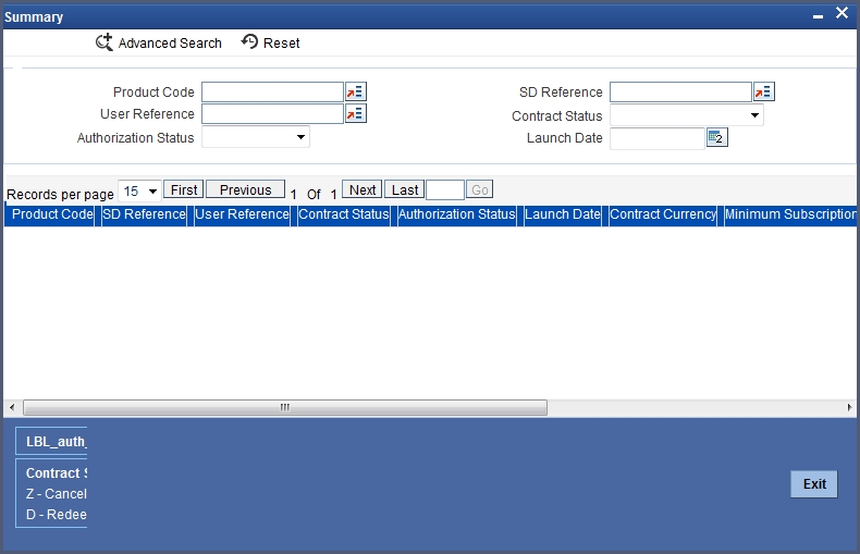

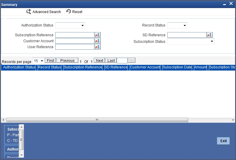

You can search for the subscription details in the ‘Subscription Summary’ screen. You can invoke this screen by typing ‘SFSCSSUB’ in the field at the top right corner of the Application tool bar and clicking on the adjoining arrow button.
In this screen, you can filter the search based on the following criteria:

You can launch a structured deposit contract after you receive sufficient subscriptions to raise the necessary fund. The Structured Deposit contract can be launched from the branch where the contract was created.
You can launch a SD scheme from the Structured Deposit Definition screen. You can invoke this screen by typing ‘SFSCONON’ in the field at the top right corner of the Application tool bar and clicking on the adjoining arrow button. Invoke the contract that you wish to launch from this screen.
The status of the deposit will be ‘Active’ and the authorization status as ‘Authorized’. To launch the contract, click on liquidate icon or select the option ‘Liquidate’. The status of the contract will be set to ‘Launch Initiated’.

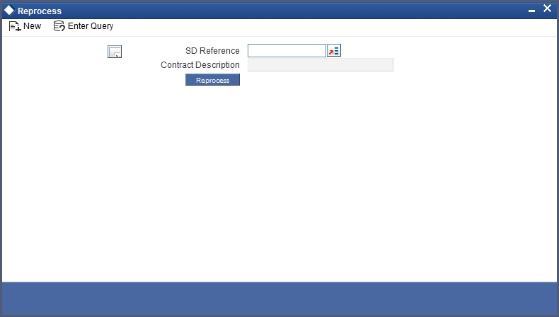

During SD batch process, the system might encounter errors while processing certain structured deposits. For example, the system might not be able release the amount block during the launch of a SD. The system will handle such circumstances as Exception Handling.
In Oracle FLEXCUBE, you can reprocess the structured deposit contracts that failed earlier. This is done in the ‘Structured Deposit Reprocess’ screen. You can invoke this screen by typing ‘SFDREPRO’ in the field at the top right corner of the Application tool bar and clicking on the adjoining arrow button.
Select the option ‘Reprocess’ under ‘Structured Deposits’ menu item in the Application Browser.
SD Reference Number
Specify the SFD reference number. The system displays the description based on the selected reference number.
Status
You can reprocess the SD’s with the following statuses:
Select the SD contract that you wish to reprocess and click ‘Reprocess’ button.
As mentioned earlier, you need to maintain the Net Asset Values (NAV) after the SD contracts are launched You need to enter the NAV for the SD contracts that you have launched in Oracle FLEXCUBE.
The NAV’s are captured in the SD NAV Input screen. You can invoke this screen by typing ‘SFDNAVIN’ in the field at the top right corner of the Application tool bar and clicking on the adjoining arrow button.
In this screen, you need to enter:
