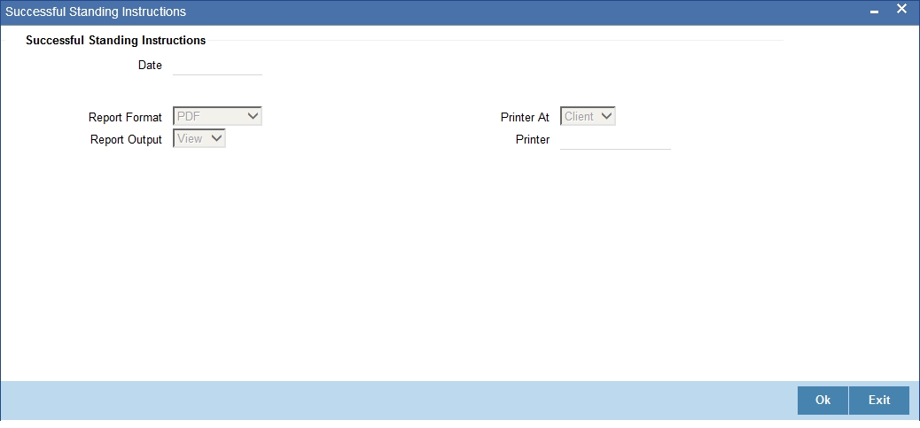

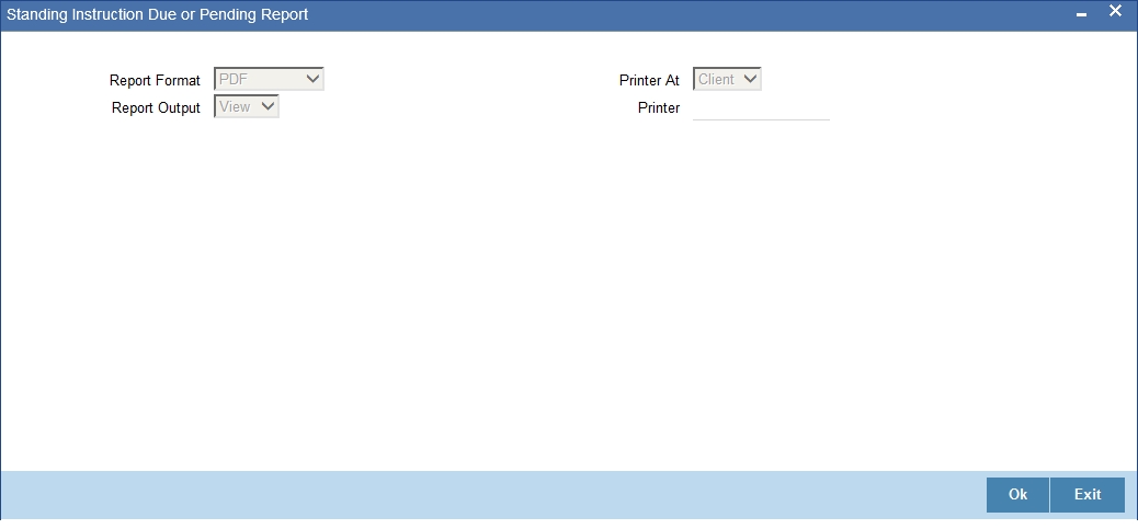

The following are the reports that you can generate for the Standing Instructions module:
Note
The SI reports will not display the details of standing instructions whose execution is in suspended status.
This report should be ideally generated after the EOD run of the SI batch processes has been completed, so that complete information for the day is reported. The report gives details of instructions that were successfully processed during the day. Thus, the original due date of an instruction can be different from the date as of which the report was generated.
The report can be generated for any day in the past or today.
You can invoke this screen by typing the code ‘SIRPSUXS’ in the field at the top right corner of the Application tool bar and click on the adjoining arrow button.
Specify the following details.
Date
Specify the date.
Click ‘OK’ to generate the report.
Header
The Header carries the title of the report, information on the branch code, branch date, the user id, the module name, run date and time and the page number of the report.
Body of Report
The report is sorted by the product code, the product type and the SI type in the ascending order. The following information is provided for each contract:

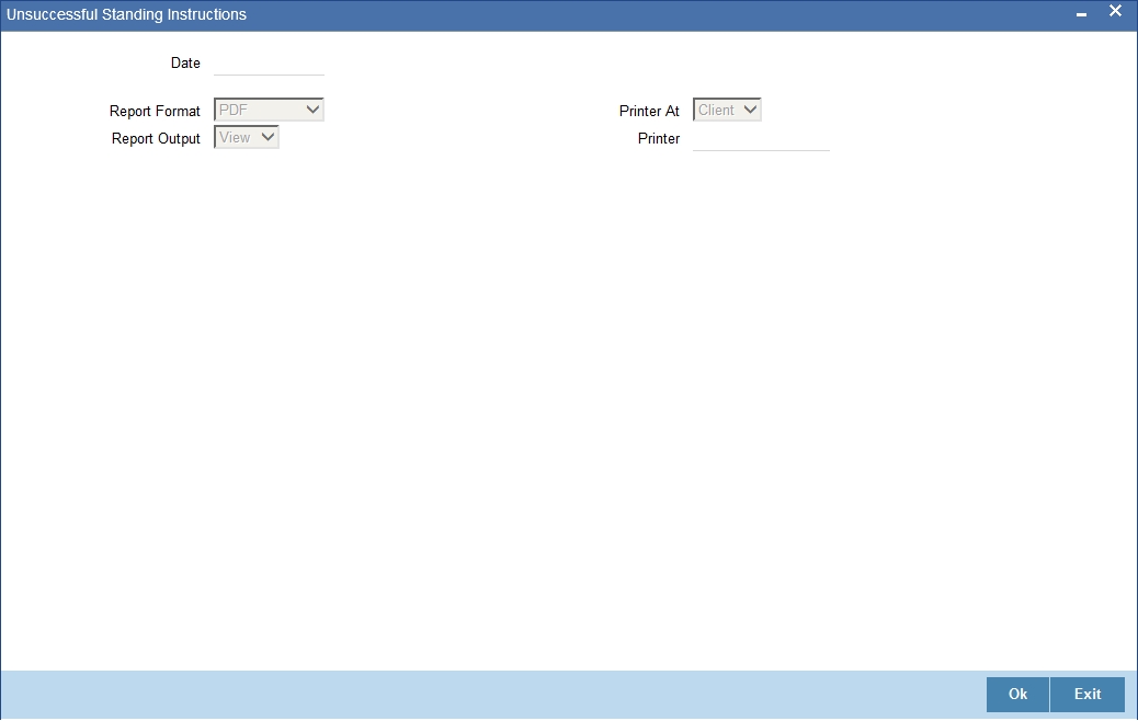

This report should be ideally generated after the EOD run of the SI batch processes has been completed, so that complete information for the day is reported. The report gives details of instructions that were scheduled for the day but were not processed for some reason.
This report can be generated for a date in the past also.
You can invoke this screen by typing the code ‘SIRPUNSC’ in the field at the top right corner of the Application tool bar and click on the adjoining arrow button.
Date
Specify the date.
Header
Body of Report

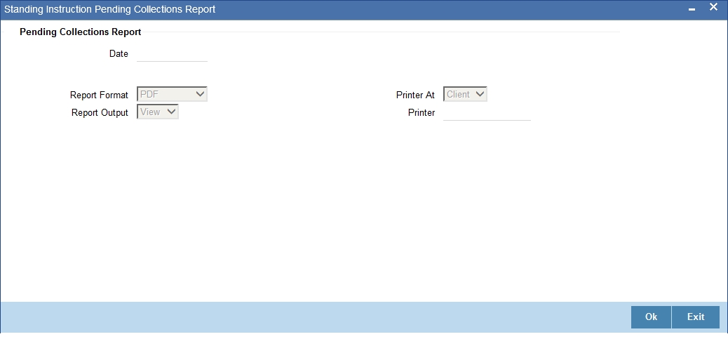

The standing collection orders that are pending execution as of a date are reported by this report. The report can be generated either for today or a date in the past.
The report can be generated as of a specific date.
You can invoke this screen by typing the code ‘SIRPCOLL’ on the field at the top right corner of the Application tool bar and click on the adjoining arrow button.
Date
Specify the date for which the report needs to be generated.
The report options that you selected while generating the report are printed at the beginning of the report.
Header
Body of the report
The report is sorted on the customer number and instruction number in the ascending order.
The following information is provided for each instruction:

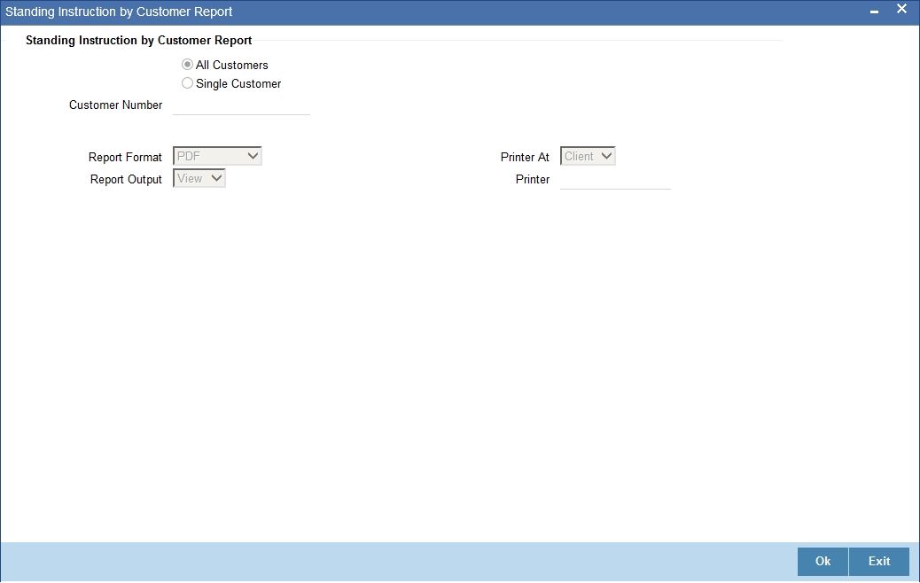

This section contains the following report:
This report gives the details of SIs that have been defined for different customers. You can choose to generate the report for are a specific customer or all the customers of your branch.
You can select the specific customer for whom you want the report. Alternatively, you can generate the report for all the customers of your branch.
You can invoke this screen by typing the code ‘SIRPCUST’ on the field at the top right corner of the Application tool bar and click on the adjoining arrow button.
Standing Instruction by Customer Report
Indicate whether the reports should be generated for all customers or single customer.
If you choose ‘Single Customer’, you need to specify the customer number for which the report needs to be generated. The option list provided displays all valid customer number maintained in the system. You can select the appropriate one.
Header
Body of the report

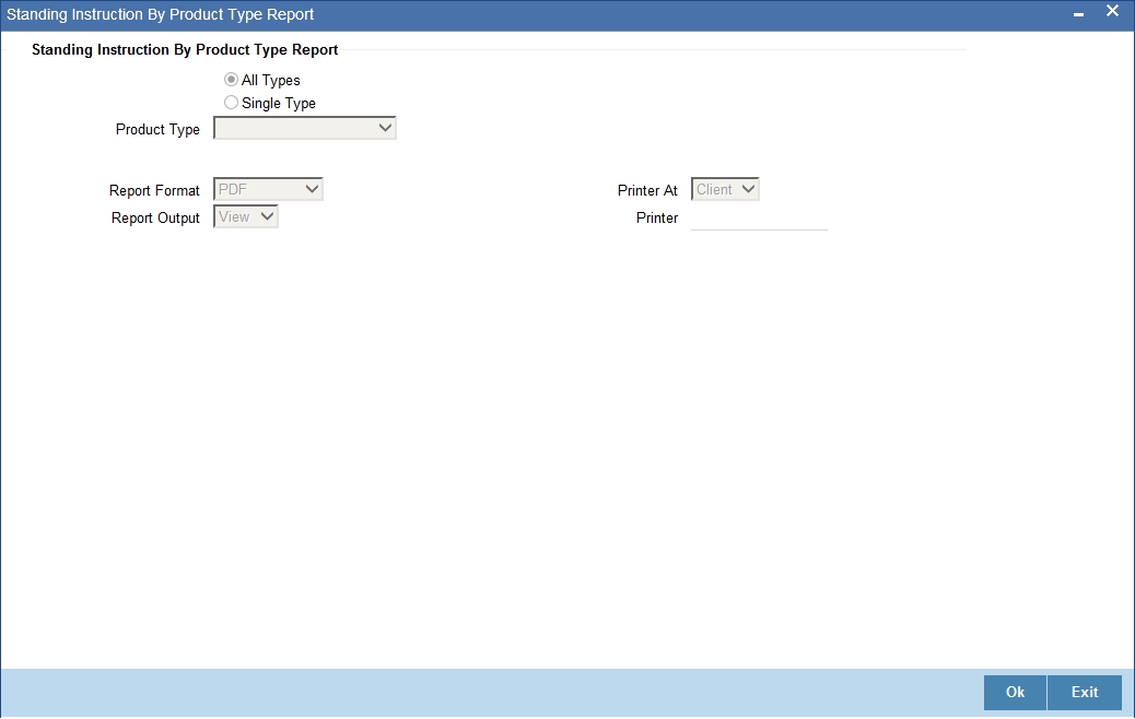

Standing instructions are grouped into different product types: payments, sweeps, collections, and variable payments. You can generate a report on instructions that are processed under each product type.
The report can be generated either for a specific product type or for all of them.
You can invoke this screen by typing the code ‘SIRPTYPE’ on the field at the top right corner of the Application tool bar and click on the adjoining arrow button.
Standing Instruction by Product Type
Indicate whether the reports should be generated for all types or single type.
If you choose ‘Single Type’, you need to specify the product type for which the report needs to be generated. The option list provided displays all valid product types maintained in the system. You can select the appropriate one.
Header
Body of the report
The report is sorted first on the product type and then on the instruction number in the ascending order. The following information is provided for each instruction:
| Field Name | Field Description | ||||
| Product Type | The type of product under which the SI is processed. It could be: payment, collection, sweep, range balancing sweep or variable payment | ||||
| Product Code | The product under which the instruction is processed | ||||
| Instruction Number | Indicates instruction number of the SI. | ||||
| SI Type | The type of standing instruction, which could be ‘One to one’, ‘Many to one’, ‘One to many’, or ‘Many to many’. | ||||
| Counterparty | Customer Name | Frequency | Indicates counterparty, customer name and frequency (in days, month and year). | ||
| Processing | The time of day when the instruction is to be processed | ||||
| Auth Status | The status of the instruction -- authorized or unauthorized. Unauthorized instructions will not be processed | ||||
| Inst Status | Indicates whether the instruction is pending for execution | ||||
| Month End | Indicates month end. | ||||
| Rate Type | If the currency of the instruction and the currency of the accounts involved in it are different, a conversion rate will be used. The rate type defined for this conversion for the product will be shown here. | ||||
| First Value Date | The date as of which the first execution of the instruction was done. This date will be different from the First Due Date if the former falls on a holiday and the SI was executed on a different date. | ||||
| First Due Date | The date as of which the first execution for the instruction was processed. | ||||
| Next Due Date | The date on which the next execution of the instruction will be processed | ||||
| Month End | Indicates whether the instruction is always processed on a month-end | ||||
| User Instruction Number | An instruction can be identified by two different numbers: one is allotted by Oracle FLEXCUBE while the other one can be a number input by you which should typically be the number with which your customer identifies the instruction, called the User Instruction Number. By default, the Instruction Number allotted by Oracle FLEXCUBE and the User Instruction Number will be the same. | This is the User Instruction Number of the instruction. | |||
| Contract Reference | Each execution of the instruction will be allotted a reference number by Oracle FLEXCUBE. This number will be shown here. | ||||
| Max Retry Count | For a payment type of product with an Action Code of Keep full amount pending or Liquidate partially, you would define the maximum number of times the system should re-execute the instruction. This number is shown here. | ||||
| Priority | If a debit account is involved in more than one instruction during the day, you would have allotted a priority for each instruction. This priority is shown here. | ||||
| Charge Borne By | Indicates the party who will bear the charges for the instruction | ||||
| Action Code | For a payment type of product, you should define the action to be taken when an instruction is not executed because of lack of funds. The action code defined for this instruction is shown here. | ||||
| User Reference | Indicates user reference | ||||
| Beneficiary | It is the name of the customer who is the beneficiary of the instruction. | ||||
| SI Currency | The currency in which the instruction is processed | ||||
| Amount | For a payment and collection type of product, this is the amount defined for the instruction. | ||||
| Min Sweep Amount | Applies for a sweep type of product. This is the minimum amount that has been defined for a sweep to be executed. | ||||
| Min Bal after Sweep | The minimum amount that should be available in the Sweep From account after the sweep has been executed | ||||
| Charge on Success/ Partial execution/ Reject | Indicates whether charges are to be applied for instruction when it has been successfully executed, or partially executed or rejected | ||||
| Debit - Branch, Account, Currency | The details of the debit account -- the branch, account number and currency | ||||
| Credit | The details of the credit account -- the branch, account number, and currency | ||||
| Product Type | Indicates product type. | ||||
| Count | Indicates count. | ||||
| Total no of instructions | Indicates total no of instructions. |
The Standing Instructions Due/Pending for Execution Report is ideally generated during the Beginning of Day operations. It provides information about the instructions that fall due today, and those that are pending from previous days.
The information given by this report depends on when the report is generated, as follows:
Note
Sweeps will not be reported in this report as whether a sweep is due for execution depends on the balance in an account at the time of execution.
You can invoke this screen by typing the code ‘SIRPDUE’ on the field at the top right corner of the Application tool bar and click on the adjoining arrow button.
Header
Body of Report
| Processing Time | The time of day when the instruction is to be processed | ||
| Product Type | The type of product under which the SI is processed. It could be: payment, collection, sweep, or variable payment. | ||
| SI Type | The type of standing instruction. It could be: one to one, many to one, one to many, or many to many. | ||
| Instruction Number | This is the instruction number. | ||
| Status | The status of the instruction - due or pending. | ||
| Due Details | |||
| Next Value Date | The date as of which the next cycle of the instruction will fall due. This date will be different from the Next Due Date if the former fell on a holiday and the SI was executed on a different date. | ||
| Next Exec Date | The date on which the next execution of the instruction will be processed. | ||
| Counterparty | The code for the customer | ||
| Name | The customer’s name on behalf of whom the instruction is being processed. | ||
| Contract Reference | The reference number for the particular cycle of the instruction that is due or pending. | ||
| SI Value Date | The date as of which the next cycle of the instruction will fall due. This date will be different from the Next Due Date if the former fell on a holiday and the SI was executed on a different date. | ||
| SI Expiry Date | The date as of which the cycle falls due. | ||
| Max Retry Count | The maximum number of times that the instruction will be retried for execution | ||
| Action Code | Indicates the action that is to be taken in case the instruction is not processed on the due date due to lack of funds in the debit account. | ||
| Charge Borne By | Indicates the Charge borne by. | ||
| Priority | If the debit account is involved in more than one instruction during the same day, you should allot the order in which they should be processed. The priority allotted for this instruction is shown here. | ||
| SI Amount Currency | The currency in which the instruction is processed | ||
| SI Amount | The amount that is transferred when the instruction is processed | ||
| Charges on Success/ Rejection/Partial Execution | Indicates whether any charges have to be levied when this instruction is processed – on successful execution, partial execution or on rejection. | ||
| Debit and credit- Branch, Currency, Account, Name, Amount | These are the details of the debit and credit account of the transaction - the branch, the account currency, the account number, the customer’s name and the amount transferred. | ||
| Pending Details | |||
| Counterparty | Indicates the identification of the counterparty | ||
| Customer Name | Indicates the name of the customer | ||
| Contract Reference | This is the reference number of the contract | ||
| SI Value Date | The date as of which the next cycle of the instruction will fall due. This date will be different from the Next Due Date if the former fell on a holiday and the SI was executed on a different date | ||
| Retry Date | Indicates the date of the retry. | ||
| SI Exec Date | Indicates SI execution date. | ||
| Retry Count | Indicates the count of retries | ||
| Max Retry Count | Indicates the maximum retry count | ||
| SI Exec Status | Indicates status of the execution (Unprocessed) | ||
| Priority | Indicates the priority | ||
| SI Currency | Indicates the currency of the SI | ||
| SI Amount | Indicates the SI amount | ||
| SI Amount Pending | Indicates the pending amount to be executed for SI | ||
| SI Amount Executed | Indicate amount executed. | ||
| Charges on Success/ Rejection/Partial Execution | Indicates whether any charges have to be levied when this instruction is processed - on successful execution, partial execution or on rejection. | ||

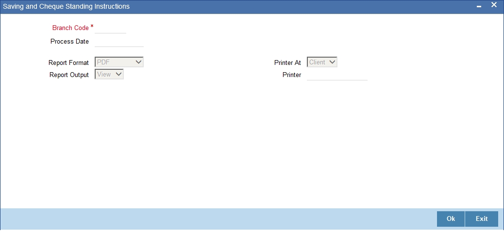

Oracle FLEXCUBE facilitates you to view the list of standing instruction executed for external account and banker cheques for a given branch code and process date. Branches accept the standing instructions (SI) for credit in their own accounts, as well as for other bank accounts. They also accept by means of remittances like bankers cheque etc. If there are no exceptions, during BOD system successfully executes SI transactions, and you can generate a SI Instruction Executed for External Acc, DD, and BC Report to view the information of the branches.
This report lists CASA accounts in which SI has been executed for external accounts and bankers cheques on the day of generation. The accounts are grouped based on payment mode and beneficiary. You can invoke ‘SI Instruction Executed for External Acc, DD, and BC Report’ screen by typing ‘SIRACCBC’ in the field at the top right corner of the Application tool bar and clicking on the adjoining arrow button.
You can specify the following parameters here:
Branch Code
Specify a valid code of the Branch in which report is being generated, from the adjoining option list.
Process Date
Specify a date for which you want to generate a SI executed report from the adjoining calendar.
The parameters specified while generating the report are printed at the beginning of the report. Other content displayed in the SI Instruction Executed for External Acc, DD, and BC Report is as follows:
Header
The Header carries the title of the Report, information on the branch code, branch date, the user id, the module name, run date and time and the page number of the report.
Body of the Report
The following details are displayed as body of the generated report:
| Ben Account No | Indicates Beneficiary Account Number | ||
| Beneficiary details | Indicates Beneficiary Name | ||
| Customer | Indicates Customer ID | ||
| Short name | Indicates the short name of the customer | ||
| Account no | Indicates Remitter Account No | ||
| SI CCY | Indicates Standing Instruction Currency | ||
| SI Amount | Indicates Standing Instruction Amount | ||
| SC Amount | Indicates Service Charge Amount | ||
| Total Amount | Indicates Total SI amount and SC amount |

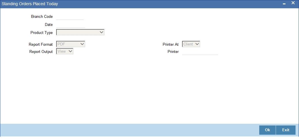

During the day, branches input the standing instructions given by the customers. Branches enter the Debit account no, frequency, amount etc based on the details provided by the customer. After these details are entered, during EOD the standing instructions are carried out according to the start date, frequency, priority, etc. You can list these successful standing orders placed through out the day in ‘Standing Order Placed Today Report’.
You can invoke ‘Standing Order Placed Today Report’ screen by typing ‘SIRPLTOD’ in the field at the top right corner of the Application tool bar and clicking on the adjoining arrow button.
Branch Code
Date
Specify a date for which you want to generate standing orders placed report from the adjoining calendar.
Product Type
Select a valid type of the product for which the standing orders were placed from the adjoining drop-down list. This list displays the following values:
The parameters specified while generating the report are printed at the beginning of the report. Other content displayed in the Standing Order Placed Today Report is as follows:
Header
Body of the Report
| Account no. | Indicates Debit account number | ||
| Customer name | Indicates Customer name | ||
| Priority | Indicates Priority | ||
| Product Type | Indicates SI product type | ||
| Frequency | Indicates Instruction frequency | ||
| Next Due Date | Indicates Next Instruction scheduled date | ||
| CCY | Indicates Standing Instruction amount currency | ||
| Payment Amount | Indicates Standing Instruction Amount | ||
| Beneficiary Name | Indicates Credit Account holder name | ||
| Beneficiary Ac No | Indicates Credit Account Number |

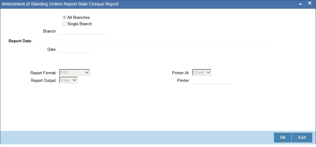

This report gives details on amendment of Standing Orders Report Stale Cheque.
You can invoke ‘Standing Order Placed Today Report’ screen by typing ‘SIRPAMND’ in the field at the top right corner of the Application tool bar and clicking on the adjoining arrow button.
Branch
Specify a valid name of the Branch in which report is being generated, from the adjoining option list.
Date
The parameters specified while generating the report are printed at the beginning of the report. Other content displayed in the Amendment of Standing Orders Report Stale Cheque Report is as follows:
Header
Body of the Report
| Reference Number | Indicates reference number | ||
| Dr. Customer Account Number | Indicates Dr. customer account number | ||
| Customer Title | Indicates the title of the customer | ||
| Event Sequence Number | Indicates event sequence number | ||
| Cr Account Number | Indicates Cr account number | ||
| Cr Account Title | Indicates Cr account title | ||
| Booking Date | Indicates booking date | ||
| Start Date | Indicates start date | ||
| End Date | Indicates end date | ||
| Previous Value Date | Indicates previous value date | ||
| Type of Standing Instruction | Indicates the type of standing instruction. |

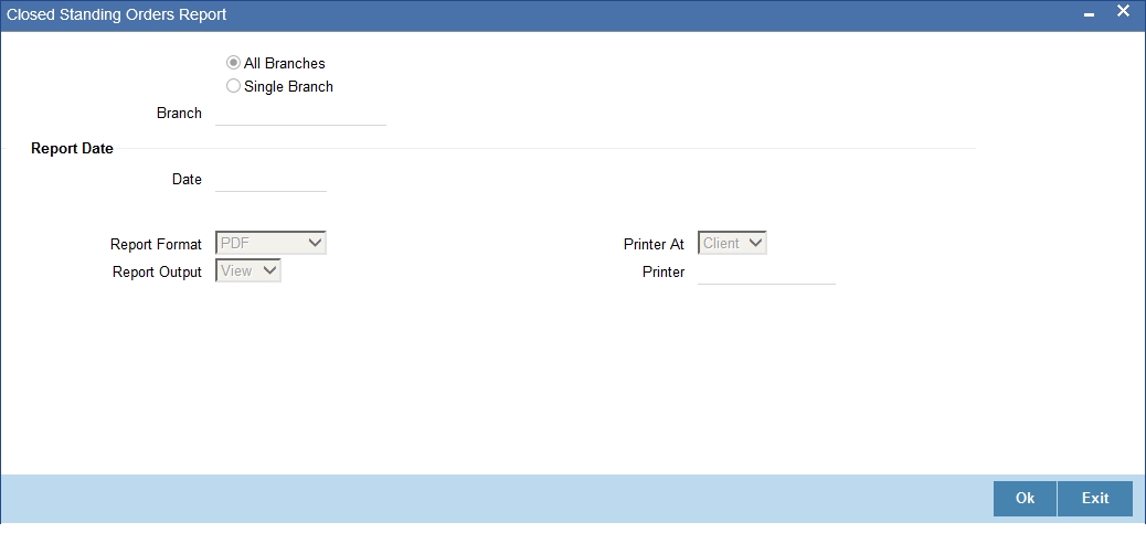

This section contains the following topic:
This report gives details on closed standing orders.
You can invoke ‘Standing Order Placed Today Report’ screen by typing ‘SIRPDELT’ in the field at the top right corner of the Application tool bar and clicking on the adjoining arrow button.
Branch
Date
The parameters specified while generating the report are printed at the beginning of the report. Other content displayed in the Closed Standing Orders Report is as follows:
Header
Body of the Report
| Sr. No. | Field Name | Field Description | |||
| 1 | Reference Number | Indicates reference number | |||
| 2 | Dr Customer Account Number | Indicates Dr. customer account number | |||
| 3 | Customer Title | Indicates the title of the customer | |||
| 4 | Event Sequence Number | Indicates event sequence number | |||
| 5 | Frequency | Indicates Instruction frequency | |||
| 6 | Cr Account Number | Indicates Cr account number | |||
| 7 | Cr Account Title | Indicates Cr account title | |||
| 7 | Booking Date | Indicates booking date | |||
| 8 | Start Date | Indicates start date. | |||
| 9 | End Date | Indicates end date. | |||
| 10 | Previous Value Date | Indicates previous value date. | |||
| 11 | Type of Standing Instruction | Indicates the type of standing instruction. |

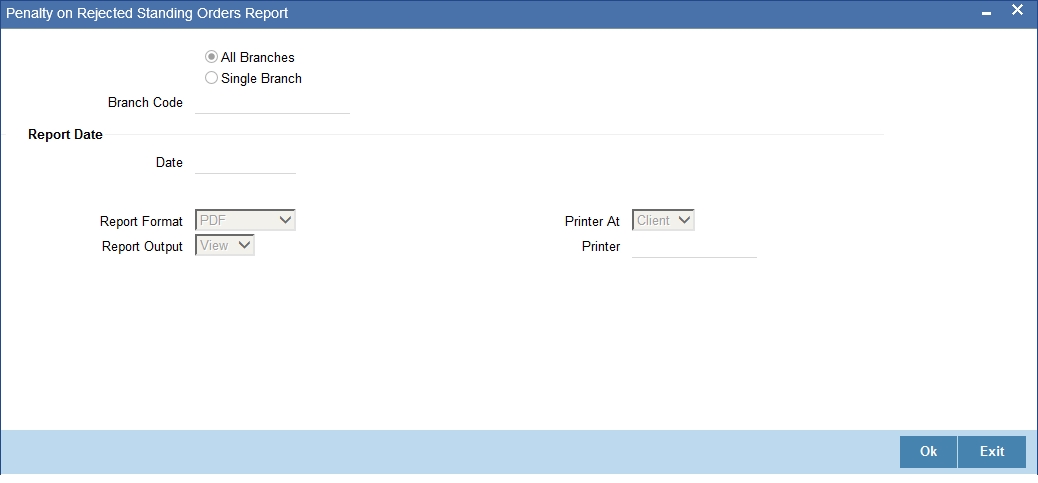

This report gives details on penalty on rejected standing orders.
You can invoke Penalty on Rejected Standing Orders Report screen by typing ‘SIRPREJT’ in the field at the top right corner of the Application tool bar and clicking on the adjoining arrow button.
Branch Code
Date
Header

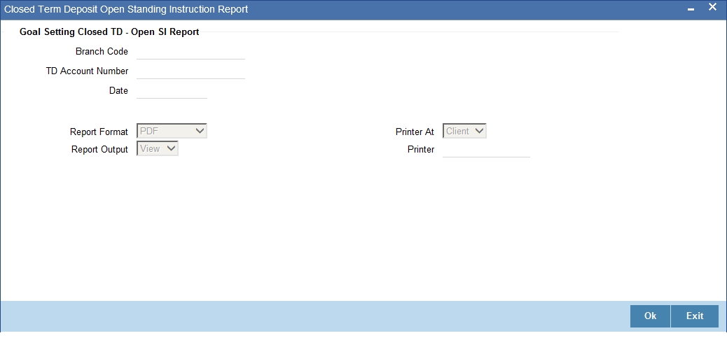

This report provides details on the list of Standing Instructions attached to a closed TD in the SI contract. You can invoke the ‘Closed Term Deposit Open Standing Instruction Report’ screen by typing ‘SIRLISTC’ in the field at the top right corner of the Application tool bar and clicking on the adjoining arrow button.
Specify the following details in this screen:
TD Account Number
Select the TD account number of the SI Contract, from the adjoining option list. This field lists all the TD account numbers in the SI contract that have been closed.
Branch Code
The branch of the selected account number is defaulted. However, if multiple branches are linked to the account, then select the appropriate value from the adjoining option list.
Date
Specify the date of the report.
The parameters specified while generating the report are printed at the beginning of the report. Other contents displayed in the report are as follows:
