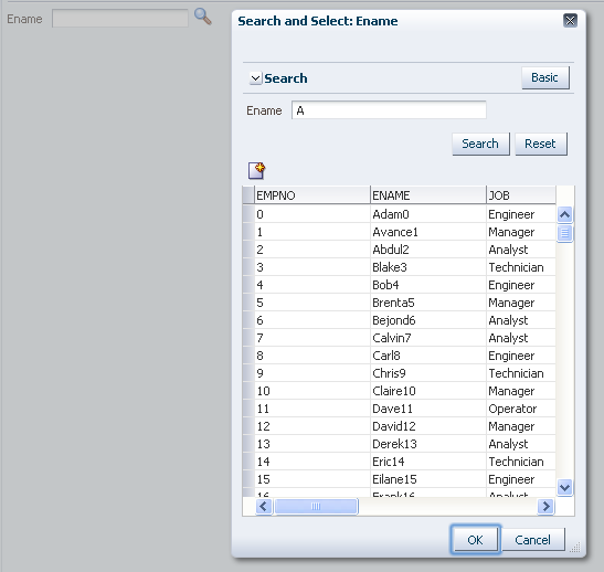

The inputListOfValues component allows users to select from a large list of values to help populate the LOV field (and possibly other fields) on a page. This component is used in situations where the list of values to display is too large.
In addition to rendering an inputText component, the inputListOfValues also renders a "Search" icon. Clicking the icon lauches a "Search and Select" dialog that enables the user to find an option that goes into the LOV field on the base page.
Note: When the value is selected from search and select dialog, the value gets pushed to the model irrespective of the autoSubmit property on the component.
The mechanism to exchange data between a base page and the popup dialog should be handled through the model (or managed bean). Developers need to implement following three listeners to successfully complete the data exchange.
