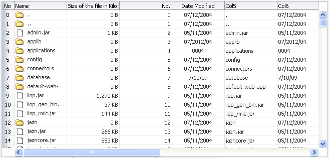

The Table is used to display tabular data. It also supports row/column selection (both single and multiple), sorting, record navigation. Table is not meant for use as a layout component of disparate information. For more information about this, see the Accessibility Guidelines section.
The Table component uses a model to access the data in the underlying list. The specific model class is
oracle.adf.view.rich.model.CollectionModel. You may also use other model instances, e.g., java.util.List, array, andjavax.faces.model.DataModel.
The Table will automatically convert the instance into a CollectionModel.
