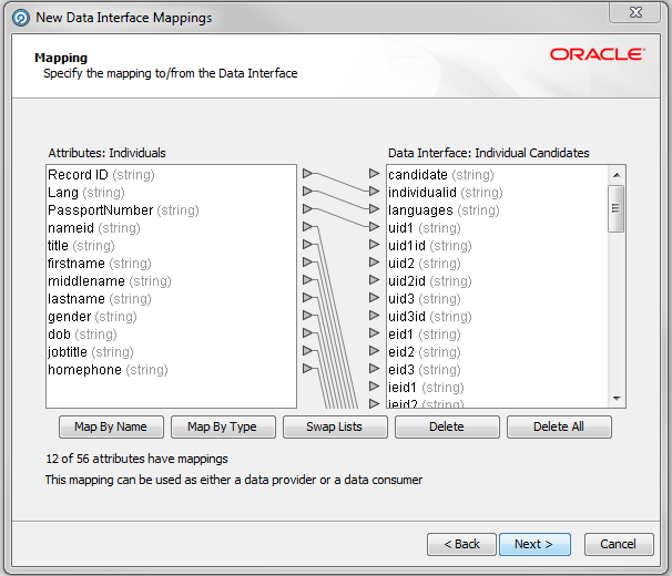

Create the Input mappings as follows:
Right-click the Individual Candidates and select Mappings... to open the Mappings dialog.
Click Add to open the New Mappings dialog.
Select the Individuals snapshot as the source and click Next. The Staged data default type is used.
Map the Customer Data Attributes on the left of the dialog to the Attributes on the right as follows:
Note :
In some instances, it may be necessary to construct a process that reads from the snapshot and reshapes the data to match the , see Section 2.1.2, "Converting Data to the Interface Format."Click Next.
Name the mapping Individual Candidates and click Finish to save.

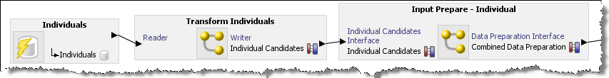

It may not always be possible to directly map the input source to the candidates interface if:
fields are of the wrong data type (for example, "Date of Birth" in a date field); or
fields need transforming to a compatible format/structure (for example, Individual names in a full name field).
If this is the case, then the input data should be run through a custom EDQ process to convert the data as appropriate as in the following example steps:
Ensure that no jobs are currently running.
Create a data store and snapshot for the input data as in steps 2 and 3 from Section 2.1, "Using Stand-Alone Batch Matching."
In the EDQ-CDS project, right-click the Processes node in the Project Browser and select New Process... to open the New Process wizard.
Select the snapshot created in step 2 as the data source.
Click Next.
On the last page of the wizard, rename the process Transform Individuals, then click Finish button to create the process.
On the Process canvas, add the necessary processors to transform the data to the interface format. For example, use a Convert Date to String processor to convert a date of birth in date format to the required format for the Candidates interface (for example, either yyyyMMdd, MM/dd/yyyy, yyyy-MM-dd or dd-MMM-yy).
Add a Writer processor to the process canvas and connect it to the process data stream:
In the Writer Configuration dialog, select the Individual Candidates and map the attributes accordingly.
Create and configure a new job as follows:
Make a copy of Batch Individual Match job, renaming it Batch Transformed Individual Match.
Open the new job.
Double-click on the Individual Match job phase.
Use steps 9.d. - 10 of Section 2.1, "Using Stand-Alone Batch Matching" from step 9.d onwards, adding in the new Transform Individuals process between the Individuals snapshot and the process Input - Prepare - Individual. The resulting job should look like the following:

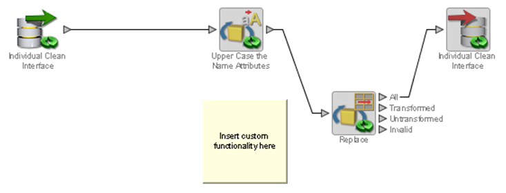

Open the Clean - Individual process.
Add a new Replace processor to the Process Canvas and connect it to the output of the Upper Case the Name Attributes processor.
In the Processor Configuration dialog, set the jobtitle attribute as the Input field, and on the Options tab select the Job Title Standardizations Reference Data in the Replacements field.
Click OK to close the processor configuration dialog.
Connect the All output of the Replace processor to the Writer, then click OK without making any changes to the Writer configuration.
On the Process Canvas delete the direct link between the Upper Case processor and the Writer.
Close the process and save the changes.

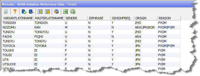

Conflict resolution is performed to resolve issues arising when name standardization rules try to standardize names to more than one Master name. For example, if there is a rule that maps "Jon" to a Master of "John" and another that maps "Jon" to "John-Boy", there is a conflict. This conflict is resolved by assessing the importance of each Master name in the given standardization data. The best candidate is then selected as the primary Master, and other standardization maps conflicting with it are removed and quarantined.
As part of conflict resolution, each removed record is assigned one or more Reason Codes explaining why it is in conflict. These codes are displayed in the REASON column in the Server Console Results window:
The Reason Codes are as follows:
PIV: The Primary record of a cluster of records (for example, the best Master identified for a set of equivalences) is also present as a variant to other Masters. All the instances where this Primary name is a variant are removed.
PVOM: The records that are variants of the current Primary are also variants of other Masters. All the records for these variants pointing to other Masters are removed.
PVIM: The records that are variants of the current Primary are also Masters to other variants. All the records where this variant is a Master are removed.
PIVCUTOFF: Whereas the other removals take place after identification of Primary clusters, there comes a time where it is not efficient to continue to identify the Primaries, and the remaining records where the Master name also exists as a variant have all the variant versions removed in a final cull of records that violate integrity.
Expanding on the simple example given at the beginning of this section, let us assume that there are the following name standardization rules:
| Master | Primary |
| J-MAN | JON |
| JOHN | JONATHAN |
| JOHNNY | JONNY |
| JON | JOHN |
| JON | JONATHAN |
| JON | JOHN-BOY |
| JONNY | JONATHAN |
| JONATHAN | JONATHON |
| JOHNNY | JONATHAN |
These rules contain a number of inherent conflicts. This is illustrated in the following diagram in which JONATHAN is identified as the Primary:
The arrows indicate the following:
| Arrow Type | Reason for Conflict |
| N/A (No conflict exists) | |
| PIV | |
| PVIM | |
| PVOM |
The conflict resolution rules will discard the mappings that cause conflicts, as follows:
Resulting in the following mappings being created:
| Name | Primary |
| JOHN | JONATHAN |
| JON | JONATHAN |
| JONNY | JONATHAN |
| JOHNNY | JONATHAN |
