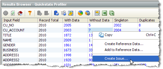

To add an Issue based on your results (for example to tag an item of interest, or to create an action for another user to follow-up on):
  1. Right-click on the data in the Results Browser, and select Create Issue...:
    Adding an issue
    The issue will be linked to the specific process and processor where it was created, so that another user can quickly find the related data.

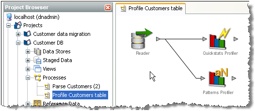

  1. Ensure your process is open on the Canvas:
    Open Process in Canvas

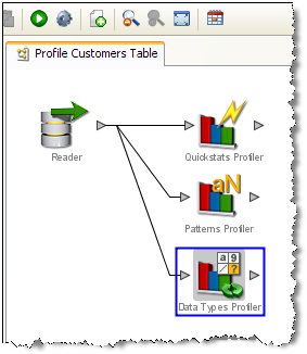

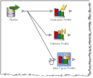

  4. Add a processor from the Tool Palette to the process by clicking on a processor and dragging it to the Canvas.
  5. Connect the processor to the data from the Reader by joining the arrows:
    Connecting the processor
  6. Configure the processor by selecting its input attributes:
    Data Types Profiler
    The blue arrow icons indicate that the latest version of the attribute will be used as the input. This is especially important when transformation processors have been used.

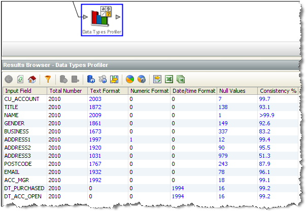

  9. When the process has finished, the processors no longer appear with a shaded background, and you can browse on the results for each processor by clicking on the processor on the Canvas, and viewing its results in the Results Browser:
    Results Browser
  10. Drill-down on the metrics to see the relevant data for the metric.

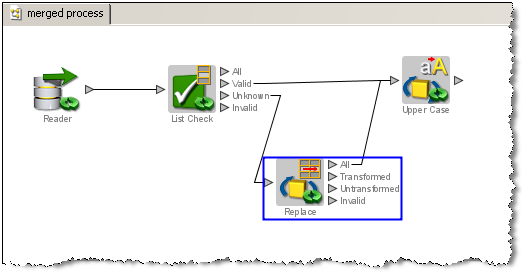

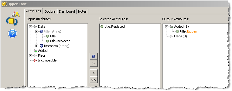

1.6.1 Ambiguous Latest Attribute
When selecting the input attributes for a processor, it is possible that some attributes may have an ambiguous latest version. This happens whenever an attribute exists on two different paths, and has been transformed on either or both of these paths. Where this happens, the top level attribute (or latest version) will be greyed out, and will not be selectable. In this case, you need to select the specific version of the attribute that you want to use by expanding on the attribute and viewing all its possible versions.
For example, the Upper Case processor below has been configured with 2 input paths, from 2 different processors. The Replace processor transforms a 'title' attribute:
Merged Process
The Upper Case Processor configuration would appear as follows, with the latest version of the title attribute greyed out to indicate that it is ambiguous and therefore not available for use. In this case, you need to select one of the specific attributes listed under the title attribute.
Upper Case
This scenario will commonly occur while configuring the Merge Attributes processor, as this is often used to unite separate processing paths.

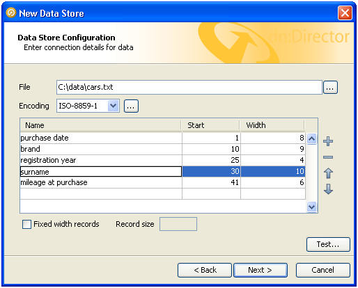

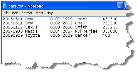

1.7 Configuring Fixed Width Text File Formats
When you define a new data store that connects to a fixed width text file, the New Data Store wizard will prompt you to define the names and sizes of the data fields in the file.
Data in a fixed-width text file is arranged in rows and columns, with one entry per row. Each column has a fixed width, specified in characters, which determines the maximum amount of data it can contain. No delimiters are used to separate the fields in the file. Instead, smaller quantities of data are padded with spaces to fill the allotted space, such that the start of a given column can always be specified as an offset from the beginning of a line. The following file snippet illustrates characteristics common to many flat files. It contains information about cars and their owners, but there are no headings to the columns in the file and no information about the meaning of the data. In addition, the data has been laid out with a single space between each column, for readability:
In order to parse the data in a fixed width text file correctly, EDQ needs to be informed of the column sizes implicit in that file. This is done in the New Data Store wizard, and can be edited as part of the data store settings later, if required.
When you first enter the data store configuration screen for a fixed width text file, the columns table is empty. In the following screenshot, it has been populated with the mapping information for some of the columns in our sample file:
New Data Store
Each column is described to EDQ by its starting position and width, in characters. Each column is also assigned a name, which is used in data snapshots and downstream processing so that the data can be identified. Names are defined by the user at the time the data store is defined and should be descriptive, for maximum downstream usability.
Notice that the positions of the data columns are defined in terms of start point and width. Note also that the first character on a line is at position 1, not zero. Providing a width and a starting point for each column means that EDQ does not assume that one column continues right up until the start of the next, with the result that:
  • Any spaces that have been included in the file for readability, such as a single space between columns, can automatically be bypassed.
  • It is not necessary to define mappings for every column in the file. If un-needed columns exist, they can simply be omitted from the column definitions in the data store configuration. For example, we have not included the third column from the file in our mappings, but because the boundaries of the surrounding columns are tightly defined, no extraneous data will be included in the data set.
  • Columns do not have to be specified in the same order as they occur in the file. The column order specified here will be reflected in any snapshots created from the data source.
The buttons to the right of the columns table can be used to add or remove records, or move the selected record up or down in the list.

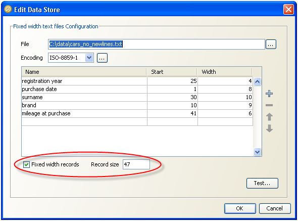

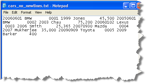

1.7.1 Files containing no new line characters
By default, it is assumed that fixed width files will be formatted as already described, with a new line separating one row from the next. However, some files do not use new line characters to separate rows. Data will then appear like this in a text editor:
In this case, the width of the whole record must also be specified as part of the data store configuration, so that EDQ can correctly subdivide the data into rows. To do this,
  • Check the Fixed width records checkbox underneath the columns table, and
  • Specify the total record size, in characters, in the Record size box:
    Edit Data Store

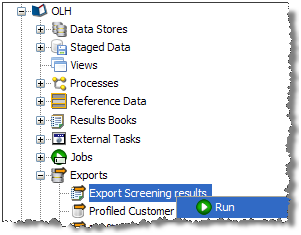

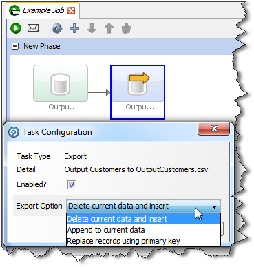

1.10 Exporting Data (Prepared exports)
There are two sources of data for prepared exports: Data from Staged Data and data from Results Books.
It is also possible to create an ad-hoc export to Excel directly from the Results Browser.
1.10.1 Staged Data Export
Once a Staged Data table has been created with a Writer processor, an Export to write it to a Data Store can be created. The Export may then be manually run, or executed when the process that generates the Staged Data table is run.
To set up an Export of a Staged Data table:
  1. Right-click on Exports in the Project Browser, and select New Export...:
    Exporting data
  2. Select the required Staged Data table.
  3. Select the required Data Store.
  4. If the table in the Data Store is not being created during export, select the required table in the Data Store.

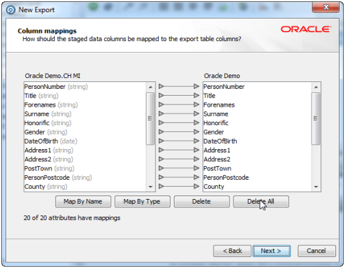

    The contents of this table will be overwritten by default. See Export Options below for further details.
  5. If required, map the columns in the Staged Data table to columns in the target table:
    New Export
    Click on the Auto button to automatically map the columns in the order they are presented.
  6. When the mapping is complete, click Next, and (if required) change the default Name of the Export (the default name comprises the Staged Data table and the name of the Data Store).
  7. Either run the Export straight away, or save the configuration for running later (for example, as part of the scheduled execution of a job or process).

The user chooses how the Export behaves when adding the Export Task to a job:
Export Task
The options are:
  • Delete current data and insert (default): EDQ deletes all the current data in the target table or file and inserts the in-scope data in the export. For example, if it is writing to an external database it will truncate the table and insert the data, or if it is writing to a file it will recreate the file.
  • Append to current data: EDQ does not delete any data from the target table or file, but adds the in-scope data in the export. When appending to a UTF-16 file, use the UTF-16LE or UTF-16-BE character set to prevent a byte order marker from being written at the start of the new data.
  • Replace records using primary key: EDQ deletes any records in the target table that also exist in the in-scope data for the export (determined by matching primary keys) and then inserts the in-scope data.
Notes:
  • When an Export is run as a standalone task in Director (by right-clicking on the Export and selecting Run), it always runs in Delete current data and insert mode.
  • Delete current data and insert and Replace records using primary key modes perform Delete then Insert operations, not Update. It is possible that referential integrity rules in the target database will prevent the deletion of the records, therefore causing the Export task to fail. Therefore, in order to perform an Update operation instead, Oracle recommends the use of a dedicated data integration product, such as Oracle Data Integrator.

1.11.1 Manually running an export
Right-click on the named Export configuration in the Project Browser, and select Run:
Running a prepared export
The export process will run immediately and you can monitor its progress in the Project Browser.

1.11.2 Running an export as part of a job
If you are exporting to a server-side Data Store, you can run the export as part of a larger job, and schedule that job for execution at some point in the future:
  1. Right Click on the Job Configuration in the Project Browser, and select New Job.
  2. This brings up the Job Configuration dialog. Change the default name of the job to a descriptive name.
    Note that the Tool Palette now changes to show a list of tasks that may be run in jobs.
  3. Drag-and-drop the Export Task from the Tool Palette to add it to the job.
  4. The job may also include other tasks, for example, to re-run snapshots, run processes, and external jobs. See the "Jobs" topic in Enterprise Data Quality Online Help for further details.
  5. For each export task selected, define how the export should be performed. A further option allows you to disable the export.
  6. Click Run to run the job straight away, or click Schedule to schedule the job to run at a later date or time.
