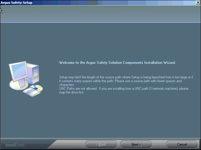

Start the Argus Safety Setup installation wizard by double-clicking setup.exe.
When the system displays the Argus Safety Solution Components Install Wizard dialog box, click Next > to continue.

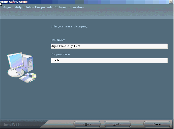

When the wizard opens the Customer Information dialog box:
Type the user name in the User Name field.
Type the company name in the Company Name field.
Click Next > to continue.

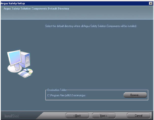

When the wizard opens the Default Directory dialog box:
Click Browse to default installation directory for the Argus Safety Solution components.

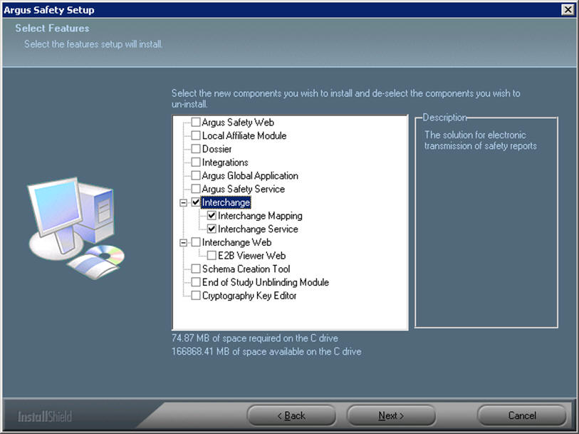

When the wizard opens the dialog box:
Select Interchange.

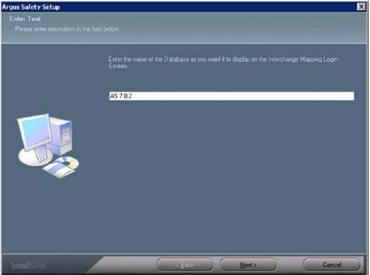

When prompted to enter a database name:
Enter the database name as you want it to appear in Argus Interchange.

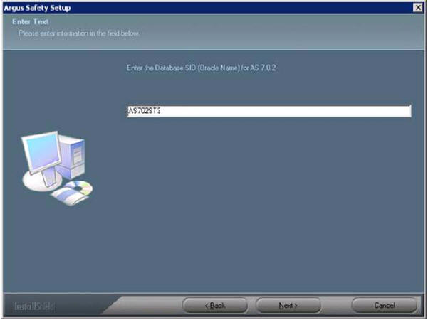

When prompted to enter the database SID:
Enter the database SID.

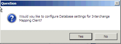

When the system asks if you would like to configure database settings for Argus Interchange:
Click Yes to add an additional database to the Argus Interchange.

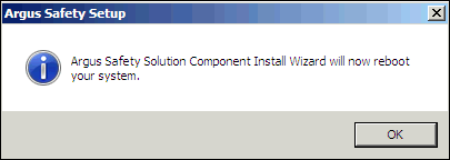

When the following message displays:
Click OK to reboot.
