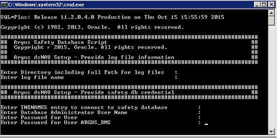

Execute the batch file Setup_dsnav_centralized_coding.bat.
Description of the illustration ''nav2.gif''
Provide a log folder name such as C:\DSnavLog.
Provide a log file name.
Provide the Argus Safety DB name.
Provide database administrator name such as system and password.
Provide the password for ARGUS_DMS schema.

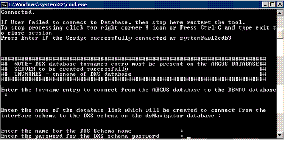

Before proceeding, add the DXS Argus Centralized Coding database TNSNAMES entry on the Argus database server where the Interface schema was created.
Description of the illustration ''nav3.gif''
a. Provide the TNSNAME of the DXS Argus Centralized Coding database.
b. Provide the database link name that is created to connect from the Argus Interface schema to the DXS Argus Centralized Coding schema.
c. Provide DSX schema name and password.
If the credentials are successfully verified, a DBlink is created from the Argus Interface schema to the DXS Argus Centralized Coding schema.
Note: After successful completion of the script, verify that the DBlink from the DXS Centralized Coding schema to the Argus Safety Interface schema is present and validated. |
This script also creates some triggers on the Argus Interface schema that are invoked whenever cases are added to the Argus Centralized Coding Interface schema table. The trigger invokes remote procedures on the DXS Centralized Coding database that start DXS activity.

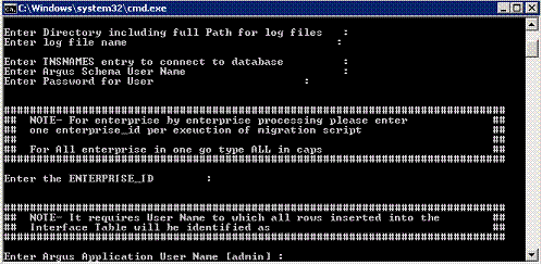

Execute this script to populate the already encoded terms from all cases to the Interface schema table. This script supports two types of migration:
To migrate encoded terms for case data for a particular enterprise, provide an enterprise_id such as 1.
When you have multiple enterprises in the Argus Safety multi-tenant environment:
To migrate encoded terms of case data for one enterprise only, provide only one enterprise_id such as 1 when prompted.
To migrate encoded terms of case data for all enterprises in one go, provide input as ALL when prompted.
To migrate encoded terms of case data for some enterprises (but not all), the number of executions of dms_migration.bat = Migration of encoded terms of case data for the number of enterprises.
Note: This migration script does not check whether the Argus Centralized Coding module is enabled for any specific enterprise. You must verify that module is enabled and then migrate data for enterprises.To populate terms to the Interface table, you must load MedDRA into the Argus schema. The migration script populates already encoded terms from all cases to the Interface table. Any open cases in the application are processed during migration. |
Execute the batch file dms_migration.bat.
Enter the TNSNAMES of the Argus Safety database when the Interface schema was created.
Provide the Argus Safety schema owner name and password.
Depending on whether you want to migrate coded terms for all cases, one enterprise or for multiple enterprises:
i. Enter the enterprise_id of one enterprise to migrate data for that particular enterprise.
ii. Enter ALL as Input to migrate data for all enterprises.
iii. To migrate coded terms of cases for more than one enterprise, execute step (i) multiple times and provide different enterprise_ids.
Provide the application user name; if no input is provided, admin is taken as user input.
Verify the log file to validate successful completion of the script.
