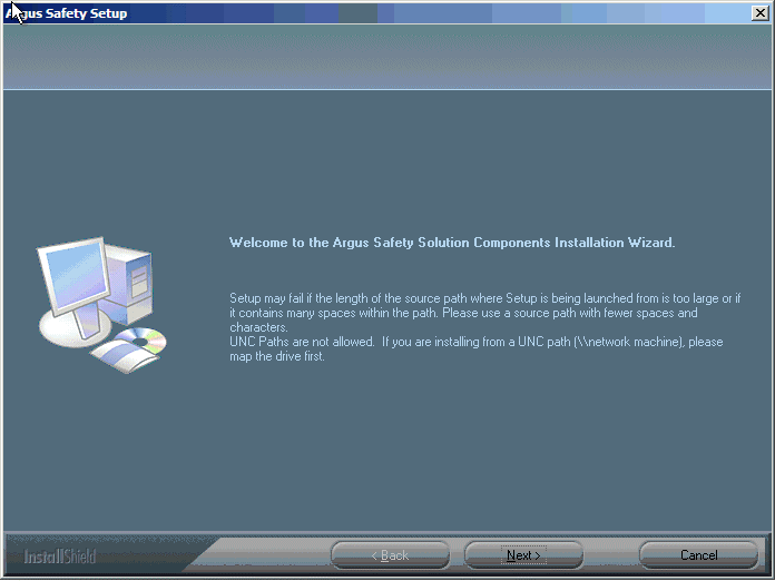

Click Argus Safety.
When the system displays the Argus Safety Solutions Components Installation Wizard: Click Next > to continue.

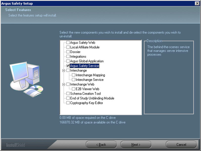

When the system opens the Argus Safety Components list:
Select Argus Safety Service from the list.
Click Next >.

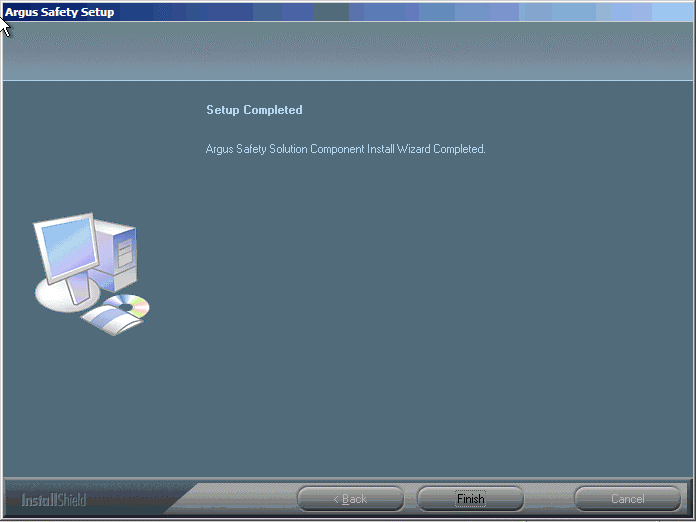

When the system displays the Setup Completed dialog box: Click Finish.

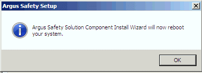

When the system displays the Argus Safety Setup dialog box: Click OK to reboot the system.

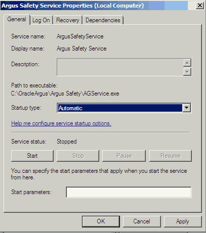

Select Start > Control Panel > Administrative Tools.
Double-click the Component Services shortcut.
Locate Argus Safety Service in the list of services and select Properties.
The following screen is displayed when the system opens the Argus Safety Service Properties dialog box:
Select Automatic from the Startup type drop-down list.

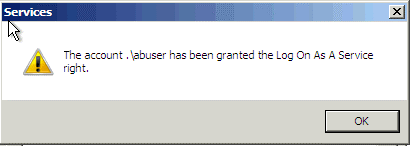

Enter the account log on name in the This account field.
Enter the log on password in the Password field.
Re-enter the log on password in the Confirm password field.
Click OK.
Note: The account you enter must be a domain account with access to the domain printers. |
When the system displays the Services dialog box with the following message: Click OK.
