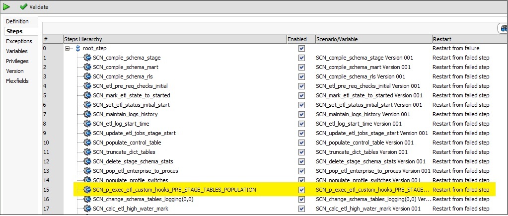

The ODI Load Plan lists all the ETL scenarios, as shown below:
Figure 2-1 ODI Load Plan
Surrounding text describes Figure 2-1 .

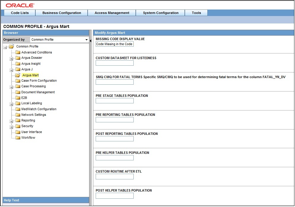

2.2.2 Viewing Argus Safety User Interface
ETL Hooks help in customizing the existing ETL to suit your requirements through Argus Safety user interface.
Follow the steps given below to view the Argus Safety user interface:
  1. Log in to the Argus Safety application.
  2. From the menu bar, click Argus Console.
    The menu bar updates for Argus Console.
  3. From the new menu bar, click System Configuration.
  4. Click System Management (Common Profile Switches).
    On the left hand side of the screen, a list of all system-managed common profile switches appears.
  5. Expand the Common Profile folder and click Argus Mart.
    The Modify Argus Mart page appears.
    ETL hooks are the global-level switches, visible on Argus Safety Console when you are logged-in through the default enterprise. These switches are visible only after installing and creating Argus Mart schema.
Figure 2-2 Argus Safety User Interface
Surrounding text describes Figure 2-2 .

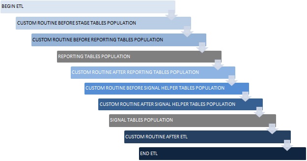

2.2.3 Executing ETL Hooks
The ETL Hooks can be executed at different staging levels.
  1. Before populating the reporting tables, execute CUSTOM ROUTINE BEFORE STAGE TABLES POPULATION, and/or CUSTOM ROUTINE BEFORE REPORTING TABLES POPULATION.
  2. Before populating the signal tables, execute ETL Hooks CUSTOM ROUTINE AFTER REPORTING TABLES POPULATION, CUSTOM ROUTINE BEFORE SIGNAL HELPER TABLES POPULATION, and/or CUSTOM ROUTINE AFTER SIGNAL HELPER TABLES POPULATION.
  3. After populating reporting and signal tables and before populating the results, execute CUSTOM ROUTINE AFTER ETL.
Figure 2-3 Sequence of ETL Hook Execution
Surrounding text describes Figure 2-3 .
Follow the steps given below to execute an ETL Hook:
  1. On the Modify Argus Mart page, enter a procedure name in the text box relevant to the ETL Hook execution stage. The ETL type can be initial or incremental where the customized data will be fetched. The ETL Hook will look for the database object that matches the procedure name.
    A procedure name denotes the ETL Hook that comprises the custom procedure, or steps. Based on the stage (initial or incremental) where this procedure is being called, the data is modified before sending it to the destination tables.
  2. If the database object (or procedure) is found, the ETL is executed as follows:
    • If the ETL executes without any errors, then move to the next procedure.
    • If the ETL executes with errors, then log the error(s) and exit.
      When executing ETL, if there is any error while populating the staging schema tables, error(s) are logged in the table ETL_STAGE_LOG, whereas while populating the mart schema tables, error(s) are logged in the table ETL_MART_LOG.
  3. If the database object (or procedure) is not found, then log the error(s) and fail the ETL. In this case, the ETL may be executed if you have explicitly created an exception-handling for such cases to absorb any exceptions and move on to the next procedure.
    Optionally, to resolve this issue, create a procedure of that name, provide an existing procedure name, or remove the configuration.

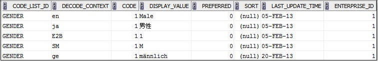

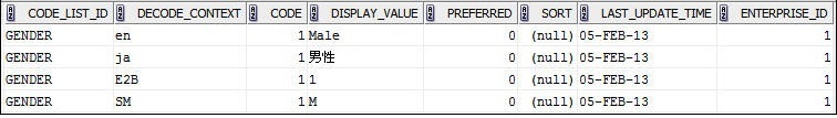

The following is an example to configure a code list display value in a new language for an already existing code in Argus Safety:
Example 2-1 Configuring Flexible Data Re-categorization
For a code list GENDER, data in the table CODE_LIST_DETAIL_DISCRETE for code 1 is available in the following four decode contexts (languages):
Figure 2-4 Original Decode Contexts (Languages)
Surrounding text describes Figure 2-4 .
To configure the same code 1 in the code list GENDER for a new language such as GERMAN (decode context ge), populate the table CODE_LIST_DETAIL_DISCRETE with required values in the GERMAN language.
INSERT INTO CODE_LIST_DETAIL_DISCRETE (CODE_LIST_ID, DECODE_CONTEXT, CODE, DISPLAY_VALUE, PREFERRED, SORT, LAST_UPDATE_TIME, ENTERPRISE_ID) VALUES ( 'GENDER', 'ge', 1, 'männlich', 0, null, sysdate, 1);
Figure 2-5 New Decode Contexts (Languages)
Surrounding text describes Figure 2-5 .

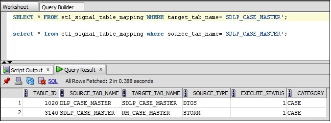

Example 2-2 Populating a new column in the RM table
Follow the steps given below to populate a new column in the table RM_CASE_MASTER:
  1. Check the mapping between RM_CASE_MASTER, and the source table (SDLP_CASE_MASTER) to fetch columns from the staging table into the RM table. In this case, the source type is STORM.
  2. Check the source table for target table (SDLP_CASE_MASTER), where columns are fetched from Argus Safety into the staging table. In this case, the source type can be ATOS/DTOS.
    Figure 2-6 Populating New Columns in the RM Table
    Surrounding text describes Figure 2-6 .
  3. Once the mapping of the tables has been identified, fetch these column(s) from Argus Safety/DLP into Argus Mart, as required.

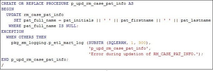

Example 2-3 Creating a custom procedure
Creating a procedure called P_UPD_RM_CASE_PAT_INFO, to populate a new column called PAT_FULL_NAME in the table RM_CASE_PAT_INFO. The value of this column is calculated, and populated from the existing columns of RM_CASE_PAT_INFO. Here, we concatenate three columns PAT_INITIALS, PAT_FIRSTNAME, and PAT_LASTNAME to populate this value as PAT_FULL_NAME.
  1. Create a procedure called P_UPD_RM_CASE_PAT_INFO.
  2. In the table RM_CASE_PAT_INFO, populate a new column called PAT_FULL_NAME.
  3. Concatenate three columns PAT_INITIALS, PAT_FIRSTNAME, and PAT_LASTNAME to populate this value as PAT_FULL_NAME.
    Figure 2-7 Creating Custom Procedure
    Surrounding text describes Figure 2-7 .
  4. Once this procedure is created, call this procedure using ETL Hook PRE_REPORTING_TABLES_POPULATION.
    The ETL Hook will populate this new column PAT_FULL_NAME in SDLP_CASE_PAT_INFO.

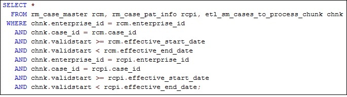

When using ETL Hooks to populate data into SM tables, it is recommended to use RM tables as the source, with join(s) to the chunk table ETL_SM_CASES_TO_PROCESS_CHUNK.
Do not use RM Views such as V_ETL_CASE_MASTER, because each view is joined individually to the chunk table. This can lead to sluggish performance of the application if ETL Hook extracts data from the multiple views.
Example 2-4 Populating data into SM tables using the chunk table
In the example given below, two RM tables RM_CASE_MASTER and RM_CASE_PAT_INFO have been joined with the chunk table ETL_SM_CASES_TO_PROCESS_CHUNK to fetch data into the SM table with the help of the ETL Hooks.
Figure 2-8 Populating Data into SM tables using Chunk Table
Surrounding text describes Figure 2-8 .

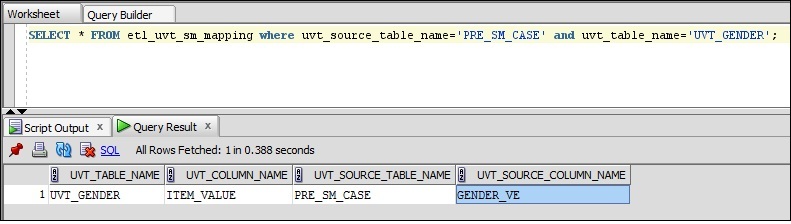

Example 2-5 Populating a custom UVT table
Follow the steps given below to populate a column in the table UVT_GENDER:
  1. Check the mapping between the source table PRE_SM_CASE and the target table UVT_GENDER from the table ETL_UVT_SM_MAPPING.
    Figure 2-9 Populating Custom UVT Table
    Surrounding text describes Figure 2-9 .
  2. After mapping the tables and their related columns, you can populate the column(s), as required.
