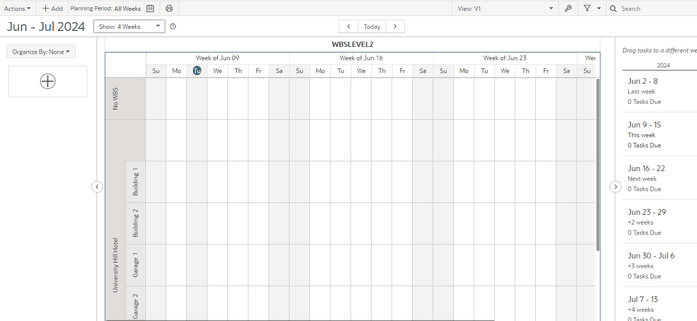

This screenshot displays the planning board after the project planner in applies their new task plan. The only swimlanes that display, according to the settings for this task plan, are the parent level WBS, University Hotel, and two levels beneath it, Garage 1 and 2, and Building 1 and Building 2.
Planning Board with WBS Swimlanes Screenshot
