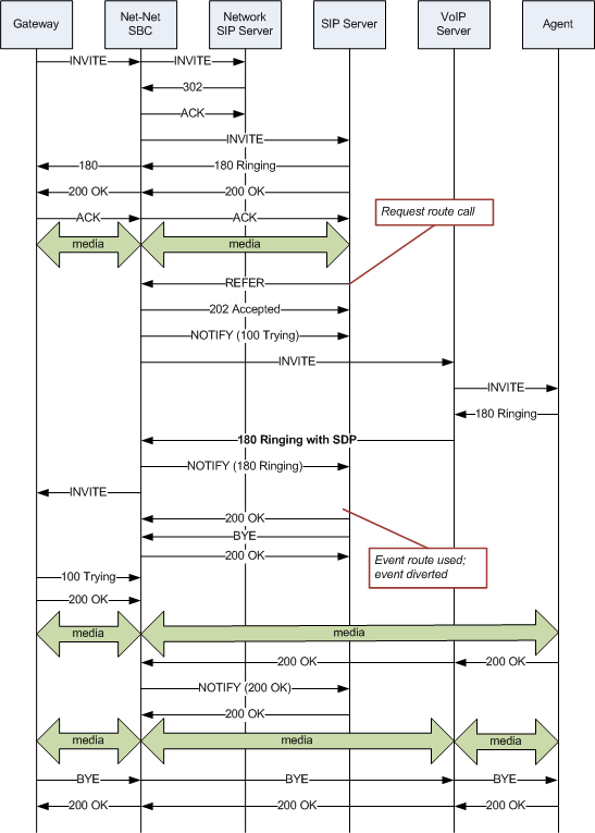

You can see how a sample call flow works without setting the refer-notify-provisional parameter.
When you compare the call flow above to the one depicting the scenario when the Oracle® Enterprise Session Border Controller has the refer-notify-provisional changed from its default, you can see that the Oracle® Enterprise Session Border Controller now response with a NOTIFY in response to the 202 Accepted and it sends another after the 180 Ringing.This causes the event to be diverted successfully.
