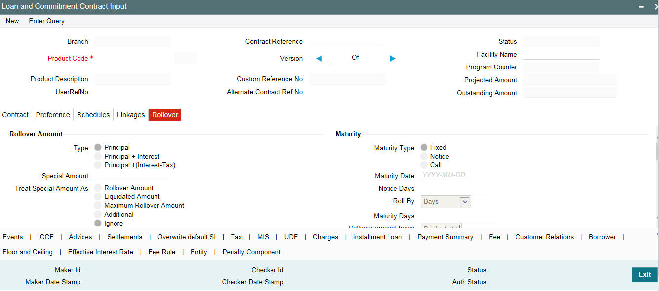

You can rollover a loan in the ‘Loans and Commitment – Contract Input’ screen. In the ‘Loans and Commitment – Contract Input’ screen, click ‘Rollover’ from menu.
At the time of contract creation, you can maintain/change the rollover instructions. Click ‘Rollover’ tab to rollover a contract maintain/change the rollover instructions. You can specify the rollover instructions (including interest rate of the main component and the refinance rate) for the rolled over contract. You can also amend the settlement details of the contract.
After specifying the rollover details, you need to save the contract. When you save the contract, the system completes the rollover process with the specified rollover instructions and a new version is created for the event ROLL.
To authorize the rolled over contract, both the versions created during rollover have to be authorized simultaneously.
By default, a contract is rolledover with all the terms of the original contract. However, you can change certain terms by specifying them in the Rollover Details screen.
In the Loan and Commitment- Contract Input Screens, click on the section Rollover to go to the Rollover Details section.
The following are the features of the contract rollover screen:

If you specify the ‘days’ maturity basis, and do not specify the maturity days, the system ‘rounds’ the tenor of the original contract to the nearest maturity days basis. The rounded tenor is considered as the new tenor of the rolled-over contract.
Example
For a loan, the value date of the original contract is 1st April 2001, and the maturity date is 15th March 2002. The maturity basis (Roll By) option is ‘Months’, and no maturity days have been specified.
The maturity date for the rolled over contract is arrived at as follows:
Tenor of the contract = Rounded off (number of months between 15th –March 2002 and 1st April 2001) = 11
Maturity date of the rolled over contract = (15th March 2002 + Tenor) = (15th March 2002 + 11) = 15th February 2003
If the maturity basis for the same contract would have been ‘Months’, and the maturity days is 10, the maturity date of the rolled over contract would be computed as:
Maturity date of rolled over contract = (15th March 2002 + maturity days taken in terms of the maturity basis) = (15th March 2003 + 10 months) = 15th January 2003
The interest basis indicates the manner in which interest for a specific component is calculated. You can select any one of the following as the basis on which the interest rate is picked up.
If you specify that the interest rate maintained at the Product level should form the interest basis then the product level interest rate is made applicable for the component at rollover. Similarly the rate maintained for the contract is made applicable if you specify that the Contract as the interest basis.
If you indicate that the interest basis should be User Defined then you have to specify the appropriate interest rate. The rate that you specify is made applicable to the respective component at rollover.
When a loan that is funded by a pool, is rolled over, you should specify the rate that will be used to arrive at the refinance income on the new contract.
You can amend rollover instructions for TD contract. The system amends the Rollover preferences, special amount preferences, and so on in the Rollover details.
Note
CAMD event is triggered when you upload amendment for rollover instruction
In the Product Events Definition screen, you can define the events for which advices are to be generated, for loans involving a product. An advice is generated when a loan is rolled-over, if specified to do so, for the product the loan involves. Generation of advices upon rollover, if specified, is as follows:
The operations on a loan like input, modification, manual liquidation and manual rollover have to be authorized by a user other than the one who performed the operation. All the loans should be authorized before you can begin the End of Day operations.
When a loan has been rolled-over manually, you have to do two authorizations:
When you call such a loan for authorization, the details of the liquidation of the original loan is displayed.
At the time of authorizing rolled over contracts, you need to enter the values for the re-key fields (specified at the product level).
