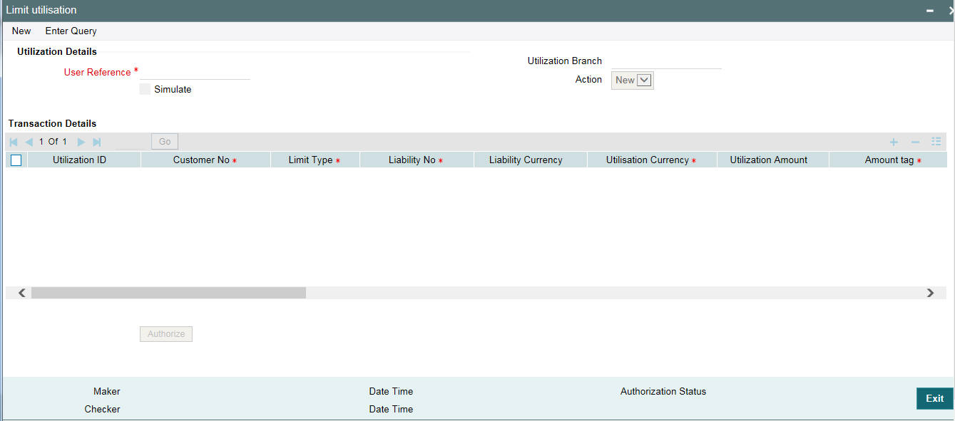

7.8 Utilization Transaction Screen
All utilization requests explained above can also be raised through the ‘Limit Utilization’screen.
You can invoke the ‘Limit Utilization’ screen by typing ‘GEDUTILS’ in the field at the top right corner of the Application tool bar and clicking the adjoining arrow button.
Note
The limit utilization feature explained in this section is available only if the Enterprise Limits and Collateral Management module has been set up in standalone mode. In case of em­bedded or hybrid setups, you cannot invoke this screen.
Utilisation Branch
Specify the branch where the utilization request should be processed. The adjoining option list contains all the branches maintained in the system. Select the appropriate one.
User Reference Number
Specify a unique reference number for the transaction.
Transaction Module
Specify the module for the transaction. The adjoining option list contains all the modules in the system. Select the appropriate one.
Transaction Date
Specify the date for the transaction.
Simulate
Check this box to indicate that the details for the transaction being entered should be used only for simulation and not stored permanently within the system. After a simulated transaction has been successfully put through, the system displays the utilized amount for the facility and the for the liability.
Customer Number
Specify a valid customer number for the transaction. The adjoining option list contains all the customers maintained in the system. Select the appropriate one.
Utilisation Amount
Specify the amount for the utilization transaction.
Utilisation Currency
Specify the currency for the amount entered. The adjoining option list contains all the currencies maintained in the system. Select the appropriate one.
Utilisation Product
Specify the product for the transaction. The adjoining option list contains all the relevant products. Select the appropriate one.
Uncollected Amount
Specify the amount that has not yet been collected from the customer.
Tenor Basis
Check this box to indicate that the utilization should be tracked tenor wise for the facility. You can specify the basis on which it is to be tracked in the ‘Tenor’ field.
Tenor
Enter the basis on which tenor tracking should be done for the utilization. You need to have checked the ‘Tenor Basis’ option before you can specify the basis here.
Maturity Date
Specify the date on which the transaction matures.
Amount Tags
Specify the component type for the transaction. The adjoining option list contains all the relevant tags. Select the appropriate one.
Remarks
Enter any additional remarks that you wish to maintain for this transaction. You can enter up to 255 characters.
Value Date
Specify the value date for the transaction.
Line Code
Specify the line code to be used for the transaction. The adjoining option list contains all the line codes allowed. Select the appropriate one.
Facility Block Reference Number
During a new utilization, you can specify a valid block reference number to increase the amount in a facility. On the basis of the block reference number, the system validates if the liability and facility details of the new utilization and the existing facility for which the block has been maintained match. If there is a match, it increases the amount available under the facility by unblocking the corresponding amount block for the facility and making it available for use by the new utilization.
Click the ‘Exposures’ button. In the screen that is displayed, you can specify the transaction exposures that the system should track while processing utilization requests. The system defaults the customer exposures.

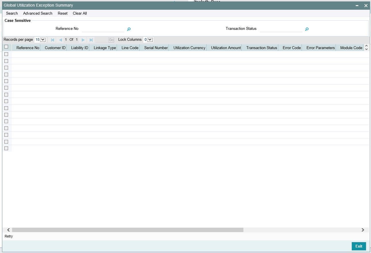

Viewing Mismatch Summary
You can view in the mismatch Summary screen all the counter transactions that has been performed by Oracle FLEXCUBE ELCM for handling the mismatches. The summary also indicates whether the counter transactions have succeeded or failed.

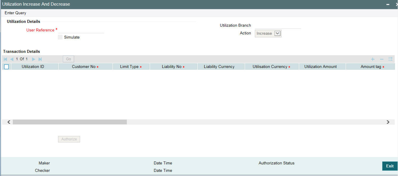

7.10 Increasing/Decreasing Utilizations
You can modify the utilization amount of the transaction through the ‘Utilization Increase And Decrease’ screen. This transaction can be used when customer is making payment for the loan or when the loan amount is modified.
You can invoke the ‘Utilization Increase and Decrease’ screen by typing ‘GEDUTNID’ in the field at the top right corner of the Application tool bar and clicking the adjoining arrow button.
Note
The feature explained in this section will be available only if the Enterprise Limits and Col- lateral Management module has been set up in standalone mode. In case of embedded or hybrid setups, you will not be able to invoke this screen.
Utilization Reference No
Specify the reference number for the utilization that you wish to modify. The adjoining option list contains all the utilizations in the system. Select the appropriate one. The system displays the user reference number, the utilization currency and the amount tag.
Utilization Amount
Enter the amount by which you wish to modify the utilization.
Action
Indicate the operation for the utilization – whether you would like to increase or decrease the utilization amount.
The ‘Limit Utilization’ screen will be displayed when you click on the ‘Details’ button where you can view the details of the original utilization request.

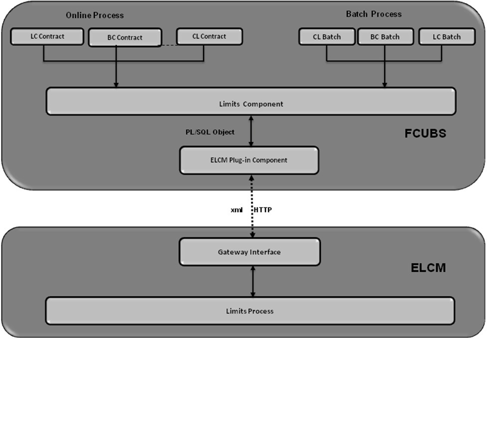

The below diagram briefs the Utilization Transaction Integration Approach flow between Oracle FLEXCUBE and ELCM:

As part of the contract or transaction process, if a line code is linked to a contract then it is required to track the limits of the linked line. The system exposes limits process as subsystem and any module would interact with Limits subsystem.
The system allows you to trap all the utilization transaction. The system would interface with
ELCM Gateway HTTP to upload the utilization transactions in ELCM. Based on the utilization event, the system creates utilization request in ELCM format. It also logs transaction data and status of each utilization transaction.

7.12.2 Global Utilization Exception Summary
Global Utilization Exception Summary report is used for checking the response status (errors or overrides) of global utilization. In case of failure, you need to rectify manually.
You can invoke the ‘Global Utilization Exception Summary’ screen by typing ‘ELSGLOUT’ in the field at the top right corner of the Application tool bar and clicking the adjoining arrow button.
