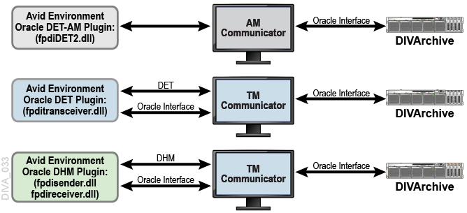

The following figure represents the overall workflows for Avid Connectivity in each instance:
Avid Connectivity Workflow Overview

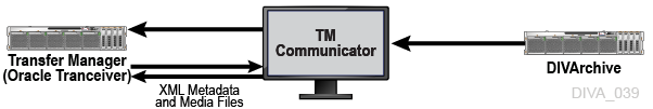

The figure below demonstrates the TM Communicator DET Restore Workflow.
TMC DET Restore Workflow
