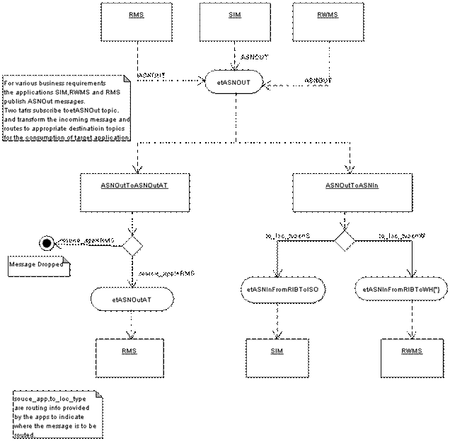

ASNOut (Advanced Ship Notification Out of the warehouse/store) messages are published by a warehouse or stores system as part of its shipping process. These messages are published when a truck/train/… is loaded with items destined for a store or warehouse. The expectation is that the electronic ASNOut message will arrive at the store/warehouse inventory system or the merchandizing system before the shipment physically arrives at the store/warehouse. An ASNOut Rib Message node is specific to a single source/destination combination.
For the destination store or warehouse, the logic to process these incoming messages is already in place for the ASNIn (Advanced Ship Notification Into a warehouse/store). Hence, this TAFR has the purpose to transform the ASNOut message into an ASNIn message and route the output message to the correct warehouse instance or store inventory system.
Other interested parties to the ASNOut messages, such as a merchandizing system, must subscribe to the original etASNOut topic as a separate subscriber. This TAFR is only concerned with transforming and routing on behalf of a store or warehouse system.
In RMS, on-line shipping and receiving functionality allows clients to setup their system such that shipping and receiving can be done within RMS if a separate store or warehouse system is not used. Shipments created within RMS will be published out as ASNOut messages.
In RMS, shipments can also be created for wholesale/franchise returns. These wholesale franchise returns are essentially transfers from wholesale/franchise stores to company stores/warehouses. For SIM or RWMS to receive these shipments, they need to have a valid ASN to receive against. This requires RMS to publish shipments created for wholesale/franchise returns.
To appropriately route these, RMS created ASNOut messages have a routing info tag called “source app” to support TAFR functions. This TAFR look at this addition routing info tag.
The routing information may contain "source app" name set by RMS when it publishes ASNOut messages. ("source app" == RMS). The ASNOutToASNInLoc TAFR should filter these messages, and route all other messages based on the other routing info requirements.
