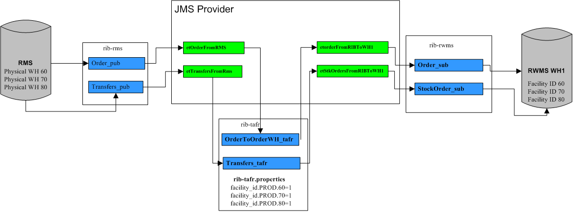

One of the common configurations requirements is to set up the flow of transfers and orders to RWMS. This is based on Facility ID.
These examples and step-by-step instructions illustrate how to configure a TAFR for one and two RWMS deployments.
RIB allows stock based transactions to be routed between different RWMS instances. An RWMS instance is assigned to a physical distribution center which may have one or more facilities assigned to it. A company may have one or more distribution centers.
By default the standard RIB configuration is set for a single RWMS instance. This means that all physical warehouses in RMS route directly to a single RWMS instance (in this case denoted as WH1) with each RMS physical warehouse directly correlating to a facility ID in RWMS.
Modify the TAFR routing settings:
For each physical warehouse set up in RMS there should be a matching entry in the rib-tafr.properties file. This file resides in the $RIB_HOME/application-assembly-home/rib-tafr directory and is used by the TAFR adapters, amongst other things, to route messages by facility ID to the correct RWMS instances.
The file by default contains the following mappings:
facility_id.PROD.1=1
facility_id.PROD.2=1
facility_id.PROD.3=1
The routing properties are structured in the following way: facility_id.<FACILITY_TYPE>.<RMS_PHYSICAL_WH_ID>=<RWMS_INSTANCE_NAME>
<FACILITY_TYPE> - This should match the facility_type.default value in the rib-tafr.properties file, in most cases this would be left as the default value which is "PROD".
<RMS_PHYSICAL_WH_ID> - The physical warehouse ID from RMS.
<RWMS_INSTANCE_NAME> - The RWMS installation topic name identifier that the warehouses messages will be routed to.
These mappings must be edited so that each physical warehouse in RMS has its own entry. The physical warehouses can be found by running the following query in the RMS schema:
SELECT wh FROM wh WHERE wh.wh = wh.physical_wh;
For the example in the diagram above, physical warehouse IDs 60, 70 and 80 would be returned by the query.
There is only one RWMS instance (WH1) in this example and the RWMS installation topic name identifier is simply "1". This corresponds to the name of the topics that the RIB routes the messages to. This is also the default name suffix of the RWMS topics in the rib-integration-flows.xml file.
Therefore, our mapping in the rib-tafr.properties file should read:
facility_id.PROD.60=1
facility_id.PROD.70=1
facility_id.PROD.80=1
Deploy the settings to the rib-tafr instance:
The new TAFR routing settings need to be migrated to the rib-tafr instance. To do this run the following script found in the $RIB_HOME/deployment-home/bin directory.
rib-app-deployer.sh -deploy-rib-app-ear rib-tafr
Configuration should now be complete.

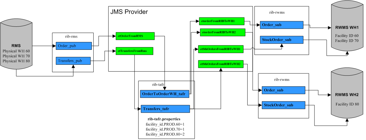

RIB can be configured to route stock based transactions between multiple distribution centers, each with their own RWMS instance. The purpose of this is to only send stock transactions that will be shipped to or from a certain warehouse to the distribution center that contains that warehouse (facility).
From RMS the user only has visibility to the warehouse that they are performing a stock shipment to or from, the RIB TAFR's then route the messages to the separate RWMS instances based on the configuration stated in the "rib-tafr.properties" file. In the above example, RMS physical warehouses 60 and 70 are assigned to the RWMS instance called WH1 while RMS physical warehouse 80 is assigned to another RWMS instance called WH2.
<FACILITY_TYPE> - This should match the facility_type.default value in the rib-tafr.properties file, in most cases this would be "PROD".
<RWMS_INSTANCE_NAME> - The RWMS installation topic name identifier that the warehouses messages are routed to.
Before editing the file for multiple RWMS instance routing, the user should know which RMS physical warehouses are to be routed to the particular RWMS instances and the RWMS installation topic name identifiers.
For the example in the diagram above physical warehouse IDs 60 and 70 are routed to RWMS instance WH1 where the RWMS installation topic name identifier is "1" and RMS physical warehouse ID 80 are routed to RWMS instance WH2 where the RWMS installation topic name identifier is "2". To support this the mapping in the rib-tafr.properties file should read:
facility_id.PROD.80=2
Modify the rib-integration-flows.xml file:
The RIB requires information on how to route the messages between the two RWMS instances. This is done by adding new entries to the rib-integration-flows.xml file.
By default the file contains entries for the RWMS instance "rib-rwms" and all appropriate warehouse based adaptor mappings point to the et<TOPIC_NAME>WH1 topics. When adding multiple RWMS instances all the entries for RWMS need to be duplicated for the second instance "rib-rwms2" and all adapter mappings for the new instance need to point to et<TOPIC_NAME>WH1 topics.
The entire "RWMS PUBLISHERS" section in the integration-flows.xml file needs to be duplicated and all new entries need to be changed to the second RWMS instance name of "rib-rwms2" for example:
<node id="rib-rwms2.ASNIn_pub" app-name="rib-rwms2" adapter-class-def="ASNIn_pub" type="DbToJms"><in-db>default</in-db><out-topic>etASNIn</out-topic></node>
Each RWMS adapter mapping in the file that follows the et<TOPIC_NAME>WH1 format needs to be duplicated as well but needs to point to et<TOPIC_NAME>WH2. With the original adapter mapping and the new adapter mapping to route to the second RWMS instance, for the Stock Order adapter, the entry should be similar to the following example:
<node id="rib-rwms.StockOrder_sub" app-name="rib-rwms" adapter-class-def="StockOrder_sub" type="JmsToDb"><in-topic>etStkOrdersFromRIBToWH1</in-topic><out-db>default</out-db></node>
<node id="rib-rwms2.StockOrder_sub" app-name="rib-rwms2" adapter-class-def="StockOrder_sub" type="JmsToDb"><in-topic>etStkOrdersFromRIBToWH2</in-topic><out-db>default</out-db></node>
The rib-integration-flows.xml file can be edited and then deployed in the following way:
cd $RIB_HOME/application-assembly-home/rib-func-artifacts
jar -xvf rib-func-artifact.war
cd integration
vi rib-integration-flows.xml
Make the changes specified above.
jar -uvf rib-func-artifact.war integration/rib-integration-flows.xml
The new TAFR routing settings need to be migrated to the rib-tafr instance, to do this run the following script found in the $RIB_HOME/deployment-home/bin directory.
Deploy the settings to the functional artifact:
The new integration flow settings need to be migrated to the rib-func-artifact instance, to do this run the following script found in the $RIB_HOME/deployment-home/bin directory.
rib-app-deployer.sh -deploy-rib-func-artifact-war
Note: For every new physical warehouse added to RMS the rib-tafr.properties will require a new entry and the new settings will need to be deployed to the instance. |
Note: Multiple RWMS instances can be added as per the instructions above. |
