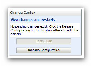

  3. Click Lock & Edit.

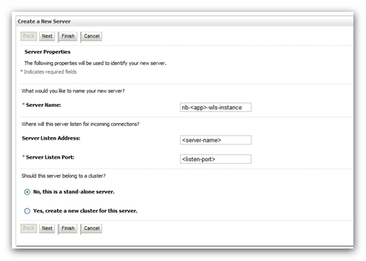

  4. Click New.
  5. Enter the name, port, and listen address of the server instance to be created.
    For example:
    • Server Name: rib-<app>-server
    • Server Listen Address: <server-name>
    • Server Listen Port: <listen-port>
  6. Click Next. Click Finish. Make sure you see this instance listed under Servers

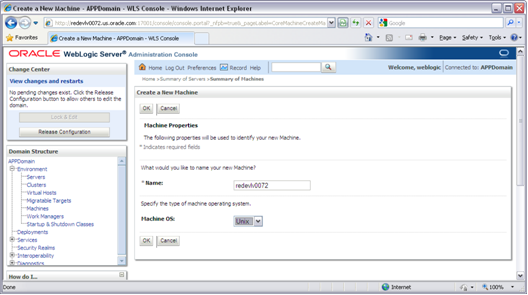

  1. Log in to the administration console.

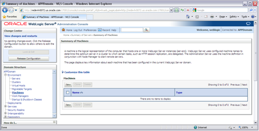

  2. Click Lock & Edit and navigate to Environments> Machines.
  3. Click New.
  4. Set the following variables:
    • Name: Logical machine name
    • Machine OS: UNIX
  5. Click OK.

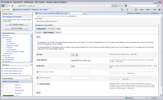

  6. Click on the machine created
  7. Click the NodeManager tab and update the details below.
    • Type: Plain
    • Listen Address: For example, ribhost.example.com
    • Listen Port: Default port (for example, 5556) or any available port
  8. Click Save.
  9. Click Activate Changes.

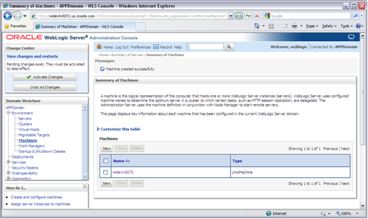

  10. Click Lock & Edit.
  11. Navigate to Environments > machines. Click on the machine name and select the Servers tab.
  12. Add the managed servers that need to be configured with NodeManager. Save the changes.
  13. Click Add to repeat for additional servers.
  14. Click Activate Changes.
