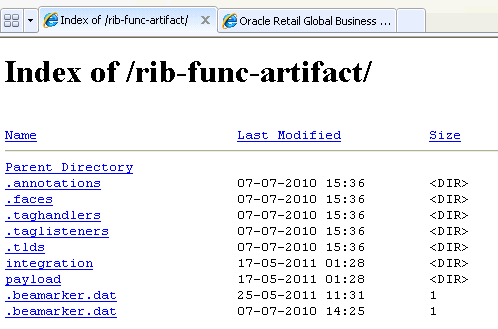

If an Error 403-Forbidden screen is received upon launching the rib-func-artifact URL, complete the following steps to enable indexing & correct the error.

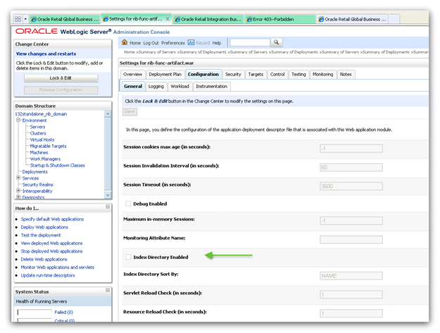

  1. Go to the configuration tab of the rib-func-artifact.war deployment in the WLS console. In the Change Center, click Lock & Edit. Check the Index Directory Enabled box, as shown in the following illustration.

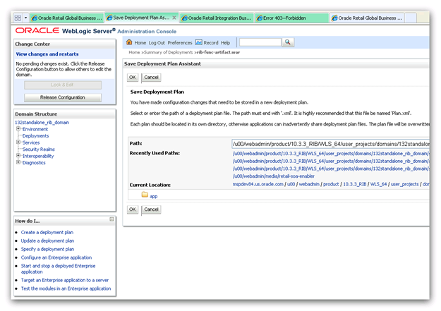

  2. Click Save. Click OK to save deployment plan.
  3. In the Change Center, click Activate Changes and relaunch the rib-func URL.
