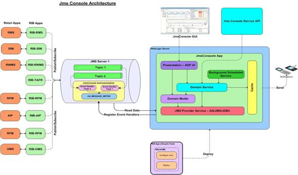

The architecture of JMS Console employs a modular design using separate layers for domain, service, and presentation. The service layers are implemented using stateless session beans using standard JavaEE 6 specifications. The presentation layer uses Oracle Application Development Framework (ADF).

The following diagram describes the console architecture.
The AQ JMS that the application is monitoring is configured as a JNDI <expand> data source in the application server. The application dynamically discovers the topics and subscribers configured in the AQ. The application interfaces with the AQ JMS using PL/SQL API's provided by the AQ and uses instrumentation techniques to collect the statistics using PL/SQL procedures.
Monitoring data is stored in the same AQ schema that the application is configured to monitor and manage. The PL/SQL package JMS_MONITORING_AGENT is responsible for providing instrumentation hooks and data sourcing capabilities. Monitoring data is stored in the AQ_MESSAGE_METRIC table. The following the table structure definition of the AQ_MESSAGE_METRIC table:
