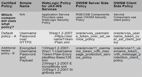

There are two types of security configurations certified for RSB by Oracle Retail. For ease of use these are classified and referred in this document as Policy A and Policy B.
Each of these certified approaches involve a set of security policies. The following table describes the required set of policies for Policy A and B.
Service providers are the endpoint services which are invoked by the decorator proxy and business services; therefore edge app services must be secured first and based on the message-level and transport-level authentication required by them, the proxy and business services are secured with similar configurations.

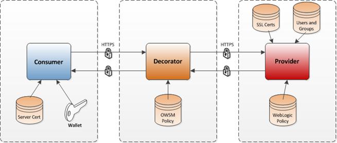

Policy A is a Username Token over HTTPS. This security configuration is referred to as Policy A in this document.
Wssp1.2-2007-Https-UsernameToken-Plain.xml
Policy A is selected as the default policy for the following reasons:
Most widely (SSL) used policy
Easy to configure and setup
Data going over the wire is encrypted and is secure
Interoperable between WebLogic and OWSM policy
Good performance for the level of security provided
Good support from all programming languages

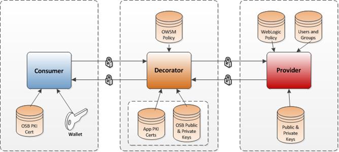

Policy B is a Message Protection plus username token. This security configuration is referred to as Policy B in this document.
Wssp1.2-2007-Wss1.1-UsernameToken-Plain-EncryptedKey-Basic128
Wssp1.2-2007-EncryptBody
Wssp1.2-2007-SignBody
It is highly recommended that the personnel who implement security carefully consider their options and take a strategic decision that benefits their business.
The following facts are true for the encrypted username/password/payload Policy B:
Payload is encrypted/decrypted in the SOAP infrastructure layer and not in the TCP/IP layer.
The policy is complicated to set up in the WebLogic server and OWSM.
Since encryption and decryption is happening higher up in the stack, the performance is slower.
Limited support from other programming languages.
