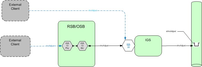

Functional Description
RMS subscribes to the InvAdjust information as published from the RIB. This Web Service will accept the RIB InvAdjust Object and publish it to the RIB JMS topics for processing by the RIB RMS InvAdjust Subscriber.
Technical Description
Services
igs-InvAdjustPublishingService |
Description |
Inventory Adjustment msg are published onto the RIB.RMS uses this data to Adjust overall quantities of stock on hand for an item at a location and to Adjust the availability of item-loc quantities. Topic Name : etInvReq Subcriber = InvReq_sub (RMS). |

publishInvAdjustCreateUsing |
This Operation invokes the publishing of "Create" event for the Inventory Adjustment. |
