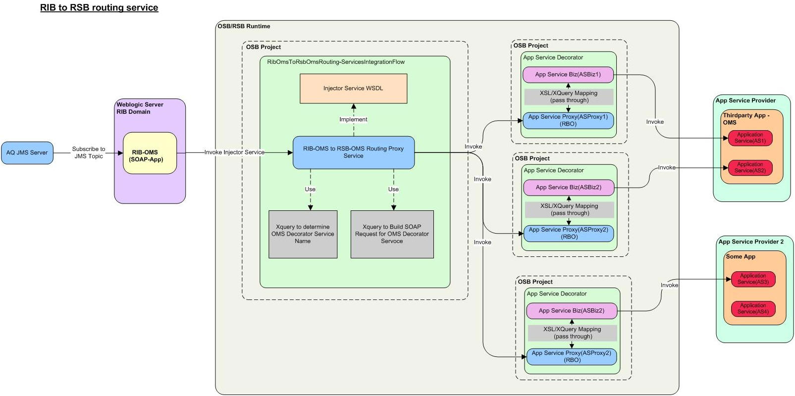

The RIB integrates with the Web service providers (example: OMS) using an injector service. This section contains details about the security configuration required on RIB side.End application (OMS) Web services can be secured with policyA or policyB. For more details on application service security, see the Oracle Retail Service Backbone Security Guide.
Figure 2-1 RIB to RSB Routing Service
Surrounding text describes Figure 2-1 .

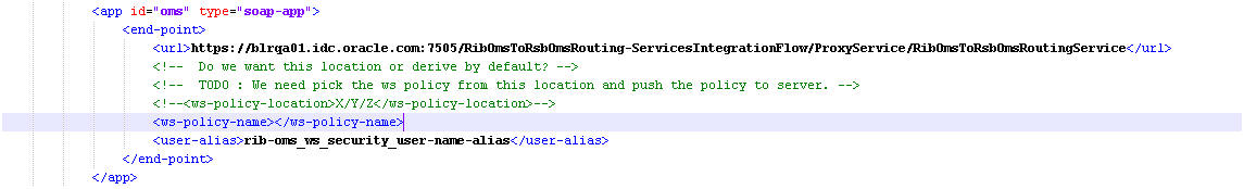

Provide the RibOmsToRsbOmsRoutingService URL, user-alias, and ws-policy-name information in rib-deployment-env-info.xml file present under rib-home/deployment-home/conf. The endpoint URL should be the secured injector service URL and user alias should be in <rib-app>_ws_security_user-name-alias format i.e. rib-oms_ws_security_user-name-alias. The ws-policy name should be either policyA or policyB depending on the OMS application Web service configuration.
Figure 2-2 RIB-OMS Security Configuration
Surrounding text describes Figure 2-2 .

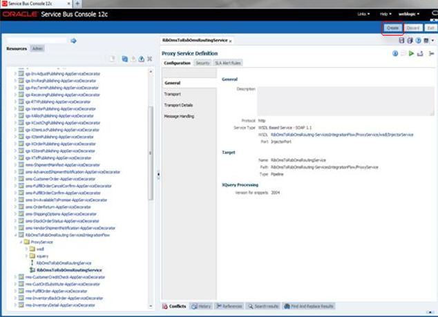

  1. Click the routing service proxy RibOmsToRsbOmsRoutingService. The following window appears. Click Create button on Service Bus Console.
    Figure 2-3 Edit a Proxy Service
    Surrounding text describes Figure 2-3 .

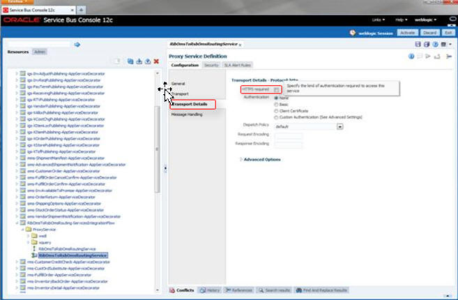

  2. Click Transport Details and select the HTTPS required option.
    Figure 2-4 HTTP Transport Configuration
    Surrounding text describes Figure 2-4 .

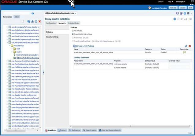

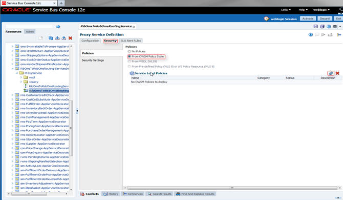

  3. Click on Security Tab and select "From OWSM Policy Store".
    Figure 2-5 Service Policy Configuration
    Surrounding text describes Figure 2-5 .

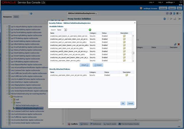

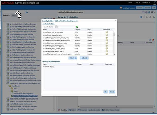

  4. Click the Attach Policies button. The following window appears.
    Figure 2-6 Attach Policies
    Surrounding text describes Figure 2-6 .
  5. Select ”oracle/wss_username_token_over_ssl_service_policy”, click Attach button and then click OK button.
    Figure 2-7 Select Policy
    Surrounding text describes Figure 2-7 .

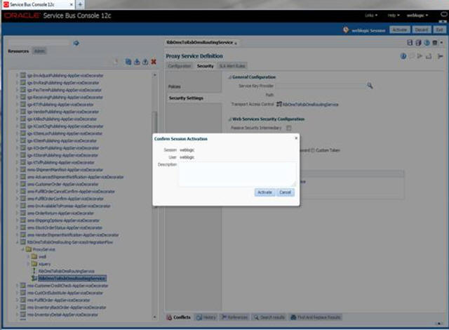

  7. Click Activate and Submit to save the session.
    Figure 2-9 Activate and Save
    Surrounding text describes Figure 2-9 .
