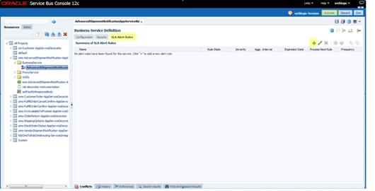

  1. Click on the Business Services link in Resource Browser of OSB console.
  2. Click the service for which you want to add the alert.
    Surrounding text describes image021.jpg.

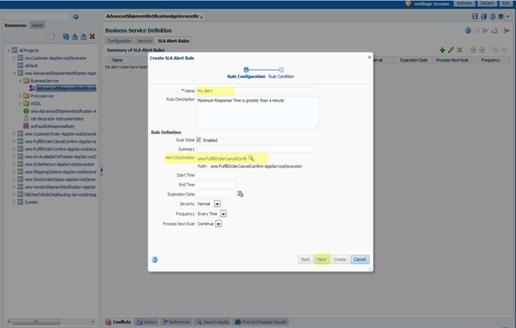

  3. Select the SLA Alert Rules tab. Click Add.
    Surrounding text describes image022.jpg.
  4. Enter Rule Name and Alert Destination corresponding to the decorator.
    Surrounding text describes image023.jpg.

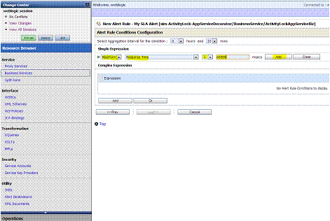

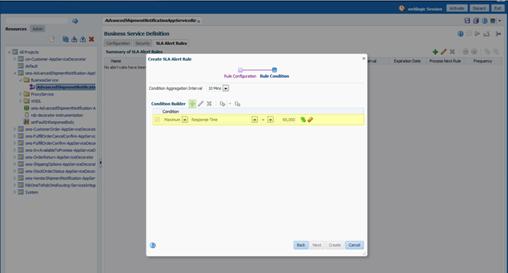

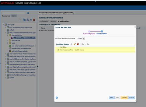

  5. Construct the Alert Rule Condition as shown in the following screen:
    Surrounding text describes image024.jpg.

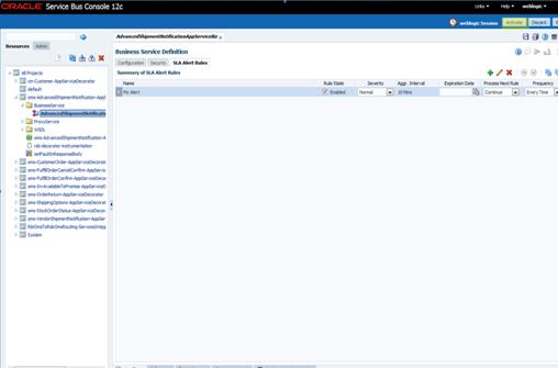

  6. Save the alert and activate the session.
    Surrounding text describes image025.gif.
  7. Click Update and then Create.
    Surrounding text describes image026-1.jpg.
  8. Activate the session.
    Surrounding text describes image026-2.jpg.
