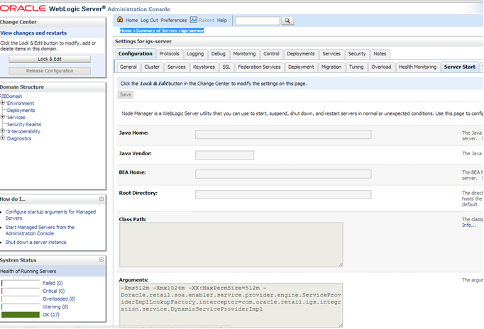

Add the server start argument for IGS managed server. This can be done from the WLS console, or in the startWebLogic.sh and startManagedWebLogic.sh scripts.
To edit the scripts, add the following to startWeblogic.sh and startManagedWebLogic.sh under $DOMAIN_HOME/bin:
JAVA_OPTIONS="-Doracle.retail.soa.enabler.service.provider.engine.ServiceProviderImplLookupFactory.interceptor=com.oracle.retail.igs.integration.service.DynamicServiceProviderImpl ${JAVA_OPTIONS}"
To edit the server start arguments in the WebLogic console, click igs-server -> Server start as below:

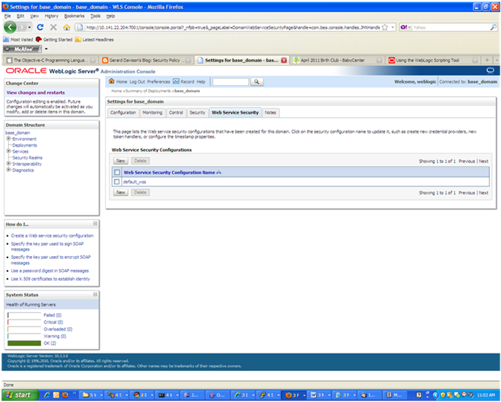

IGS Web services can be secured in two ways. One approach is simple user name and password authentication. For the other approach, passwords are encrypted with certificates.
The following describes both approaches for server-side and client-side setup.
Note: The various policy files that can be used to secure Web services are listed in the ws-policy tab of the Web service in the WebLogic Server Administration Console. |

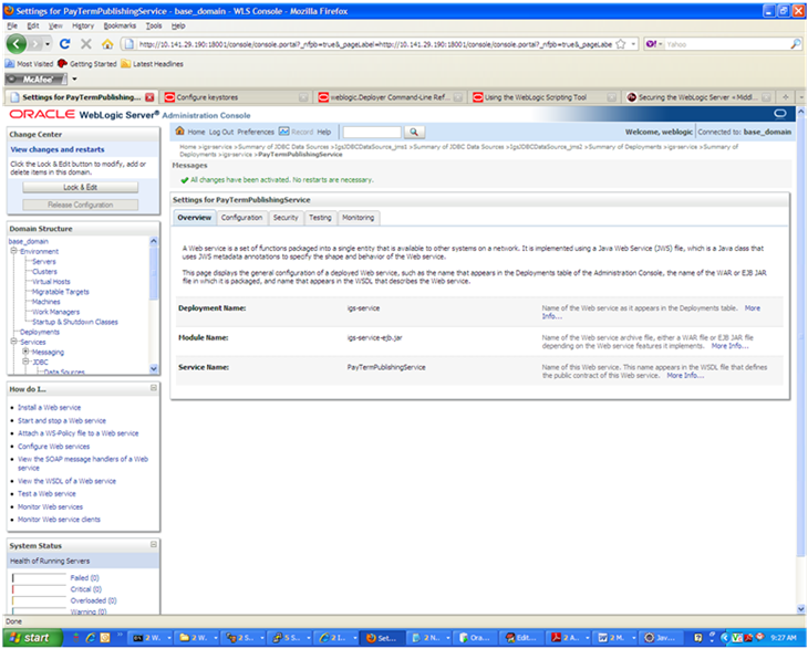

In the Summary of Deployments screen, click the application. In the illustration below, the application is igs-service.

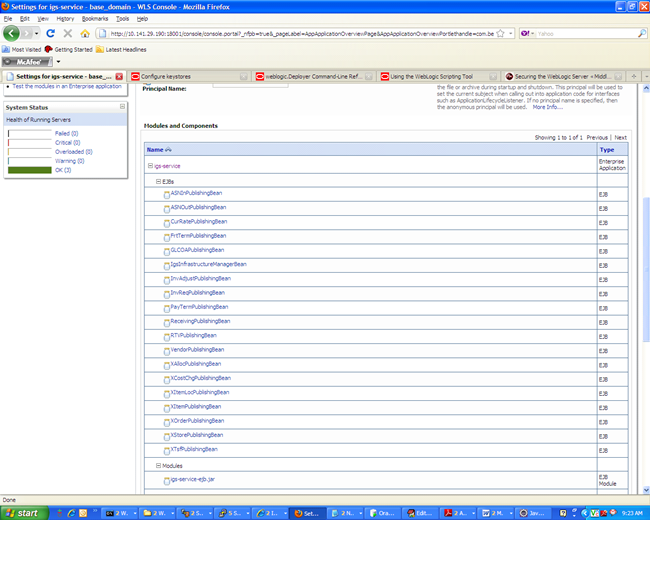

An overview page is displayed, including a list of modules and components installed as part of the application.

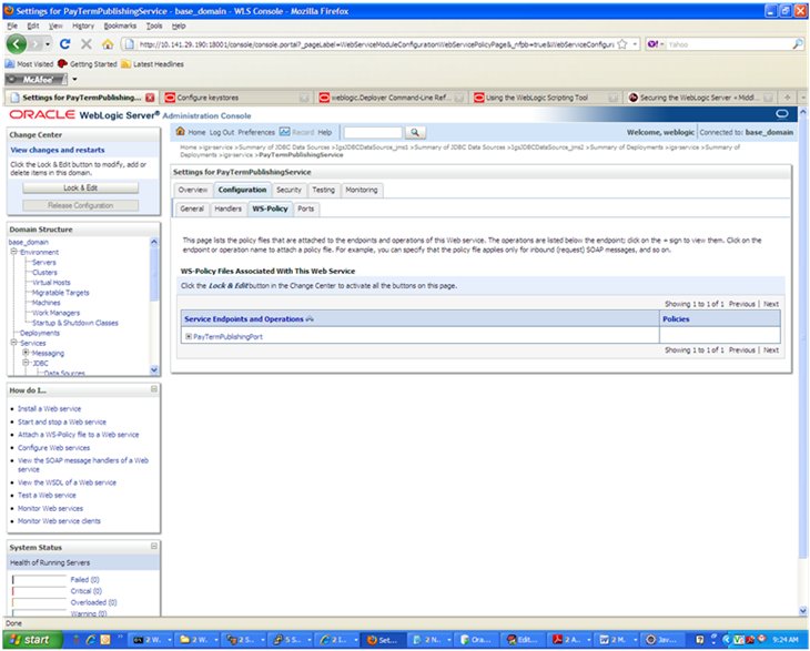

In the Web service list, click the service for which you want to enable security. The following screen is displayed to provide an overview of the Web service.

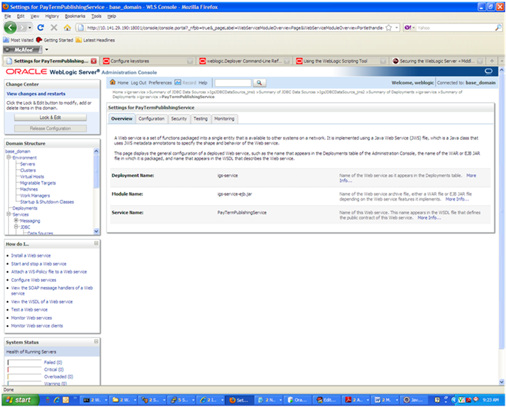

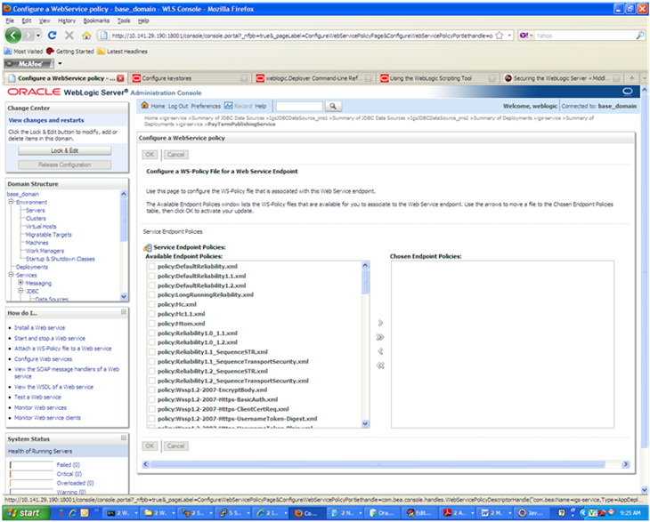

On this overview screen, click the Configuration tab. Click the WS-Policy tab. The Web service port is shown under Service Endpoints and Operations.
Click the plus sign next to the port name. The Web service operations are displayed.
You can secure all the Web service operations at once or select only the operations you want to secure. Click the name of the port. On the Configure a Web Service policy screen, you can attach the policy file to the Web service. Select WebLogic and click the Next button.

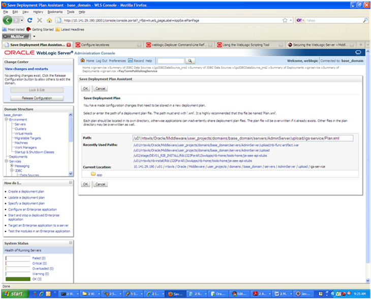

From the Available Endpoint Policies list, select policy:usernametoken.xml. Click the right arrow to move it to the drop down list below Chosen Endpoint Policies. Click OK. The Save Deployment Plan Assistant screen is displayed.

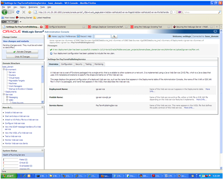

At the bottom of the Save Deployment Plan Assistant screen, click OK. The following screen is displayed, including status messages near the top.
Click Activate Changes. The following screen is displayed.

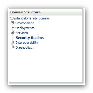

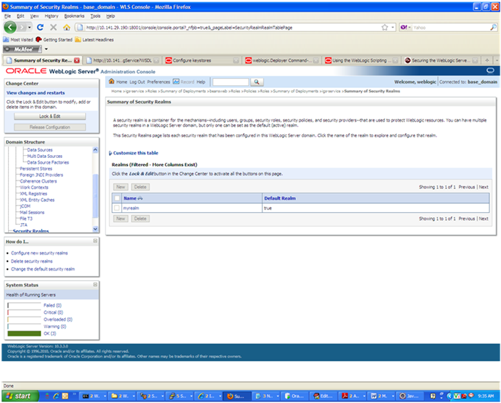

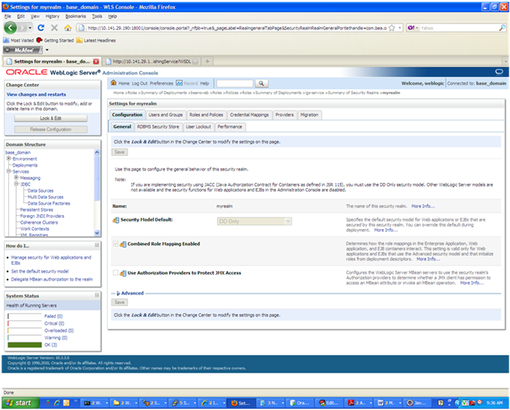

In the Domain Structure window of the Oracle WebLogic Services Administration Console, click the Security Realms link.
The Summary of Security Realms screen is displayed, including the name of the default realm.
Click the name of the default realm. The settings for the realm are displayed.

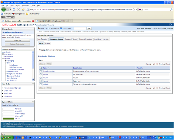

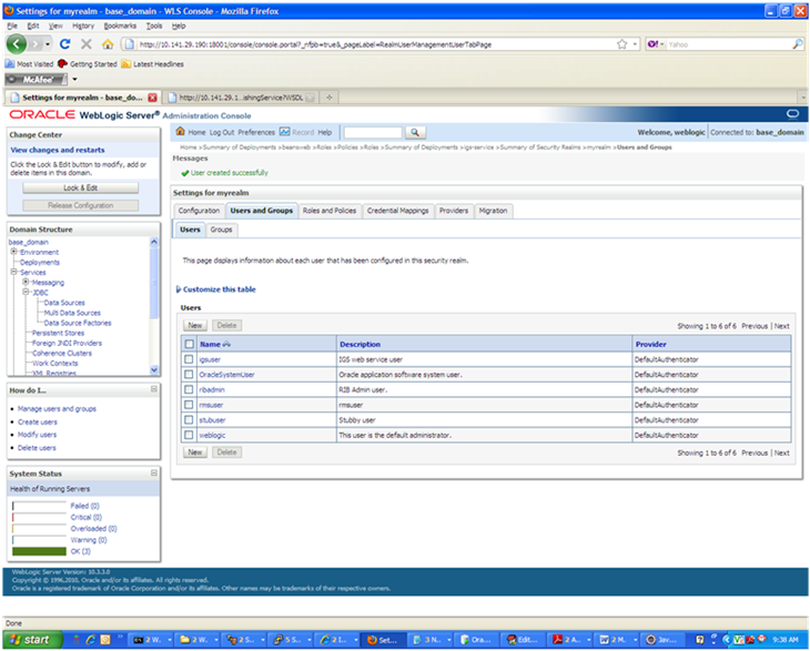

On the Settings screen, click the Users and Groups tab.

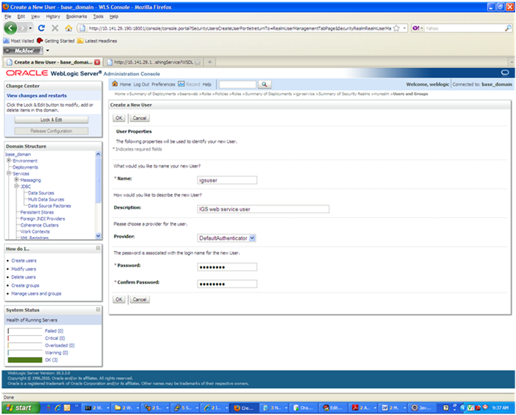

In the Users and Groups tab, click the Users tab. At the bottom of the Users tab, click New. The Create a New User screen is displayed.
In the Create a New User screen, enter a user name and password. Leave the default value for Provider. Click OK to save the information. The new user is added to the list of users.
Note: You can add roles from the Roles and Policies tab of the security realm or through the Security tab of the Web service. The following instructions are for creating a role through the Security tab of the Web service. |

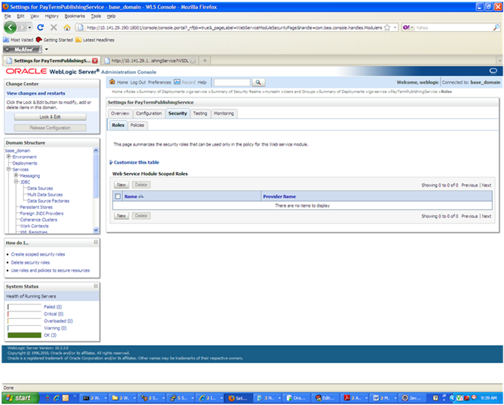

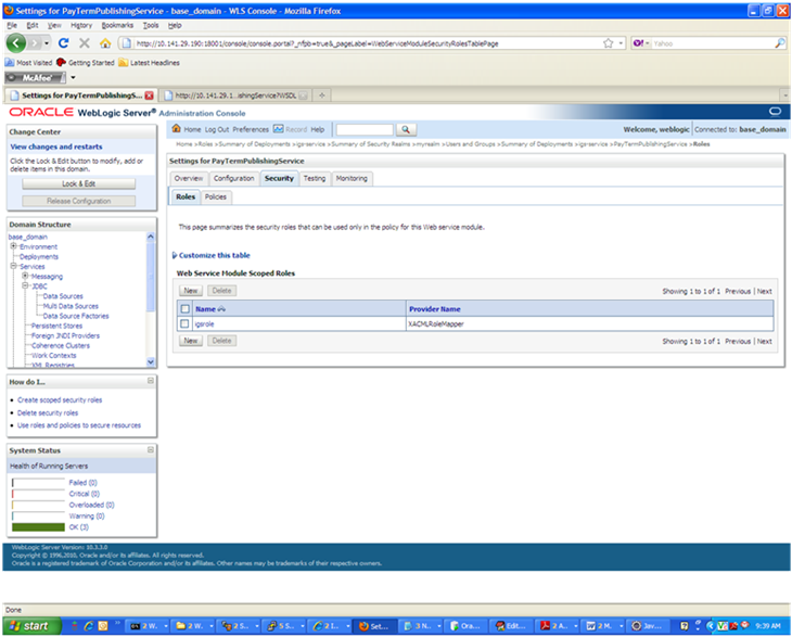

Navigate to the Security tab of the Web service. Click the Roles tab.

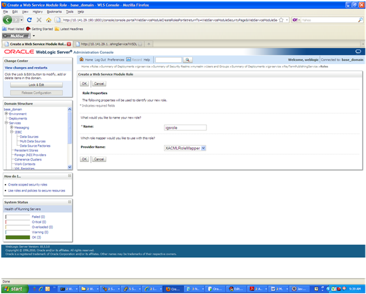

In the Roles tab, click New. The Create a Web Service Module role screen is displayed.
In the Create a Web Service Module Role screen, enter the role name in the Name field (for example, rmsrole). Leave the default value in the Provider Name field. Click OK. The new role is displayed in the Roles tab of the Web service.

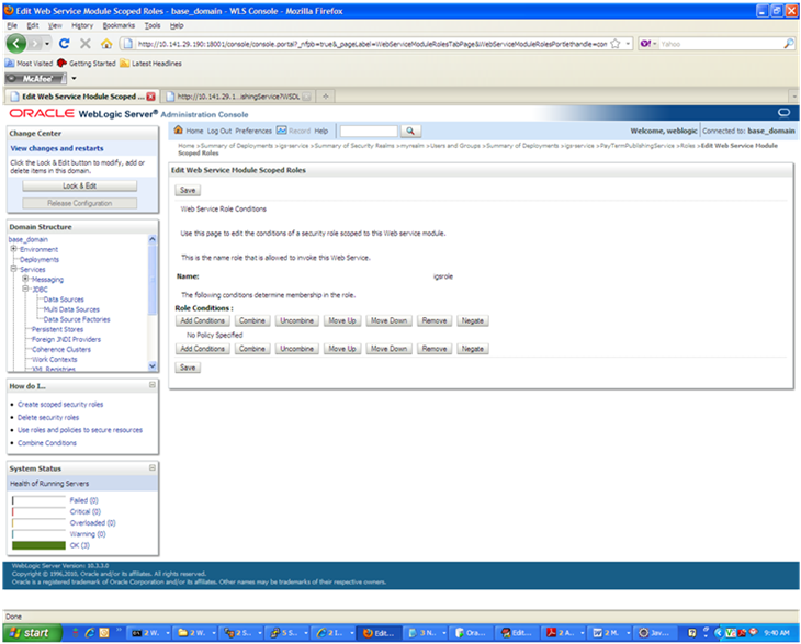

To add the user to the role, click the name of the new role in the Roles tab. The Edit Web Service Module Scoped Roles screen is displayed.

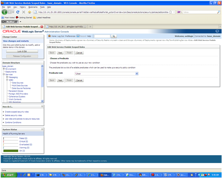

In the Edit Web Service Module Scoped Roles screen, click Add Conditions. The "Choose a Predicate" option is displayed.
From the Predicate List, select User. Click Next. The Edit Arguments argument is displayed.
In the User Argument Name field, enter the user name created in the security realm. Click Add. The name will move down to the box below the Add button. Click Finish. The following screen is displayed.
Click Save. The same screen is displayed with this message near the top: "Changes saved successfully."

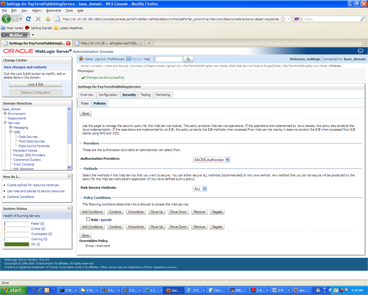

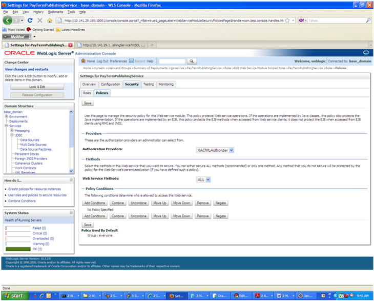

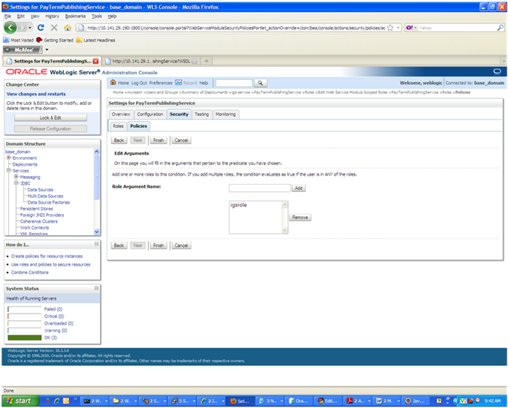

Return the Security tab of the Web service and click the Policies tab.

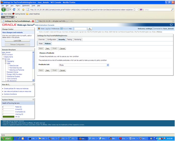

On the Policies tab, click Add Conditions. The "Choose a Predicate" option is displayed.
From the Predicate List, select Role. Click Next. The Edit Arguments option is displayed.
In the Role Argument Name field, enter the role name created earlier. Click Add. The role name will move down to the box below the Add button. Click Finish to return to the Policy Conditions screen.
Click Save. The Policy Conditions screen is displayed with this message near the top: "Changes saved successfully."

In the WebLogic logic console, check the Web Service Security tab to verify that the command ran properly. Note that the default_ww configuration is used for all Web services unless otherwise indicated.
After the certificate setup is completed for the Web service, follow the steps in the "Create Roles and Users" section to create a user in WebLogic to access the Web service.
