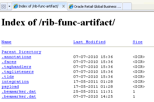

If an Error 403-Forbidden screen is received upon launching the rib-func-artifact URL, complete the following steps to enable indexing & correct the error.

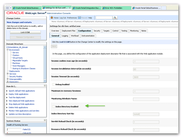

  1. Go to the configuration tab of the rib-func-artifact.war deployment in the WLS console. In the Change Center, click Lock & Edit. Check the Index Directory Enabled box, as shown in the following illustration.
    Surrounding text describes RIB-FUNC1.png.

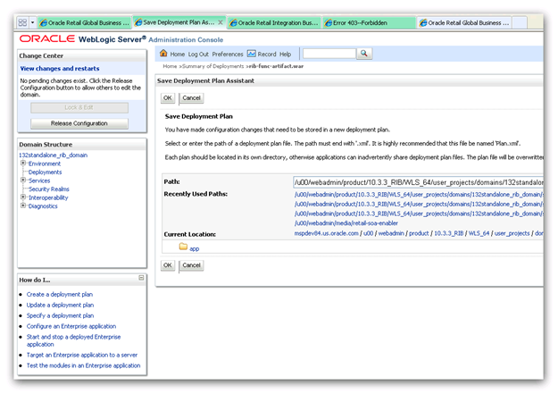

  2. Click Save. Click OK to save deployment plan.
    Surrounding text describes RIB-FUNC2.png.
  3. In the Change Center, click Activate Changes and relaunch the rib-func URL.
    Surrounding text describes RIB-FUNC3.png.
