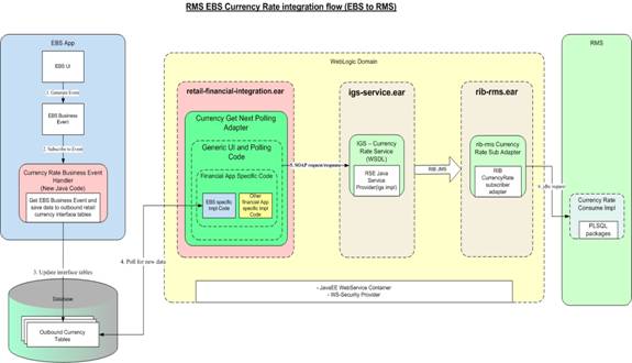

The diagram illustrates the currency exchange rate integration flow with EBS:-
The integration flow uses the following services:
CurrencyRateBES - Business Event Subscriber
Currency EJB Service
IGS Currency Service
RIBforRMS CurRate Subscriber
When the process is initiated, the following steps would occur:
Oracle E-Business Suite invokes the Business Event Subscriber Java class CurrencyRateBES whenever a currency exchange rate is created or loaded into Oracle E-Business Suite.
The Business Event Subscriber Java class CurrencyRateBES extracts all the currency exchange rates from the Oracle E-Business Suite Business Event object and moves the currency exchange rates into RFI Database Staging table RFI_CURR_RATE_STAGE.
A Configured Timer for Currency service invokes the Currency EJB service.
The Currency EJB service picks up the records from the RFI Database Staging table RFI_CURR_RATE_STAGE and transforms the Currency Code and Currency Exchange type using the CURR_CODE_DVM and CURR_CONV_TYPE_CODE_DVM respectively.
Then IGS Currency Service is invoked with the transformed currency rate record.
If there are any errors in Currency EJB service, the errors are added to the logs file. The Currency logs can be viewed using the RFI Adapter Manager screens in RFI Administration GUI.

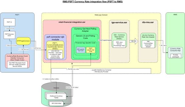

The diagram illustrates the currency exchange rate integration flow with PeopleSoft:-
CURRENCYRATEBUSINESSEVENTHANDL- Business Event Handler
Currency Web Service
PeopleSoft invokes the Business Event Handler service whenever a currency exchange rate is created or loaded into PeopleSoft E-Business Suite.
The Business Event Handler service "CURRENCYRATEBUSINESSEVENTHANDL "extracts currency exchange rates created from the PeopleSoft invokes Currency Web Service in RFI.
The RFI Service moves the currency exchange rates into RFI Database Staging table RFI_CURR_RATE_STAGE and sends back a response to PeopleSoft

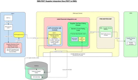

This diagram illustrates the supplier integration flow with PeopleSoft:
These services are specific to sync supplier integration flows:
SUPPLIERBUSINESSEVENTHANDLERSE - Business Event Handler
Supplier EJB Service
RMS Supplier Service
RIBforRMS Vendor Subscriber
When you initiate the process:
Oracle Payables invokes the "SUPPLIERBUSINESSEVENTHANDLERSE" Business Event service whenever a supplier is created or updated.
The Business Event service extracts all the supplier, supplier sites and supplier contacts from the PeopleSoft Business tables and moves the supplier, supplier sites and supplier contacts into RFI Database Staging tables RFI_SUPP_STAGE, RFI_SUPP_SITES_STAGE, RFI_SUPP_CONTACTS_STAGE respectively.
A Configured Timer for RFI Supplier service invokes the Supplier EJB service.
The Supplier EJB service picks up the records from the RFI Database Staging tables RFI_SUPP_STAGE, RFI_SUPP_SITES_STAGE, RFI_SUPP_CONTACTS_STAGE and transforms the Organization id using ORG_ID_XREF, Currency Code using CURR_CODE_DVM, Language using LANGUAGE_DVM, Payment terms and Freight terms using PAYMENT_TERMS_XREF and FREIGHT_TERMS_XREF respectively.
Then RMS Supplier Service is invoked with the transformed supplier records. If there are any errors in Supplier EJB service, the errors are added to the logs file. The Supplier logs can be viewed using the RFI Adapter Manager screens in RFI Administration GUI.
If the transaction is successful, Retail Id cross references for supplier, supplier site are stored in the cross reference table RFI_XREF_DVM. The cross references updated is SUPPLIER_XREF, SUPPLIER_SITE_XREF respectively.
Note: Transformation applies the DVM and invokes create or update web service from RMS. It also updates the cross-reference table after the Retail web service call. |

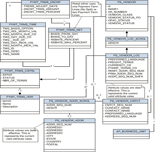

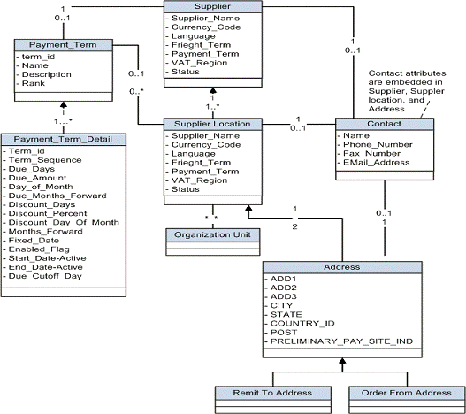

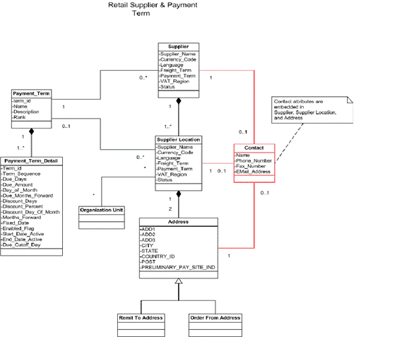

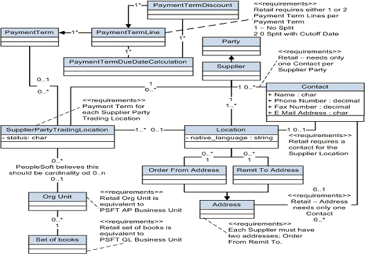

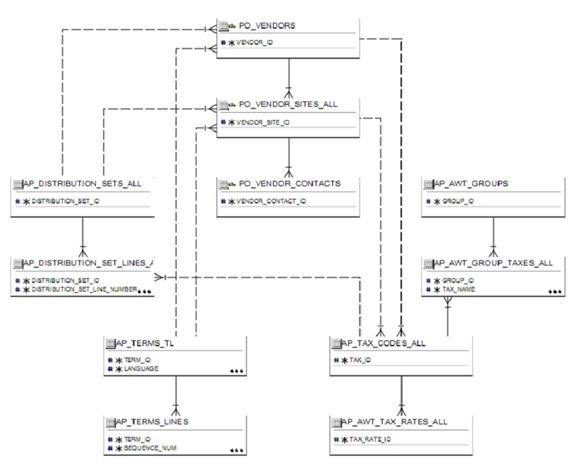

The process integration for supplier information requires the following data:
Suppliers must be assigned to at least one GL business unit (set of books)
For this integration, Oracle suppliers must be created with these status attributes:
Classification of supplier. Other type of vendors such as attorneys, employees, and HCM are not synchronized with Oracle Retail. All suppliers except employee are synced.
The Open for ordering option is selected. If the supplier is approved but is not open for ordering, the RFI layer on the RMS side changes its status to inactive. EBS doesn't have an approval status.
Note: Only contacts associated with supplier sites or addresses will be synchronized from Oracle Payables to RMS. |
For Retail to Oracle Financials integration, only certain suppliers with specific criteria are sent to Retail:
Supplier must have at least one or more address or site
Supplier address or site must be a purchasing and/or a payment purpose.
If a supplier has one address or site, it must be both a purchasing and payment purpose.
If a supplier has two or more addresses, one address may be a purchasing site and other address a payment site.
Supplier address or site without a purchasing or payment purpose will not be sent to Retail.
Only Supplier address or site(s) which are active, are interfaced to Retail. Deactivate date for the site should either be NULL or a future-date in Oracle Financials (EBS or PeopleSoft).
In the contact details and purpose, the phone area code, fax number and email address are meant for general contact information such as a main operator number or a general company inquiry email address. This information should not be passed to Retail.
In EBS, Under Company Profile --> Contact directory, there is contact information for specific people and their specific contact information. For example, the Account Receivable person's phone #, name, and email address is listed here. This information is passed to Retail.

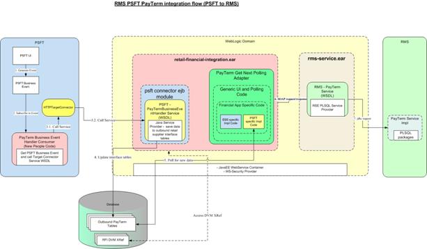

The diagram illustrates the Payment terms integration flow:-
PAYTERMBUSINESSEVENTHANDLERSER- Business Service Handler
Payment Terms EJB Service
RMS Payment Terms Service
RIBforRMS Payterms Subscriber
PeopleSoft invokes the Business Event service "PAYTERMBUSINESSEVENTHANDLERSER" whenever a payment terms is created or loaded into PeopleSoft which in turn calls the service in RFI.
The Business Event service extracts all the payment terms details from PeopleSoft tables and moves the details into RFI Database Staging table RFI_TERMS_HEAD and RFI_TERMS_DETAIL.
A Configured Timer for payment terms service invokes the Payment Terms EJB service.
The Payment Terms EJB service picks up the records from the RFI Database Staging table RFI_TERMS_HEAD & RFI_TERMS_DETAIL.
Then RMS Pay terms Service is invoked with the payment terms record.
If there are any errors in Payment terms EJB service, the errors are added to the logs file. The Payment terms logs can be viewed using the RFI Adapter Manager screens in RFI Administration GUI.

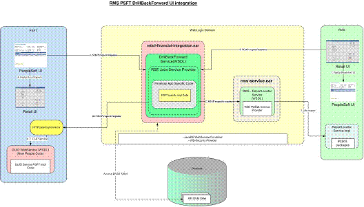

The diagram illustrates the drill forward and drill backward flow:-
The integration discusses uses the following services:
Drill Back Service
Drill Forward Service
Overall Flow
The drill back enables the user to:
Query ReIM using the payment voucher ID from the PeopleSoft Payables user interface (UI) to find invoices, credit notes, and debit memos that are used to generate the payment voucher.
Query RMS and ReSA from the PeopleSoft GL UI to find the source transactions that generated the journal entry in the ledger for revenue recognition and cash deposit postings.
Query RMS stock ledger from the PeopleSoft GL UI to find the source transactions for inventory valuation postings.
Query ReIM from the PeopleSoft GL UI to find the source transactions for aged receipt write-offs, manually paid invoices, and matched pre-paid invoices.
This integration uses the DrillBackForwardURLService.
