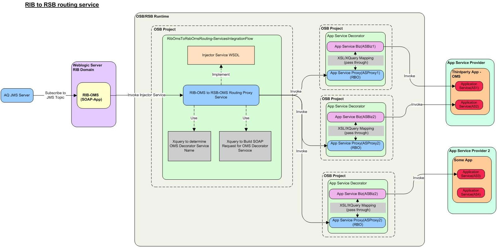

The RIB integrates with the Web service providers (example: OMS) using an injector service. This section contains details about the security configuration required on RIB side.End application (OMS) Web services can be secured with policyA or policyB. For more details on application service security, see the Oracle Retail Service Backbone Security Guide.

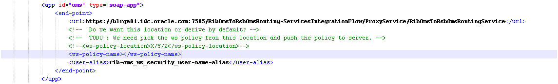

Provide the RibOmsToRsbOmsRoutingService URL, user-alias, and ws-policy-name information in rib-deployment-env-info.xml file present under rib-home/deployment-home/conf. The endpoint URL should be the secured injector service URL and user alias should be in <rib-app>_ws_security_user-name-alias format i.e. rib-oms_ws_security_user-name-alias. The ws-policy name should be either policyA or policyB depending on the OMS application Web service configuration.

Security policies needs to be applied on each layer listed below:
Application Web services secured with policyA or policyB.
Decorators, which are proxy to actual application service, will also have security policies applied.
Injector service which is a bridge between the RIB and the RSB will also have security policies applied.
For more information on applying security policies to decorator services, see Oracle Retail Service Backbone Security Guide.

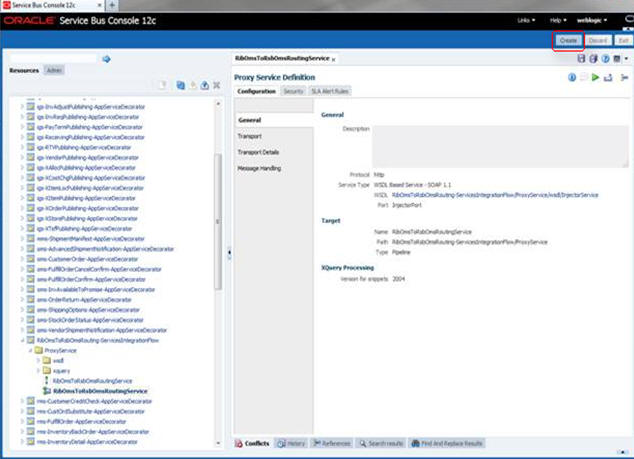

Take the following steps to apply security policies in a routing service:
Click the routing service proxy RibOmsToRsbOmsRoutingService. The following window appears. Click Create button on Service Bus Console.

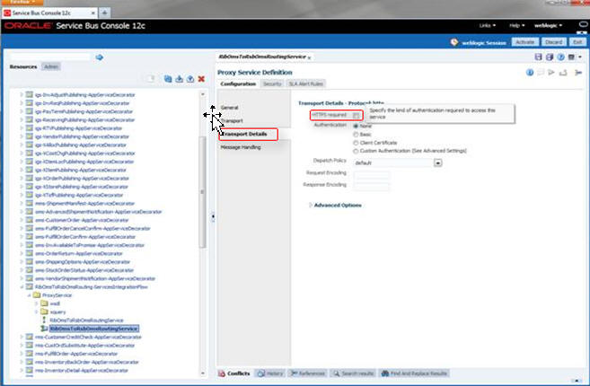

Click Transport Details and select the HTTPS required option.

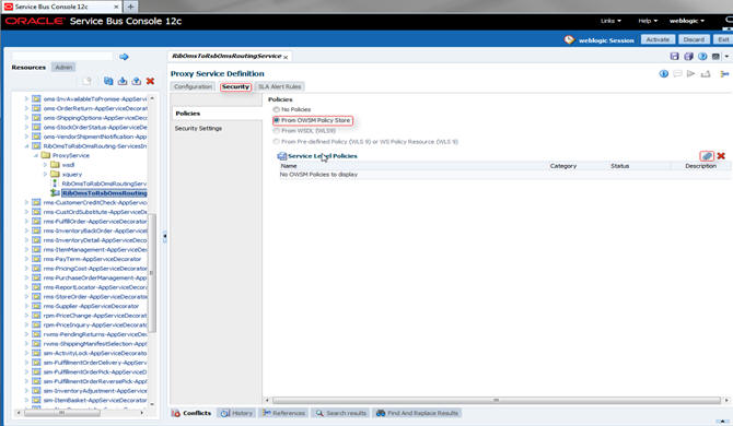

Click on Security Tab and select "From OWSM Policy Store".

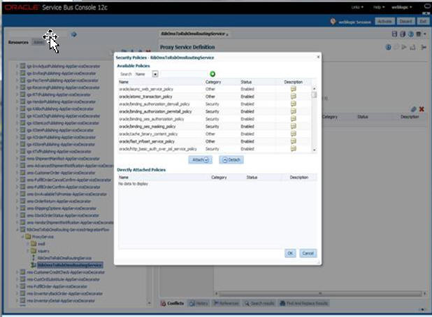

Click the Attach Policies button. The following window appears.

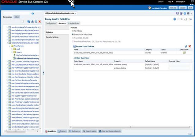

Select ”oracle/wss_username_token_over_ssl_service_policy”, click Attach button and then click OK button.
Click Save to save changes.
Click Activate and Submit to save the session.
