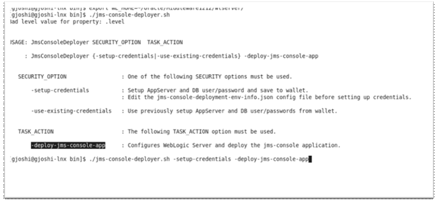

Run the deployer script to create the datasource and deploy JMSconsole.
$ cd jmsconsole/bin/ $ sh jms-console-deployer.sh -setup-credentials -deploy-jms-console-app
Enter the parameter value prompted by the script.
