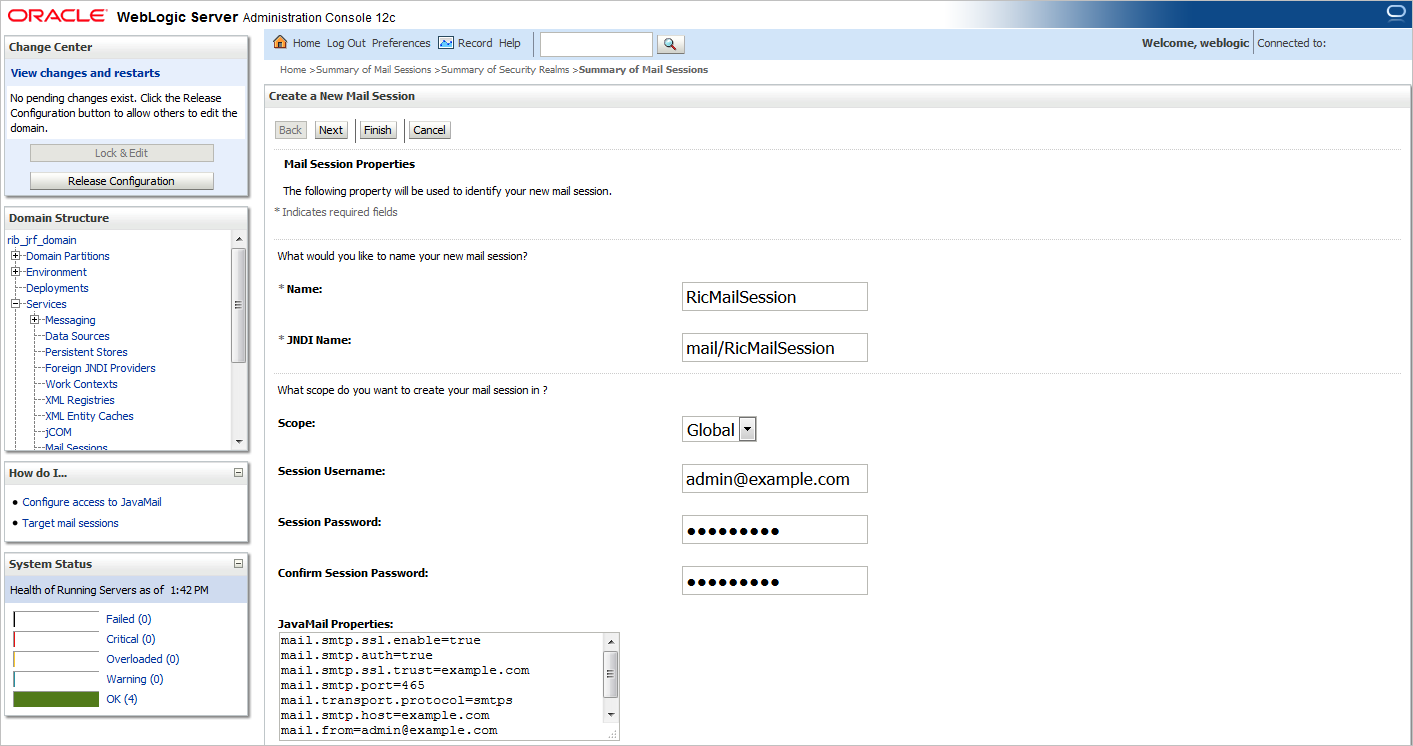

Configure a new mail session as below on the Weblogic server where you deploy RIC. This is for RIC to send notification emails on exceeding the error thresholds.
Login to the Weblogic admin console.
Navigate to Admin Console > Services > Mail Sessions.
Create a new mail session with the JNDI Name as "mail/RicMailSession".
Add the below JavaMail properties:
mail.smtp.ssl.enable=true
mail.smtp.auth=true
mail.smtp.ssl.trust=example.com
mail.smtp.port=465
mail.transport.protocol=smtps
mail.smtp.host=example.com
mail.from=admin@example.com
