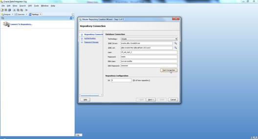

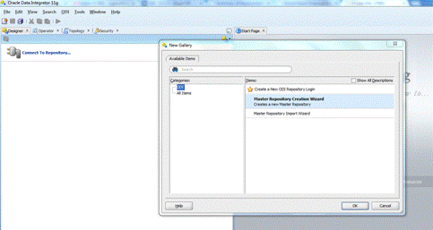

  1. Launch Oracle Data Integrator (ODI) Studio to create a Master Repository:
    Click File->New and select "Master Repository Creation Wizard" and click OK.
    Figure 9-1 Master Repository Creation Wizard
    Surrounding text describes Figure 9-1 .
  2. Enter the Master Repository Database connection details and click Next.
    • Database Connection - Enter valid Master Repository schema details.

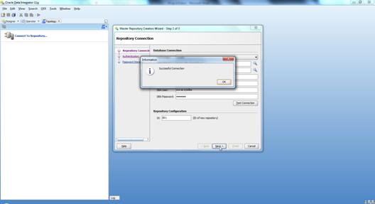

  3. Test your credentials information using the Test Connection button. If you are successful, click OK in the Information popup and then click Next.
    Figure 9-3 Test Connection
    Surrounding text describes Figure 9-3 .

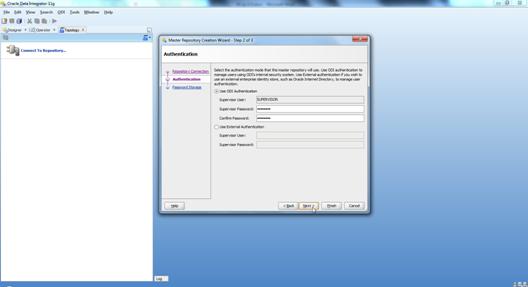

  4. Enter <supervisor password> and click Next.
    This password will be used in further installation steps, so keep a record of it.
    Figure 9-4 Authentication
    Surrounding text describes Figure 9-4 .

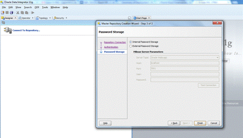

  5. Click Finish.
    Figure 9-5 Password Storage
    Surrounding text describes Figure 9-5 .

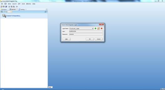

  1. Select the ODI Menu->Connect option to log in to the Master Repository in Oracle Data Integrator (ODI) Studio to create a Work Repository.

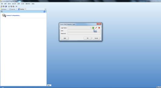

  2. Create Master Repository login credentials by selecting the + button from the Oracle Data Integrator Login dialog.
    Figure 9-6 Oracle Data Integrator Login
    Surrounding text describes Figure 9-6 .

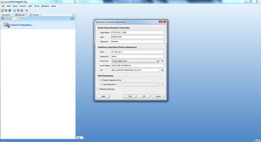

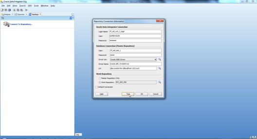

  3. Update the Repository Connection Information as below:
    1. Oracle Data Integrator Connection:
      • Login Name: <Login Name>
      • User: <Enter "SUPERVISOR" in this field>
      • Password: <supervisor password>
      See ODI documentation for information on users with the correct (supervisor level) permissions. The SUPERVISOR user is created by ODI and has the correct permissions by default.
    2. Database Connection (Master Repository):
      • Enter Master Repository database credentials for User and Password fields.
      • Select "Oracle JDBC Driver" from the drop-down list for Driver List field.
      • Enter Url (use the OdiMasterDataSource/ jdbcUrl entered in rfi-deployment-env-info.json file) field as shown below:
        jdbc:oracle:thin:@<host>:<port>:<sid>
    3. Work Repository:
      • Select the Master Repository Only option.
        Figure 9-7 Repository Connection Information
        Surrounding text describes Figure 9-7 .

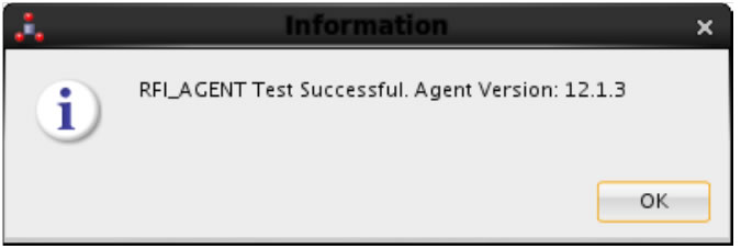

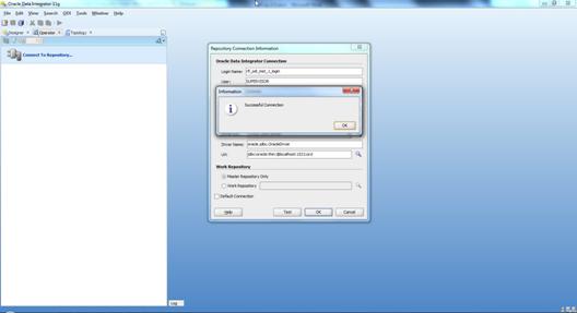

  4. Test your credentials information using the Test button. If you are successful then click OK.
    Figure 9-8 Test
    Surrounding text describes Figure 9-8 .

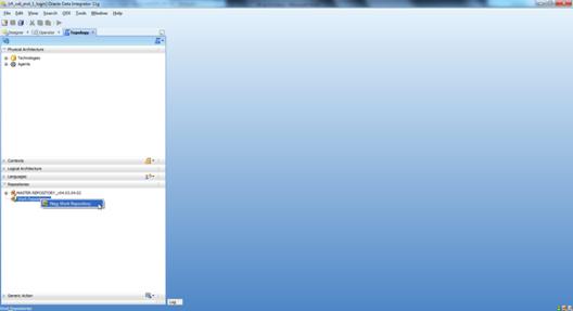

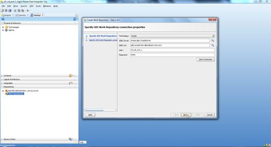

  6. From the Topology tab, select Repositories and then right-click on the Work Repositories. Select the New Work Repository option.
    Figure 9-10 Repositories
    Surrounding text describes Figure 9-10 .

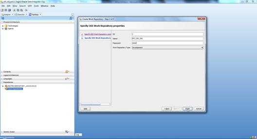

  7. Enter the work repository database credentials details.
  8. Test your credentials information using the Test button. If you are successful then click Next.
    Figure 9-11 Test
    Surrounding text describes Figure 9-11 .
  9. Update ODI Work Repository properties:
    1. Enter any ID other than 804 or 805 (For EBS integration) / 501 or 502 (For PeopleSoft Integration) in the Id field.
    2. Enter Name and Password (should be SUPERVISOR user and <supervisor password>) for work repository and click Finish.
      Figure 9-12 ODI Work Repository
      Surrounding text describes Figure 9-12 .

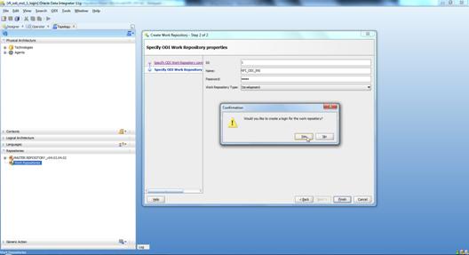

  10. Click Yes to create an ODI login for the work repository.
    Figure 9-13 Confirmation
    Surrounding text describes Figure 9-13 .

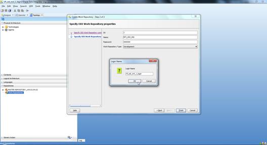

  11. Enter the ODI work repository login name in the dialog.
    Figure 9-14 Login Name
    Surrounding text describes Figure 9-14 .

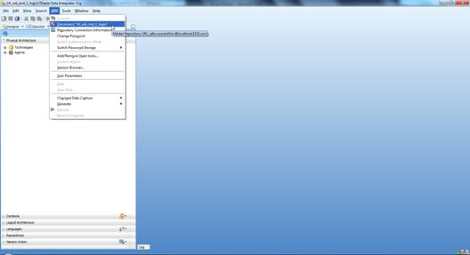

  12. Select the ODI Menu->Disconnect option to connect to the Work Repository.
    Figure 9-15 Disconnect
    Surrounding text describes Figure 9-15 .

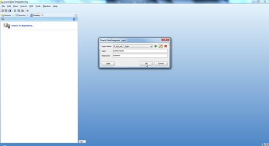

  13. Select the ODI Menu->Connect option.
    1. From the ODI Login popup, select Login Name from dropdown list (select the name you created in step7).
    2. Enter user as "SUPERVISOR".
    3. Enter <supervisor password>.
    4. Select the Edit option.
      Figure 9-16 Connect
      Surrounding text describes Figure 9-16 .

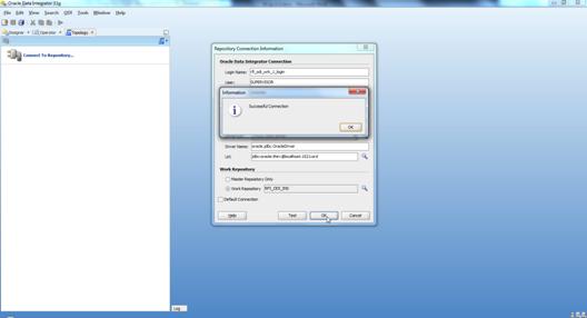

  15. Test your credentials information using the Test button. If you are successful then click OK.
    Figure 9-18 Test
    Surrounding text describes Figure 9-18 .

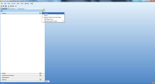

  1. Log in to the Work Repository in Oracle Data Integrator (ODI) Studio to import all the interfaces:

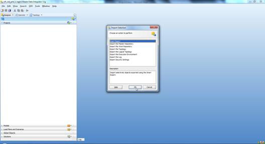

  2. Select the Import option from the Designer tab.
    Figure 9-20 Import
    Surrounding text describes Figure 9-20 .
  3. Select the Smart Import option on the Import Selection dialog and click OK.
    Figure 9-21 Smart Import
    Surrounding text describes Figure 9-21 .

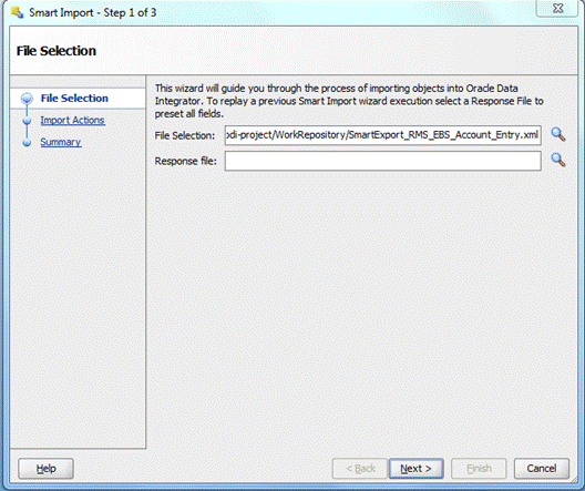

  4. If integration is with EBS, then
    Select SmartExport_RMS_EBS_Account_Entry.xml file in the File Selection Field and click Next. This file can be found in $INSTALL_DIR/retail-financial-integration-solution/etl-based-integration/retail-to-ebsfin-etl-flows/retail-to-ebsfin-odi-project/WorkRepository/.
    If integration is with PeopleSoft, then
    • Select SmartExport_RMS_PSFT_Account_Entry.xml file in the File Selection Field and click Next. This file can be found in $INSTALL_DIR/retail-financial-integration-solution/etl-based-integration/retail-to-psftfin-etl-flows/retail-to-psftfin-odi-project/WorkRepository/.
      Figure 9-22 Smart Import - Step 1 of 3
      Surrounding text describes Figure 9-22 .

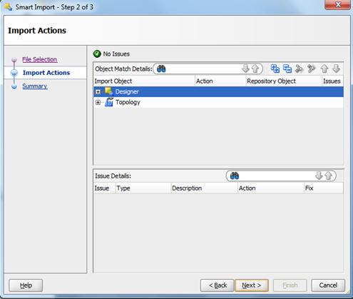

    Figure 9-23 Smart Import - Step 2 of 3
    Surrounding text describes Figure 9-23 .

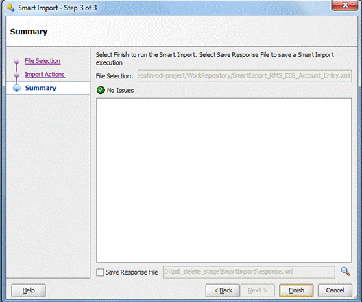

  6. Click Finish.
    Figure 9-24 Smart Import - Step 3 of 3
    Surrounding text describes Figure 9-24 .

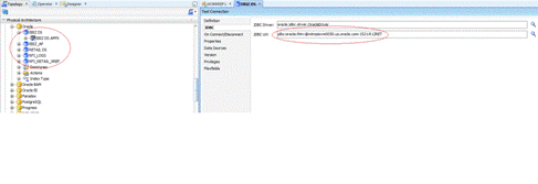

Update Connection Information
For EBS Integration:

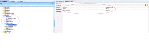

In Topology, under Physical Architecture, Technologies -> Oracle, update the Database Connection details in the Physical Server and Physical schema as shown in the table below.
Figure 9-25 Database Connection Details
Surrounding text describes Figure 9-25 .

  1. For EBIZ DS, EBIZ_AP, provide the E-Business Suite database connection.
  2. For RETAIL DS, provide the Retail database connection.
  3. For RFI_LOGS, RFI_RETAIL_XREF provide the ORFI Infrastructure database connection.
  4. Click Test Connection on the physical server to verify that the connection information is correct.
  5. In the physical schema, verify that the context (Global and RETL_TO_EBIZ) is mapped to the logical schemas as shown in the table below. If the mapping is missing, map the logical schemas as shown in the table below.
    Figure 9-26 Verify
    Surrounding text describes Figure 9-26 .

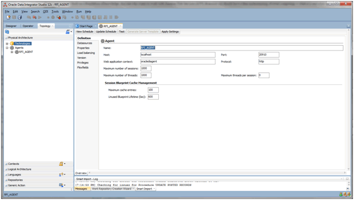

In ODI Topology, navigate to Physical Architecture -> Agents.
Make sure the RFI_AGENT is available and default to port 20910

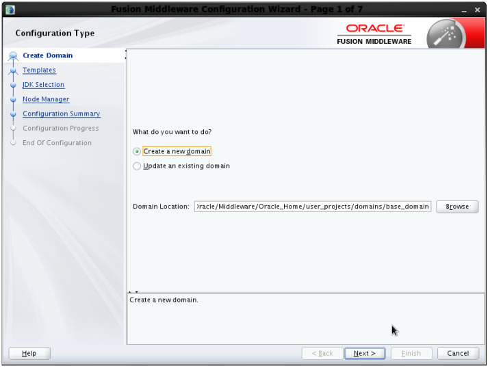

    The configuration wizard pops up. Select the "Create a new domain" option.
    Figure 9-28 Configuration Type Window
    Surrounding text describes Figure 9-28 .

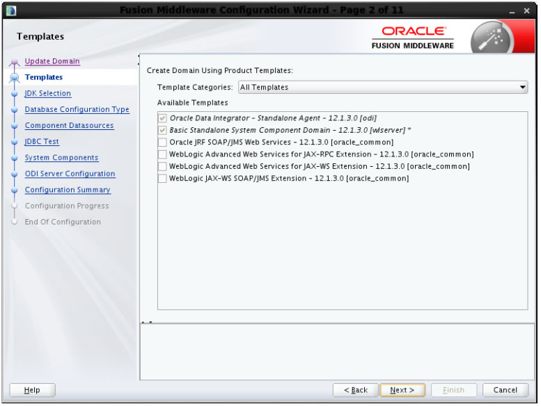

    Figure 9-29 Templates Window
    Surrounding text describes Figure 9-29 .
  3. Chose the first checkbox, Oracle Data Integrator-Standalone Agent -12.2.1.3.0.

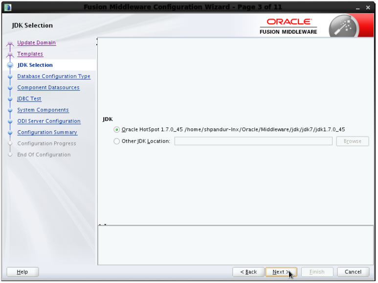

    Figure 9-30 JDK Selection Window
    Surrounding text describes Figure 9-30 .
  4. Chose the JDK path.

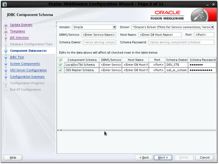

  5. Enter DBMS/Service information (not a database instance) example orcl.example.com and enter DB host name, port information.
    Figure 9-31 JDBC Component Schema Window
    Surrounding text describes Figure 9-31 .

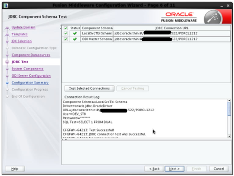

  6. Enter dev_stb schema hostname, service and port information and also password, this is the services related table that would be been created using RCU. Enter similar information for ODI master schema.
    Figure 9-32 JDBC Component Schema Test Window
    Surrounding text describes Figure 9-32 .

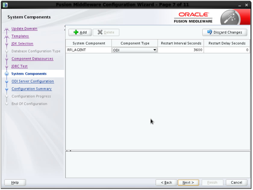

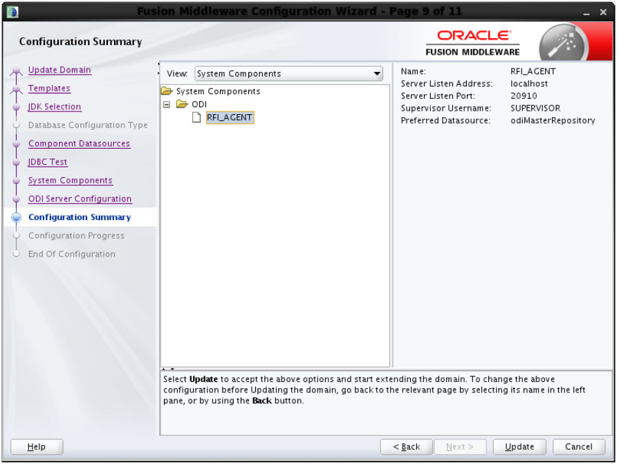

    Figure 9-33 System Components Window
    Surrounding text describes Figure 9-33 .

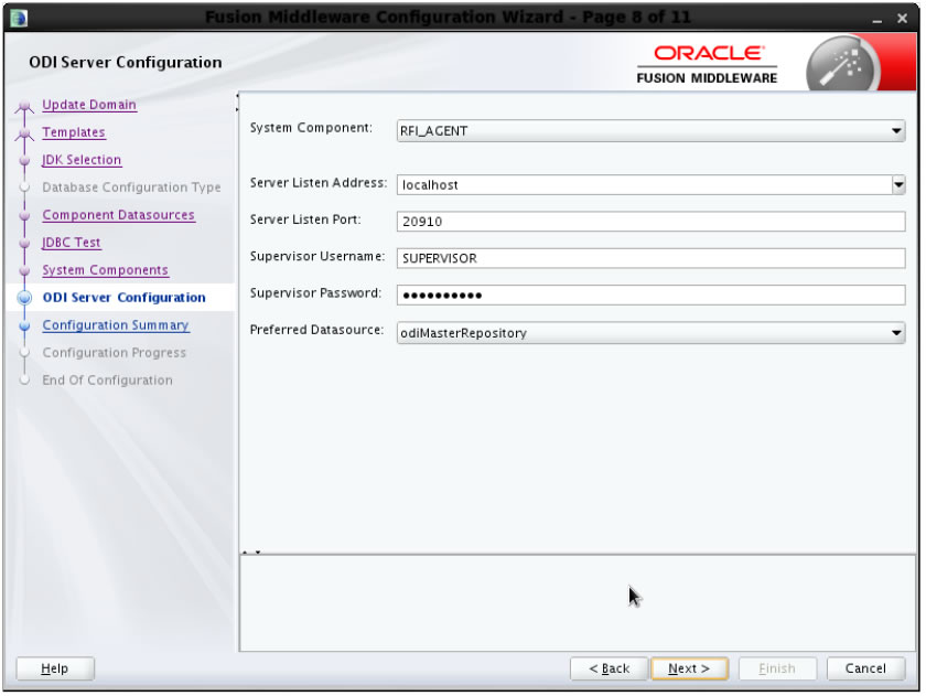

    Figure 9-34 ODI Server Configuration Window
    Surrounding text describes Figure 9-34 .
    Figure 9-35 Configuration Summary Window
    Surrounding text describes Figure 9-35 .
To start the RFI_AGENT agent
Navigate to location where you created the odi base domain, refer to first step.<Domain home>Oracle/Middleware/Oracle_Home/user_projects/domains/base_domain/bin and type.
agent.sh -NAME=RFI_AGENT -PORT=20910
You should see:
<date and time> NOTIFICATION ODI-1111 Agent RFI_AGENT started. Agent version: 12.2.1.3.0 - date. Port: 20910. JMX Port: 21910.
Do not close the window.

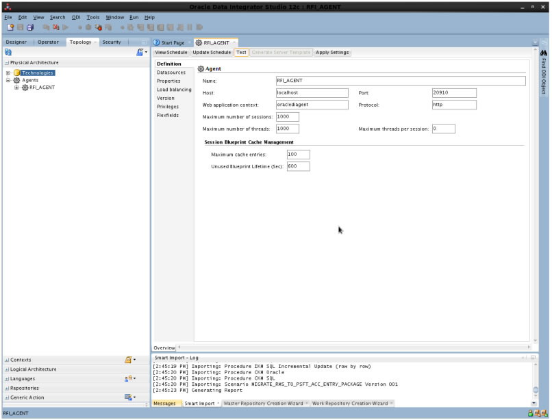

To test if the agent is successfully running:
Log into ODI with appropriate credentials and navigate to Topology tab. On the physical agent section, expand Agents, and click on RFI_AGENT. On the right pallet, click on 'Test' tab.
Figure 9-36 Test Tab
Surrounding text describes Figure 9-36 .
You should see this message.
Figure 9-37 Test Message
Surrounding text describes Figure 9-37 .

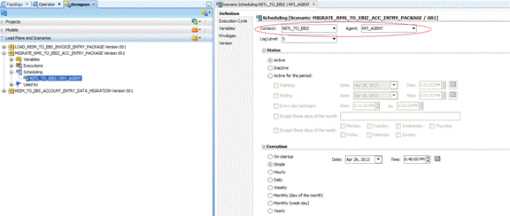

Generate Scheduler
  1. In ODI designer, navigate to Load Plans and Scenarios, and select scenario MIGRATE_RMS_TO_EBIZ_ACC_ENTRY_PACKAGE if integrating with EBS. While integrating with PeopleSoft then MIGRATE_RMS_TO_PSFT_ACC_ENTRY_PACKAGE
  2. Select Existing Scheduling. Make sure the context is set to RETL_TO_EBIZ and the agent is selected as RFI_AGENT
  3. You need to select an Execution option based on the ORFI requirement and then save the changes.
    Figure 9-38 Scheduling
    Surrounding text describes Figure 9-38 .
