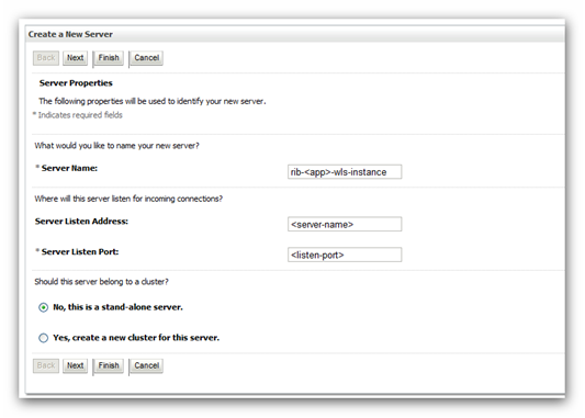

  1. Log in to the WebLogic administration console GUI (http://<host>:<port>/console) as administrator.
  2. Using the left side menu, navigate to Environment > Servers. Surrounding text describes new1.png.

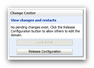

  3. Click Lock & Edit. Surrounding text describes new2.png.
  4. Click New.
  5. Enter the name, port, and listen address of the server instance to be created.
    For example:
    • Server Name: rib-<app>-server
    • Server Listen Address: <server-name>
    • Server Listen Port: <listen-port> Surrounding text describes new3.png.
  6. Click Next. Click Finish. Make sure you see this instance listed under Servers

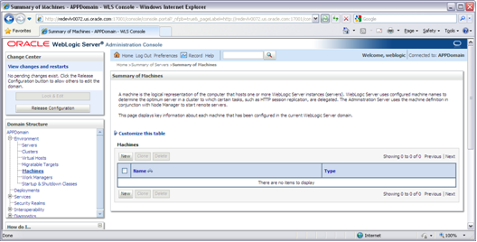

  1. Log in to the administration console.
  2. Click Lock & Edit and navigate to Environments> Machines.
    Surrounding text describes node1.png.

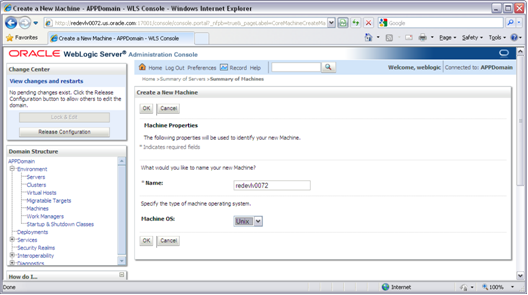

  3. Click New.
    Surrounding text describes node2.png.
  4. Set the following variables:
    • Name: Logical machine name
    • Machine OS: UNIX
  5. Click Next.

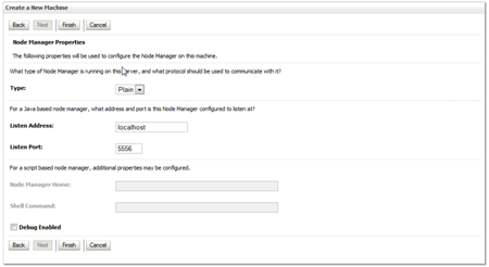

  6. Update the details below and click the Finish button.
    • Type: Plain
    • Listen Address: For example, ribhost.example.com
    • Listen Port: Default port (for example, 5556) or any available port
    Surrounding text describes create_newmachine.png.

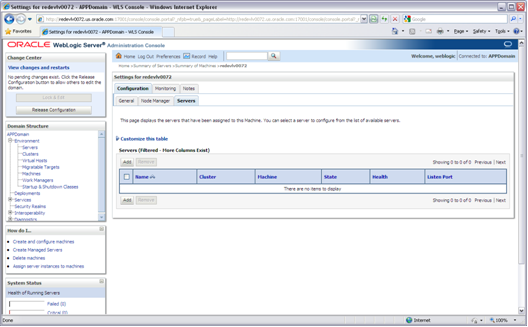

  8. Click Lock & Edit.
  9. Navigate to Environments > machines. Click on the machine name and select the Servers tab.
    Surrounding text describes node6.png.
  10. Add the managed servers that need to be configured with NodeManager. Save the changes.
  11. Click Add to repeat for additional servers.
