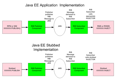

The javaee-api-stubs is an API simulator designed to act in the same manner as when the RIB is connected to the actual application, but at the same time, have means to process specific status and other parameters from a stubbed application. This set of tools is designed to emulate those applications exposing Java EE APIs to the RIB: SIM, RPM, AIP, and OMS.
Architecture and Design
Surrounding text describes image002.png.

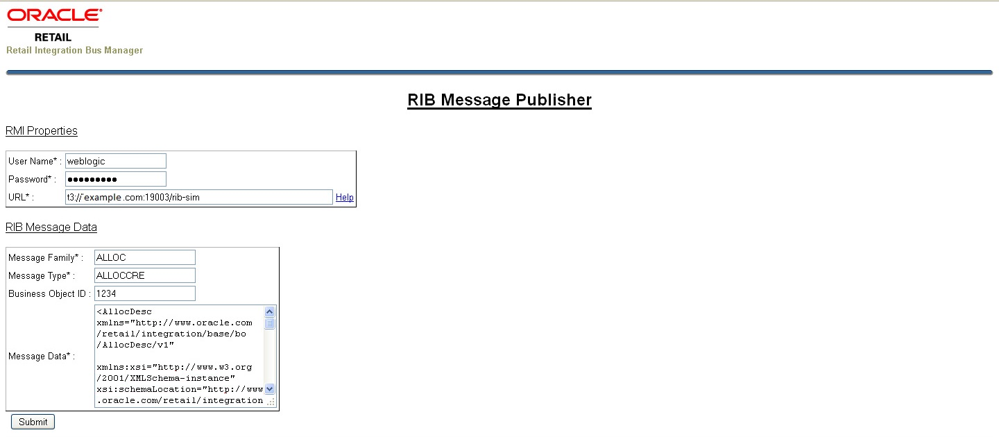

javaee-api-stubs application can be used to publish a message to the RIB integration environment.
Populate the following fields:
Table 2-4 RMI Properties
User Name
Mandatory Field
The user name used to connect to WebLogic server.
Password
Mandatory Field
The password used to connect to WebLogic server.
URL
Mandatory Field
t3://host:port/applicationName
Table 2-5 RIB Message Data
Message Family
Mandatory Field
The family of the message that is to be published.
Message Type
Mandatory Field
The message type of the message that is to be published.
Business Object ID
Optional
Numeric ID.
Message Data
Mandatory Field
Payload data.
The RIB app publishing adapter submits the message to be published.

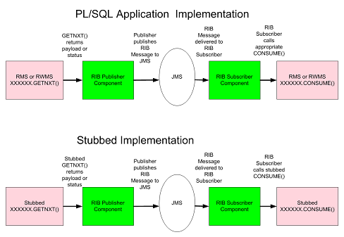

The plsql-api-stubs is an API simulator designed to acts in the same manner as when the RIB is connected to the actual application, but at the same time, have means to process specific status and other parameters from a "stubbed" application. This set of tools is designed to emulate those applications exposing PL/SQL APIs to the RIB: RMS, RFM, and RWMS.
Surrounding text describes image005.png.
The tool set contains three main subsystems:
  • A common set of PL/SQL packages, stored procedures and database tables. These are used by the other subsystems.
  • A thin API-specific set of packages and stored procedures that the RIB directly interfaces with. These interfaces map calls to the common subsystem to output parameters or statuses.
  • The Stub Admin and Setup Application. A set of simple application functions and a character based menu that allows installation and set up of specific behaviors for a specific API.
The Common Subsystem
The purpose of the common subsystem is to provide a standard means of implementing specific behavior by an API. The stubbed APIs simulate a real application by using the common subsystem which will be loaded during the installation through JDBC calls to the database. It is comprised of a group of tables, sequences and other database objects created for each stubbed API.
There is a set of tables and sequences created for each GETNXT procedure. These tables are generated with the OUT and IN/OUT parameters of the GETNXT procedure as the fields. The user is prompted to enter data into these tables when he is trying to test for a particular API.
For example:
If there is a GETNXT procedure in a package called RMSMFM_ORDER, then the common subsystem for this procedure would be a table RMSMFM_ORDER_GE_TBL and sequence called RMSMFM_ORDER_GE_SEQ created in the database.
For each PUB_RETRY Procedure in the API, a set of tables and sequences are created the same as GETNXT, except that the names of tables and sequences have PU instead of GE
For a CONSUME API, there is a table called RIB_CONSUME created with the O_STATUS_CODE, O_ERROR_MESSAGE and EXCEPTION_TO_THROW as the fields. If the user needs the CONSUME to throw a specific type of exception, then the exception can be uploaded into the RIB_CONSUME table, so that when the consume procedure is executed it throws the specified exception type.
The Thin API layer
The API subsystem consists of packages and stored procedures that have the exact same signature as those found within the real application. This layer queries the appropriate common subsystem tables, sequences and other database objects to get the appropriate out parameters. These are then mapped to the API specific parameters of the stubbed application API.
The implementation of the stubbed API is written as Java classes and loaded into the database during installation. The PL/SQL stubbed APIs are implemented in a way that these API internally call the Java functions present in the classes and the PL/SQL OUT parameters are then mapped with the Java return types.
So when the RIB calls the GETNXT stubbed API as it normally calls the GETNXT API of a real application, the stubbed API internally calls the Java class which uses the common subsystem tables to get messages as a CLOB, it then converts the CLOB to an Oracle Object and then maps it with the PL/SQL OUT parameters and returns.
