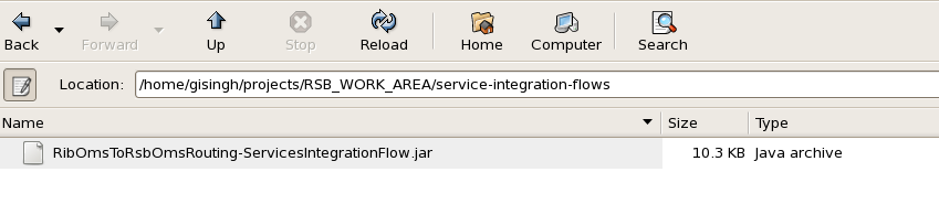

Copy the RibOmsToRsbOmsRouting-ServicesIntegrationFlow.jar to RSB_WORK_AREA/service-integration-flows folder. The directory structure looks like this:

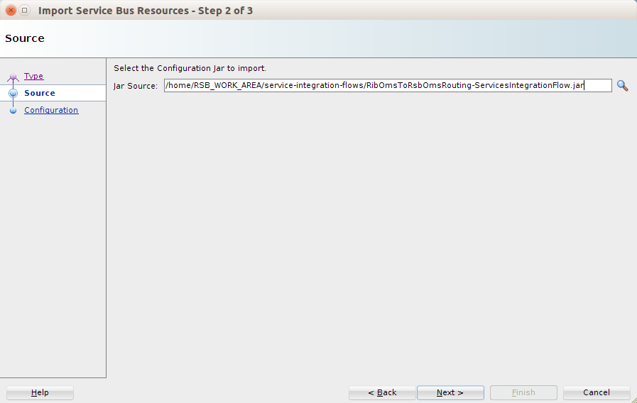

Now we need to import this jar in JDeveloper. To import the jar, select File > Import > Service Bus Resources.
Click Browse and select the jar file.

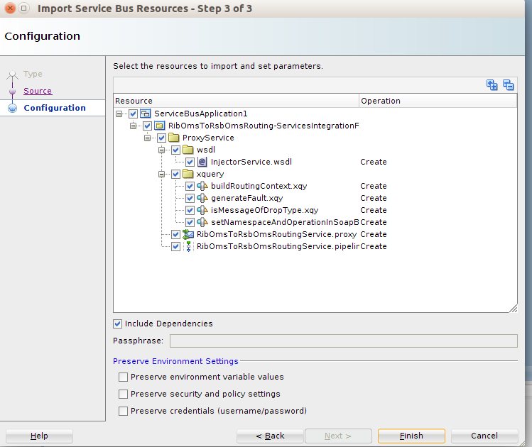

Click Next. It will show all the files available in the jar.

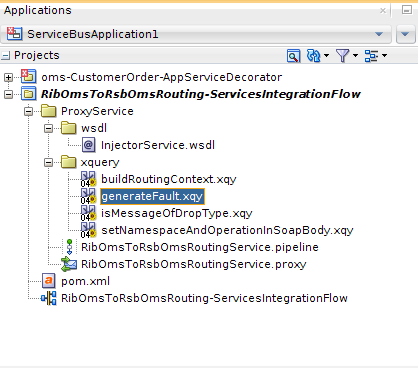

Click Finish. The jar is imported as an OSB project and the project structure looks like the following:

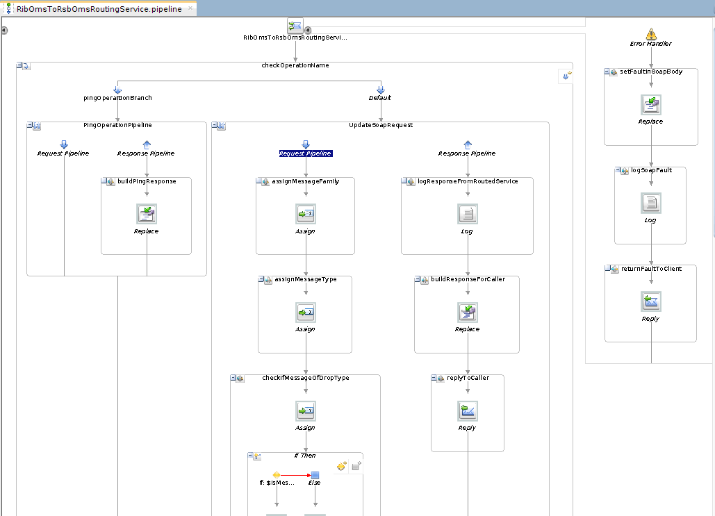

The following diagrams show the message flow in the proxy service of the routing project. The whole message flow does not fit in once screenshot, so the first picture shows message flow at a high-level; it shows all the pipelines that define the message flow.

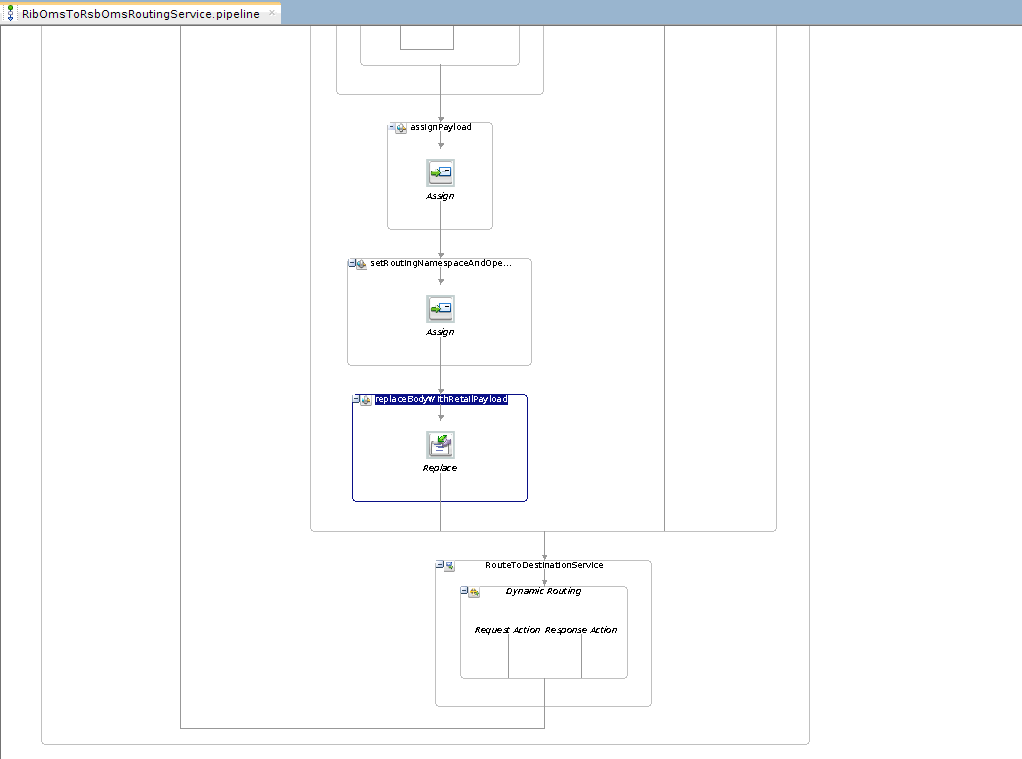

The next screenshot is of the remaining part of the updateSoapRequest pipeline-pair where most of the message processing takes place.
When RibOmsToRsbOmsRoutingService proxy service receives the request XML, it executes the message flow. The sequence of activities in the flow is explained below:
The Message flow has a conditional branch, which checks for operation name in the SOAP request.
The first condition is to check if operation invoked is ping. If operation name is ping, then the proxy service does not need to do further processing, it just builds a success response for ping method and returns the response to the client.
If operation name is not ping, then the message goes to a Pipeline Pair which is named as updateSoapRequest. In request flow of that pipeline pair, these are the things that take place:
Find the message family from the request and assign to a variable.
Find the message type from the request and assign to a variable.
Execute an xquery to check if the message needs to be dropped, that is, the proxy service should do nothing and return an appropriate response to the client. So if the message is of drop type, then it skips rest of the pipeline and returns an appropriate response to the client. Table 5-1 shows the combination of message family and message type which are dropped by the proxy service.
If the message is not of drop type, then it extracts the payload from the request and saves it to a variable.
Execute an xquery to set namespace and operation name in the outgoing request for the target decorator service.
Build a new SOAP body with the payload that was stored in a variable.
The proxy service uses dynamic routing to route the request to target decorator service. The dynamic routing action is based on an xquery file. This xquery builds route message context which is used by dynamic routing to route to the appropriate service. The table 5-2 shows the mappings between message family, message type which are routed to decorator service URIs.
Message is routed to the proxy service of the target decorator project.
When the target decorator returns the response, then the response pipeline is executed. In the response pipeline, the response returned from decorator is logged. Finally a string with success response is returned to the proxy service client.
If an error occurs in the RibOmsToRsbOmsRoutingService message flow, then the Service Error handler pipeline is executed. In this pipeline, an XQuery is used to build appropriate fault message. The fault is returned to the client with failure status.
