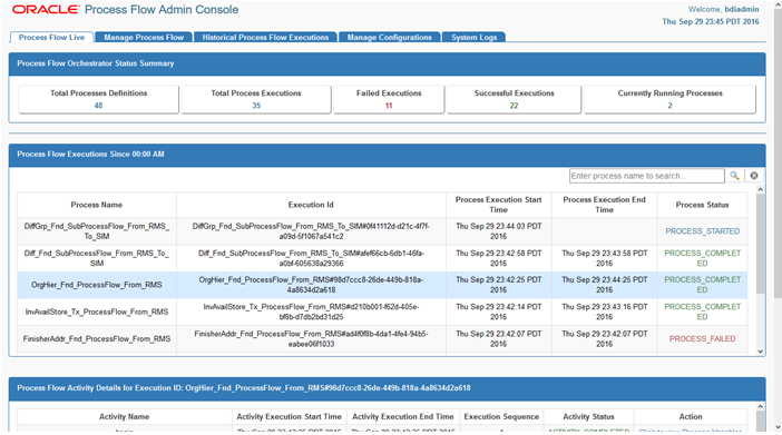

The Process Flow Live tab shows the details of the currently running processes. The first section shows the summary of all processes running in the system. The next section shows the list of all processes running since midnight. The last section shows the activity details of the selected process. Users also have the option to search for a process by its name.
Build version and date is displayed on the info icon when a user selects the same. The icon is on the extreme right top corner of the page.

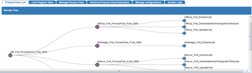

Execution Trace Graph

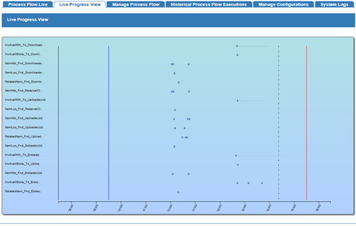

The Execution Trace Graph is also part of Process Flow Live tab. Execution trace graph shows the sub processes and jobs called from a process. The arrows show the relationship between the caller and the callee. The circular nodes of the graph represent the process or the job that was invoked. On hovering over the node, the details of the execution like name of the process or job, invocation time, status etc. are displayed.
Live progress graph shows the batch status for a time window. Here are the details of the graph.
It shows all the jobs from all the JobAdmins configured in the process flow.
Currently the time window is 10 hours before the current time and one hour ahead of the current time.
Current time is the dotted line axis. The batch start time is the blue axis and batch end time is the red axis
The graph will refresh itself every second. So the axis, jobs and all related information will update
The time window will move as the current time axis nears the end of the graph
Each job is represented by an arrow. The color of the arrow will be red (errored jobs), blue (running jobs) or green (completed jobs). The length of the arrow will be same as the time taken for the job.
Same jobs will appear in the same line.

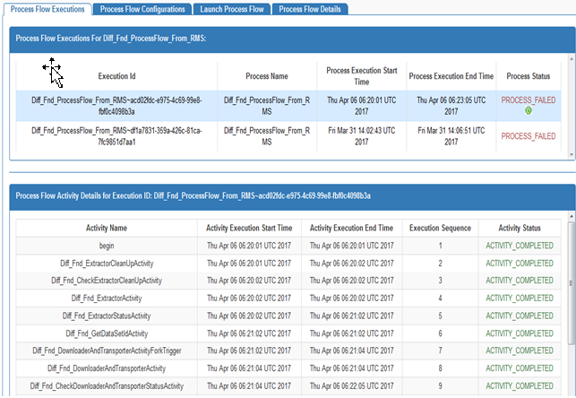

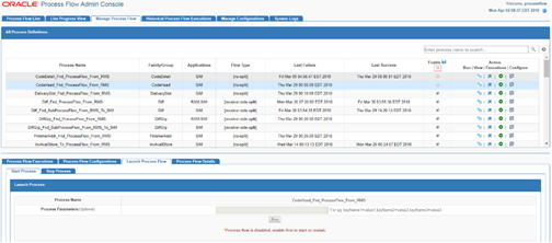

The Manage Process Flow tab allows the user to Start a process flow, Restart a failed process flow, enable or disable the process flow, View/Edit a process flow, Stop a running process flow, List the executions instances of a process flow. User can search process details on this tab. A failed process flow instance can be restarted only if it is the latest failed instance and there are no successful executions after that. A process flow can be edited only by a user with Admin privileges. By default all the process flows are enabled. Select the process flow row and check/uncheck the check box of each process and click on save image button in enable column. Only enabled process flows can be launched/restarted. The Run/Restart button is disabled for the disabled process flows. There is an option to enable or disable all the process flows at a time by clicking on checkbox, present in the enable column, highlighted in red and click on save image button.
 Note: Only enabled processes can be launched or restarted. The Run or Restart button is disabled for the disabled processes. |
This tab shows the executions of the selected process. It can be used to restart the failed executions of a process. The Restart button is available only for restartable executions in the status column. When the user clicks the restart button it is redirected to the process launch tab.

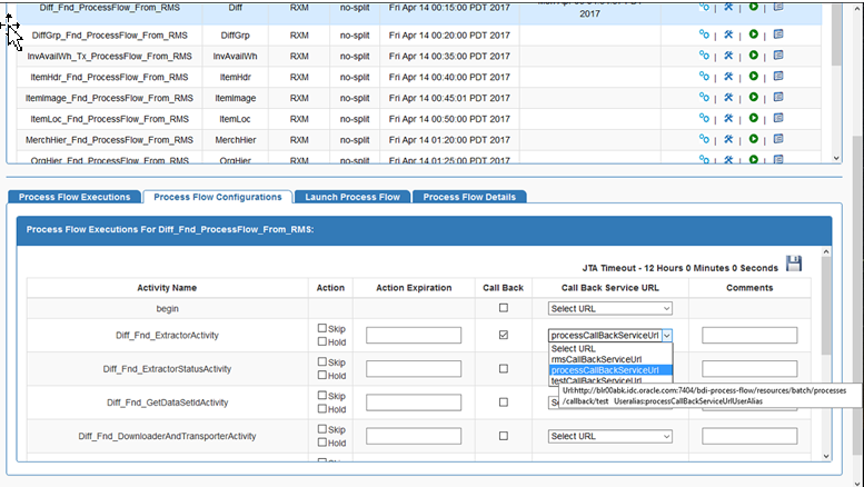

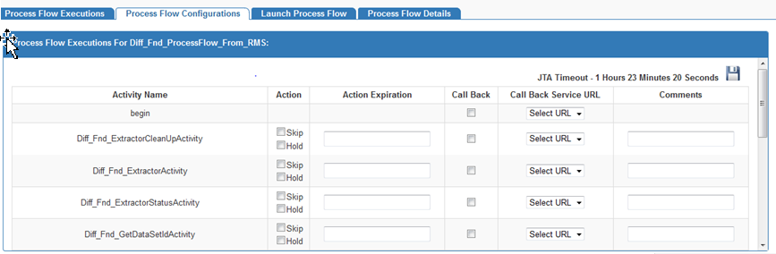

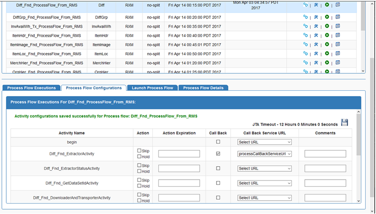

This tab provides various features for activity configurations for the selected process like Skip, Hold, Callback. Admin and operator have permissions to update activity configurations.

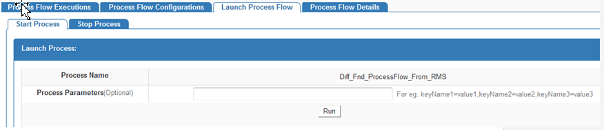

This tab can be used to start or stop process the selected process. Start Process subtab used to launch Process. Only enabled processes can be launched. The run button is disabled for the disabled processes. Process Parameters is an optional input from the user to launch the process. Process parameter acts as query parameter and refers to a key value pair. Multiple process parameters can be entered in comma separated value format. Stop Process subtab is used to Stop a process execution. Stop will be a graceful stop, which means current executing activity will be first completed and then process will be stopped. If activity is not running, Stop will not bring any action.

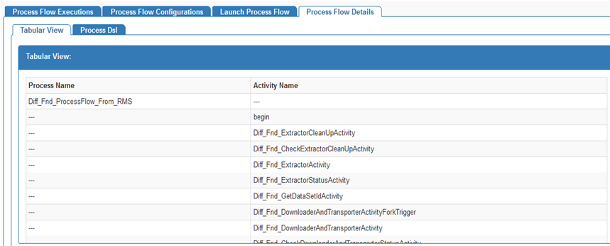

This tab shows process definition in form of a DSL file configured during deployment of the selected process. The Admin user also has the option to modify process DSL. Once updated the process DSL from the UI, changes will take into effect into the BDI_PROCESS_DEFINITION table and no need for process redeployment.

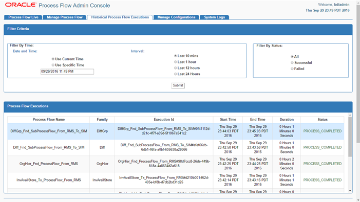

The Historical Process Flow Execution tab allows the user to look at the history of process flow executions. The user can specify a date, a time interval and process status. The application will list all the process flow executions matching the criteria. The User can select any of the flow to see the activities details of that execution instance. The page also provides the option to view the before and after values of all process variables for each activity.

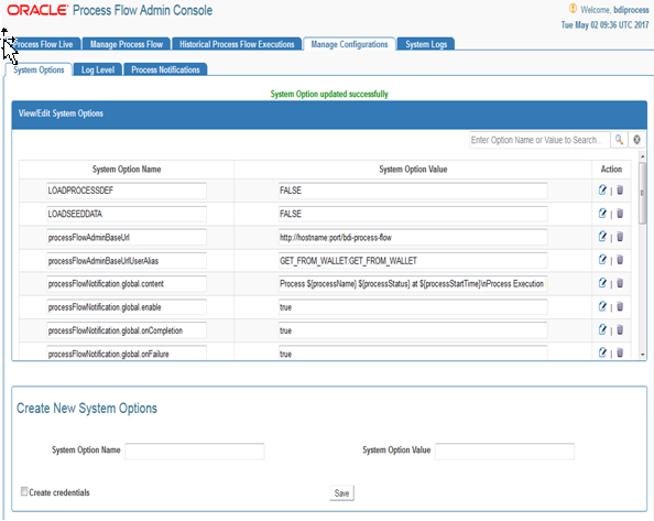

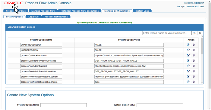

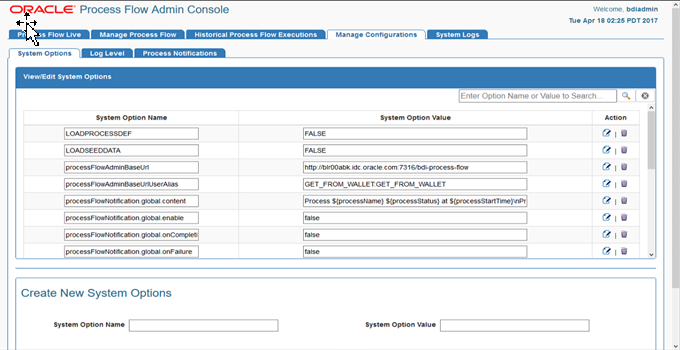

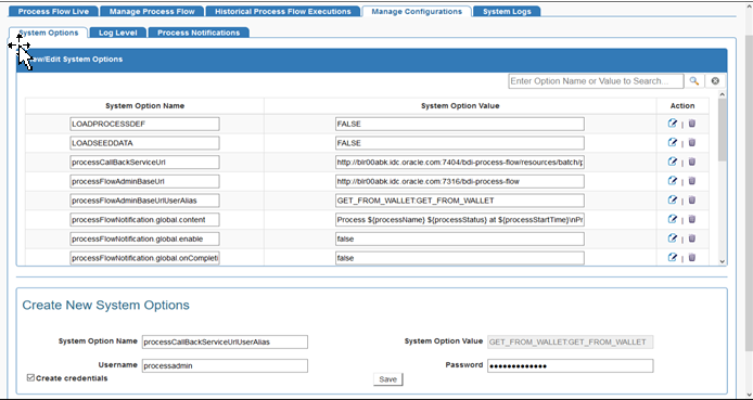

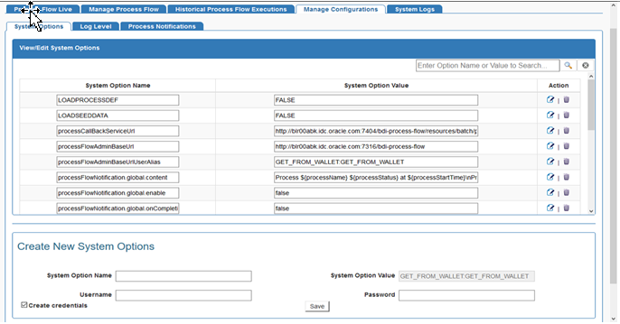

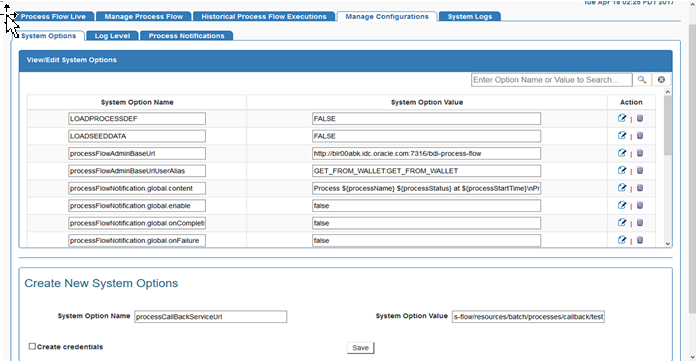

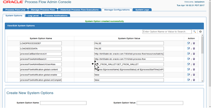

The Manage Configurations tab allows users to view, edit and create system options, configure process notifications and log levels. This page displays the list of system options of the application. The User can modify the value of the existing system options, create new system options and delete the existing system options. The User needs admin privileges for editing and creating system options. The Search option based on the system options name and value is also provided on this page.

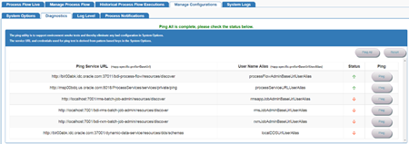

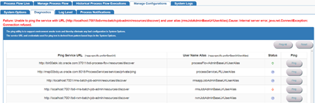

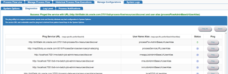

Ping Feature: The ping utility is to support environment smoke tests and thereby eliminate any bad configuration in System Options.
The service URL and credentials used for ping test is derived from pattern based keys in the System Options.
The default Ping Service URL is combination of App specific BaseUrl + Discover service as suffix. POAM ping service URL is combination of BaseUrl + Default ping service as prefix (services/private/ping)
User can ping individual app URL and see the success/failure message on the TOP. Also, there will be a status column which shows UP Arrow image for success and DOWN arrow image for failure.
User can also use Ping All feature to ping all the URLs at one time and the responses will be shown on the status column against each URL.

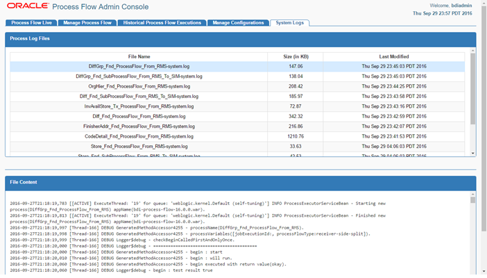

The System Logs tab shows all the log files created by the process flow execution. Clicking on the View icon will show the log file contents in the screen.
The Process Flow notification options can be set in the System Options of the Process Flow. This can be done either at deployment time (through seed data) or at runtime (through the Manage Configuration tab of the Process Flow Monitoring application)
The options available for notification are:
processFlowNotification.<scope>.enable - value must be True or false. This is for global enabling or disabling of process flow notification.
processFlowNotification.<scope>.onStart - value must be True or false. True means notification will be sent at the start of the process.
processFlowNotification.<scope>.onRestart - value must be True or false. True means notification will be sent at the restart of the process.
processFlowNotification.<scope>.onCompletion - value must be True or false. True means notification will be sent at the completion of the process.
processFlowNotification.<scope>.onFailure - value must be True or false. True means notification will be sent when the process fails.
processFlowNotification.<scope>.recipients - list of recipient email ids
processFlowNotification.<scope>.subject – Template of the email subject line
processFlowNotification.<scope>.content – template of email content
where <scope> value is global or the Process Name.
If Process Name is specified, the global notification option is ignored for that process. For Subject and Content, if nothing is specified either at the global or process scope, an internal default format is used.
If Mail Session is not setup in WebLogic, notifications will not be sent. If processFlowNotification.<scope>.recipients is not set, the value from mail.to property in the WebLogic Mail Session is used.
For Subject and Content template, following variables can be used. The variable is case sensitive and the format must match exactly as given below. For multi-line content, \n can be used to indicate line breaks.
${processUrl}
${processName}
${processExecutionId}
${processStartTime}
${processEndTime}
${processStatus}

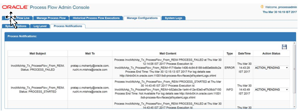

All process notifications are persisted to the BDI_EMAIL_NOTIFICATION table. There is a subtab Process Notifications added in Manage Configurations tab which displays all the notifications.
One notification icon appears right top corner of the screen adjacent to the user if there is any notification in PENDING status. User will be navigated to the Process Notifications subtab by clicking on the image.
User can modify the status to COMPLETED after going through the notification and click on save button so that next time it doesn't appear on the screen.

To start a bdi process flow user has to make a REST service call to URL (http://<host>:<port>/bdi-process-flow/resources/batch/processes/operator/<processName> ) . The call must be a POST call to the URL.
The process flow start call accepts http query parameters. The format of the query parameters are as follows:
http://localhost:7001/bdi-process-flow/resources/batch/processes/<ProcessName>?processParameters=callerId=<value1>,correlationId=<value2>,callBackServiceDataDetail.<name1>=<value3>,callBackServiceDataDetail.<name2>=<value4>
Spaces are not allowed in query parameters and must be separated by commas.
Example: http://localhost:7001/bdi-process-flow/resources/batch/processes/Abc_Process?processParameters=callerId=123,correlationId=abc,callBackServiceDataDetail.def=xyz,callBackServiceDataDetail.abc=123

Setup the callback URL in processflow system options. To configure a callback URL you should add system options like <serviceName>CallbackServiceUrl, for eg., processCallbackServiceUrl.
In Process Flow admin console, navigate to Manage Configurations tab and System Options sub-tab.
Scroll down to Create New System Options, enter System Option Name and System Option Value. Url should be a valid ReST Service.
Click Save.
Setup the callback URL credential alias in process flow. To add callback URL credential alias you should add credential alias like <serviceName>CallbackServiceUrlUserAlias, for eg., processCallbackServiceUrlUserAlias.
In the Create New System Options section, select Create Credentials checkbox.
Enter System Option Name, Username and Password for the URL provided in the previous step. If the System Option Name for the URL is processCallbackServiceUrl then System option name for credential should be processCallbackServiceUrlUserAlias.
Click Save.
 Note: Credentials created through UI are available after server restart, but after redeployment of the application credentials have to be created again. |
Navigate to Manage Process Flow tab and select process flow, go to Process Flow Configurations sub-tab.
Select Callback checkbox for the activities you want callback to be enabled. Select Callback URL from drop down list.
Click Save.

REST end point to get process execution trace
http://<host>:<port>/bdi-process-flow/resources/telemetry/processes/execution-trace/{ProcessExectionId}
Sample Output:

        <failed-executions-count>7</failed-executions-count>
        <process>
            <name>DiffGrp_Fnd_ProcessFlow_From_RMS</name>
            <slowest-run-duration>0.0</slowest-run-duration>
            <fastest-run-duration>120.0</fastest-run-duration>
            <avg-run-duration>60.2315</avg-run-duration>
            <executions>
                <exceution-count>1</exceution-count>
                <success-count>0</success-count>
                <failure-count>1</failure-count>
                <execution>
                    <execution-id>
DiffGrp_Fnd_ProcessFlow_From_RMS~650dba75-b632-42ea-963b-802c560d0c6b
</execution-id>
                    <status>PROCESS_FAILED</status>
                    <start-time>2017-05-17T14:39:32.489-06:00</start-time>
                    <end-time>2017-05-17T14:39:33.535-06:00</end-time>
                    <activity-exe>
                        <activity-exe-id>begin~2ac2bc4d-6233-41ac-a134-5fb73ebba275</activity-exe-id>
                        <name>begin</name>
                        <duration>0.0</duration>
                        <status>ACTIVITY_COMPLETED</status>
                    </activity-exe>
                    <activity-exe>
                        <activity-exe-id>
DiffGrp_Fnd_ExtractorActivity~035b6e78-411e-4868-b441-f2e79a3dba61
</activity-exe-id>
                        <name>DiffGrp_Fnd_ExtractorActivity</name>
                        <status>ACTIVITY_SKIPPED</status>
                    </activity-exe>
                    <activity-exe>
                        <activity-exe-id>
DiffGrp_Fnd_ExtractorStatusActivity~7d92a1c1-721a-416d-86ac-c412f9e49982
</activity-exe-id>
                        <name>DiffGrp_Fnd_ExtractorStatusActivity</name>
                    </activity-exe>
                    <activity-exe>
                        <activity-exe-id>
DiffGrp_Fnd_GetDataSetIdActivity~423d19e3-8c9d-44b2-93b9-183f41cd0840
</activity-exe-id>
                        <name>DiffGrp_Fnd_GetDataSetIdActivity</name>
                    </activity-exe>
                    <activity-exe>
                        <activity-exe-id>
DiffGrp_Fnd_DownloaderAndTransporterActivity~70bac2cb-c414-4be8-a5ab-0ef21fd2fc4d
</activity-exe-id>
                        <name>DiffGrp_Fnd_DownloaderAndTransporterActivity</name>
                        <status>ACTIVITY_FAILED</status>
                    </activity-exe>
                    <activity-exe>
                        <activity-exe-id>end~5c07a938-864b-4156-bab7-70b96bcb2d74</activity-exe-id>
                        <name>end</name>
                    </activity-exe>
                </execution>
            </executions>
        </process>
    </process-server-runtime-info>
</process-runtime-monitoring-info>
The Process Flow Application uses basic authentication to access the system. The user must belong to the BdiProcessAdminGroup or BdiProcessOperatorGroup or BdiProcessMonitorGroup to use the process flow REST services and process flow admin application.
There are three authorization roles designed for process flow application; Admin Role, Operator Role and Monitor Role. The Admin role has permissions to use all the functions provided by the process flow application. The Operator Role has limited access compared to Admin. The Monitor role has the least access permissions from all roles, as identified in the table below.
| Service/Action | Monitor Role | Operator Role | Admin Role |
| Update Process DSL | No | No | Yes |
| Start/Restart Process | No | Yes | Yes |
| All other services | Yes | Yes | Yes |
| Skip/Hold/Release | No | Yes | Yes |

| BDI_ACTIVITY_DYNAMIC_CONFIG | This table stores the user runtime choices like SKIP, HOLD etc at activity level |
| BDI_SYSTEM_OPTIONS | This table has all the system level information like URLs, credential aliases etc. |

Redeployment loads seed data depending on the LOADSEEDDATA and LOADPROCESSDEF flag values.
Before redeployment make sure for every install/upgrade one needs to look at /available_process_flow_options/rms_enterprise-sender_side_split_flows i.e. /bdi-process-home/setup-data/dsl//available_process_flow_options/rms_enterprise-sender_side_split_flows, to ensure they have the correct set of flows for that installation, each release would bring in functional changes and flows files define the primary functional definition of a BDI integration flow.

Configure the appsInScope system options in process flow configuration file.

| LOADSEEDDATA | LOADPROCESSDEF | Behavior |
 TRUE  |
 TRUE  |
 Loads both seed data and process DSLs  |
 TRUE  |
 FALSE  |
 Loads seed data only  |
 FALSE  |
 TRUE  |
 Loads process DSLs only  |
 FALSE  |
 FALSE  |
 Does not load seed data and process DSLs  |
