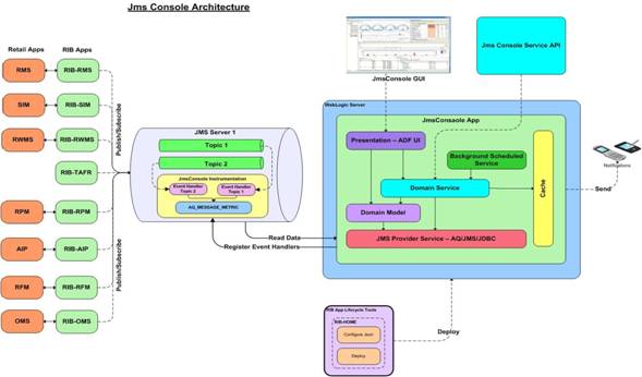

The following diagram describes the console architecture.
The AQ JMS that the application is monitoring is configured as a JDBC data source in the application server. The application dynamically discovers the topics and subscribers configured in the AQ. The application interfaces with the AQ JMS using PL/SQL API's provided by the AQ and uses instrumentation techniques to collect statistics using PL/SQL procedures.
Monitoring data is stored in the same AQ schema that the application is configured to monitor and manage. The PL/SQL package JMS_MONITORING_AGENT is responsible for providing instrumentation hooks and data sourcing capabilities. Monitoring data is stored in the AQ_MESSAGE_METRIC table. The following the table structure definition of the AQ_MESSAGE_METRIC table:
